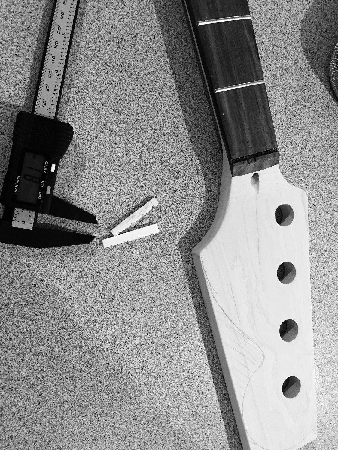

I got a bone nut cut and shaped from a blank today.
Attachment 19449
final shaping after strings are added.
I am hoping to cut the headstock this weekend too :)

What headstock shape do you have in mind Andy?
Funny you should mention the pups! I'm going to wind my own! (Eventually)
https://uploads.tapatalk-cdn.com/201...3fa1c06209.jpg
I'm toying with the fender style headstock shape at the moment kick
