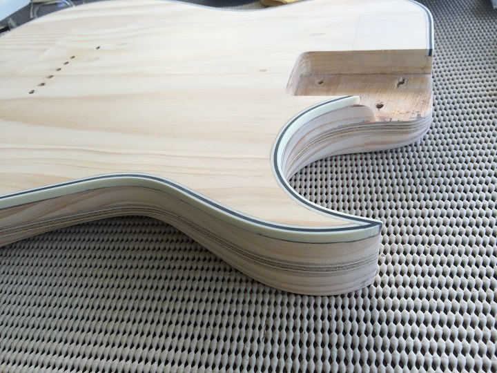

Next job was to drill the string-through holes. I am finding that although I am using good quality bits I am getting a fair amount of tear out. I think that using a hand drill tends to tear the wood rather than cut it. But I am not too concerned as the tear outs on the top will be covered by the bridge and at the back the string ferrules will cover most of the mess.
Attachment 11838

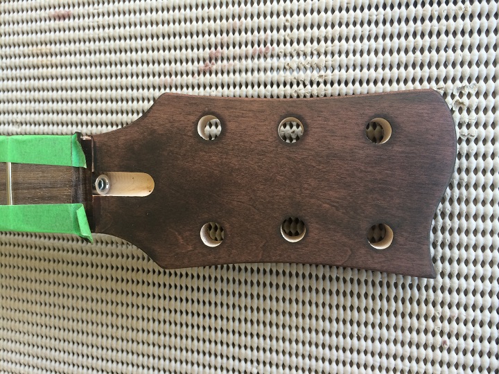

Then on to drilling out the recesses for the neck screw ferrules.
Attachment 11839
