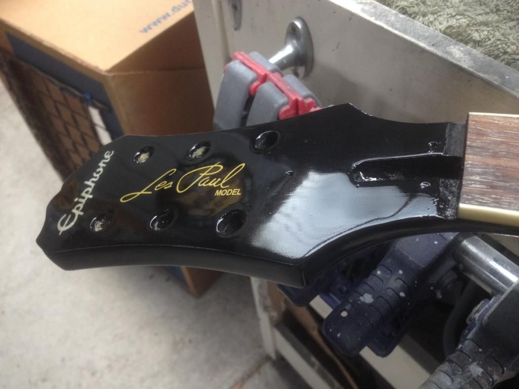

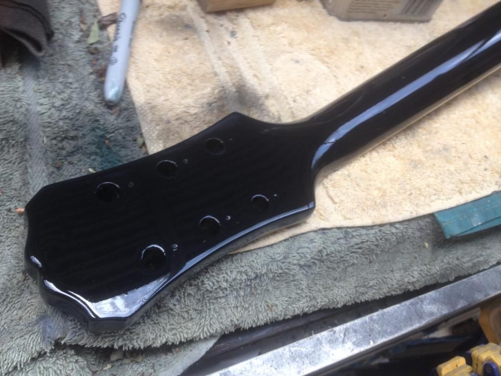

Repair nearly complete:
http://i271.photobucket.com/albums/j...e%20LP/011.jpg
http://i271.photobucket.com/albums/j...20LP/002-3.jpg

Thanks mate, the poly is still wet in these pics, but, it's looking OK.
nice, so roughly how many coats of wipe on poly to get to this level ?
It has blended in nicely to the existing clear
Thanks.
Didnt count to be honest - several is my best guess... about 10 or so
The entire neck was rubbed back with 1500 and I poly wiped the lot. No reactions and didnt have a join or actual blending to worry about
nice one Stan, so the logo did you have to put new logos on ?
Looks like the Epiphone is an inlay
Epiphone is an inlay, and yes, the logos are the originals.
I rubbed back the whole headstock with 1500 and I taped over the logos leaving a bit of a gap under neath, towards the truss rod cover and painted up to my tape point.
Where the two blacks met I tried to keep it as thin as I could , so that there would be no ridge, and sanded with 2000 to blend.
The blend line is through the two tuner holes closest to the nut. That way, if it is visible (and it is a bit at the correct angle in the right light), then the tuners and truss rod cover should cover most of it.
Most of the clear on the face of the headstock is the original, and gentle rubbing back hasn't completely gone through or affected anything underneath.
When I do the front, I'll just poly wipe the lot, like the reverse and neck, and it should all look like one (I hope...)
