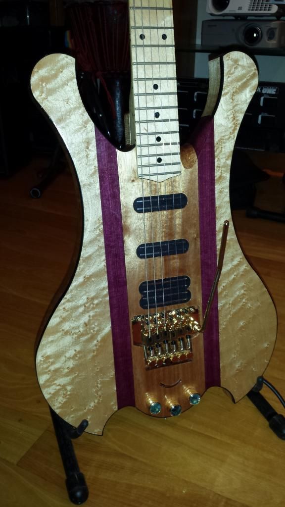

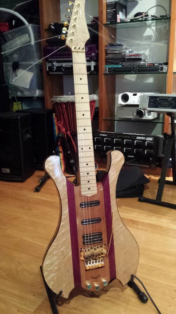

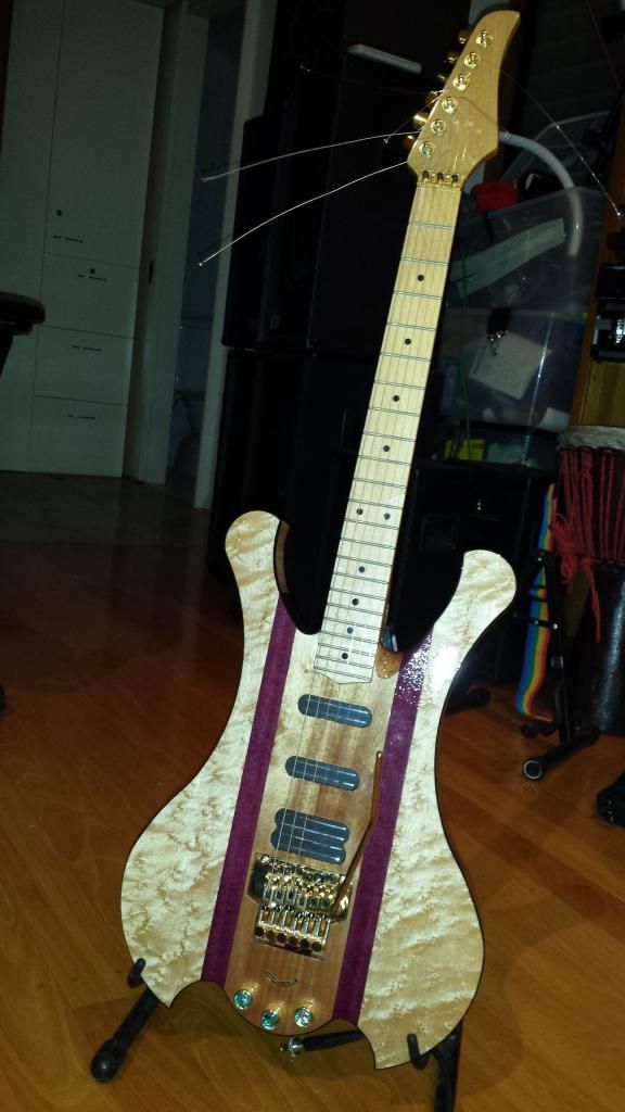

All strung out ! whoo hoo! sounds great so far..now to finish off the back plates and decide on full floating with 9's or rigid with 10's i prefer 9's and full floating but dont have a 10's with rigid so we see...

that is superb VH, a quality build, interesting and it just looks cool
That's it for you! I can't see any reason to make or own another guitar, sell it now and you can continue to make more, let me just give you my mailing address...
Thanx...

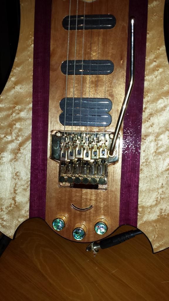

the next one is gonna be a corker! I hope! hehe these things sure test your skills or prove the lack thereof, so hey onwards and upwards I say, bring on the challenges ...not a lot to do to finish this one ...except move the whole bridge forward 5mm so it can set the internation!! damn! I dont like doing that but at least the cnc will be accurate and quick also need to drop the pocket another 3 mm or??? tilt the neck so I can speed up the neck..its a good strummer but lacks the low profile for fast string transitions, The aftermarket LowFrofile FL dont have any setup data so have to do it on what I can find on the net and this one didnt hit the spot in terms of correct scale.. I did measure the scale 100% but obviously they bridge design put the internation points a little aft of the correct spot so needs moving, have another one so now have those numbers...

Should be a real beauty once you have dialled in the setup.
sounds and looks awesome well done Haydn, hope you can get the intonation sorted
