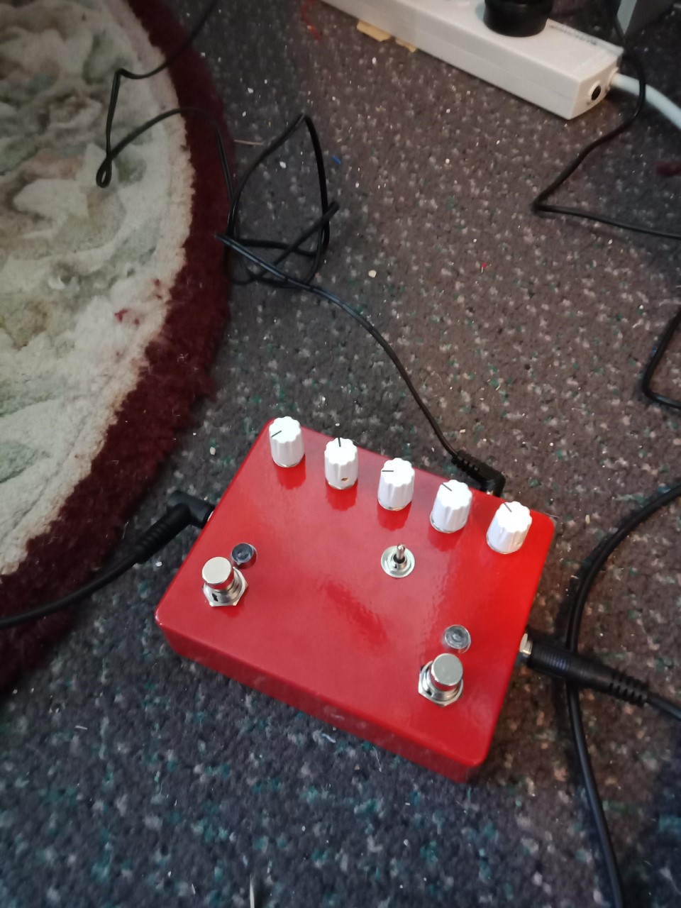

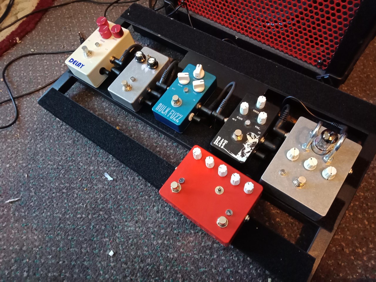

Here are some pics. The More Heavy and notch selections are fantastic - very doom

Awesome! Is that a 1590BB ? Looking forward to a sound clip when you have a chance
Yeah, 1590BB. I've seen some people managed to get theirs in with the pedal oriented the other way, but this way gave me a bit more wriggle room.
I'll try to do a demo this afternoon - it's a bit crazy at work this week with student return imminent, so will have to see how I go!
Crazy fuzz is not my cup of tea, but it looks good. I like the u-bolt valve guards on the valvecaster. And did you build the rat pedal? I quite like the sound of a Rat for the < 1% of the time that I want a distortion. I breadboarded one earlier this year but haven't committed to a permanent build. Might breadboard the Red Llama and see how that goes
Yeah, I made the rat. I made all the pedals on the board, which is kind of nice. I need a good loop pedal though, which isn't something I can DIY.
I use the rat all the time, ha ha ha. It's probably my most used pedal, but I have been looking for some more doom level distortion.
The U-bolts worked out great. I can still fit the shield, but I like being able to see the tube. And now it's on the board it's much more secure. Both my uncle and brother have had a play around with the Valvecaster and rated it, so I might make two more for their birthdays later in the year.

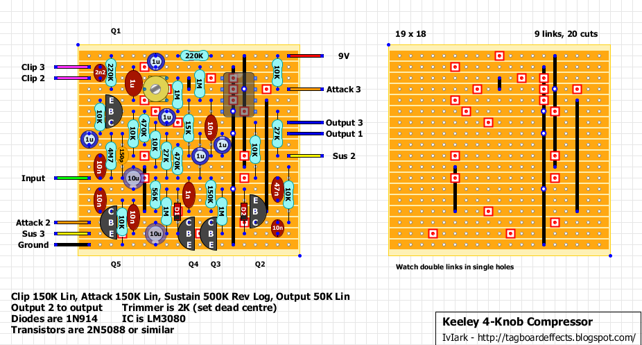

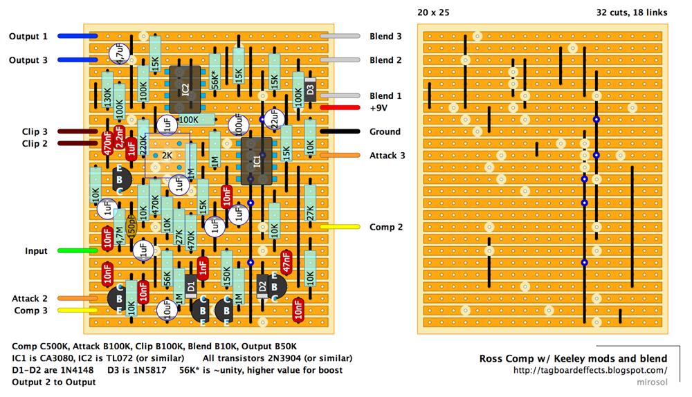

I've also decided I need a compressor, so think I'll try one or both of these:
Keeley 4-knob compressor

5-knob compressor
Attachment 36554
I really like my orange squeezer, but nothing beats the adjustability of the Ross style compressor.

The more transparent Ross-style have their place too, so I am super interested to see how a stripboard build of one goes.
