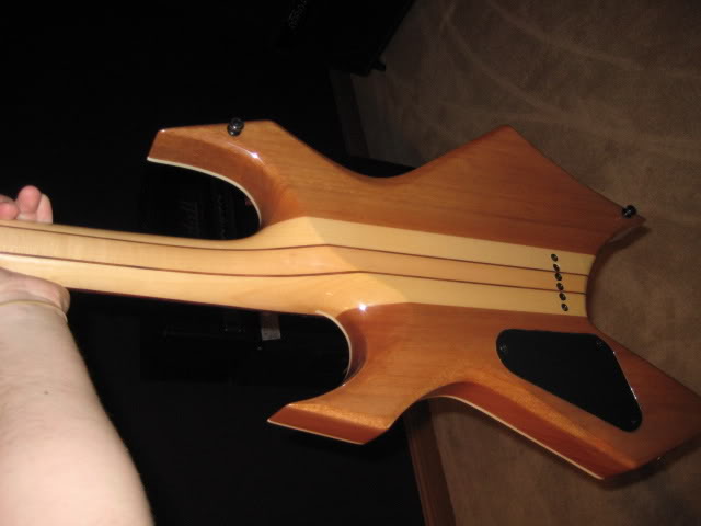

I'd locate the strap buttons in a similar place as on a real Warlock. It's actually been hard to find a picture of the back of one, but I found this, which should provide enough information for you:
Attachment 21800
Just don't put them too near an edge. I'd also suggest using a dab of PVA or Titebond glue on the screws as it helps keep them in place. Because of the strap button locations, I'd suggest swapping the standard buttons to straplocks, as there's going to be a bit of a twist on the strap when it's on the buttons, and you don't want to see it falling off.
Sensible advice there Simon and positioning quite high on those rear horns will help to keep it fairly well balanced for such a wicked shape.
Top job with the finish, and yes, black does show up lots of finger prints and tiny little scratches over time. All part of the ownership experience with dark coloured things.
