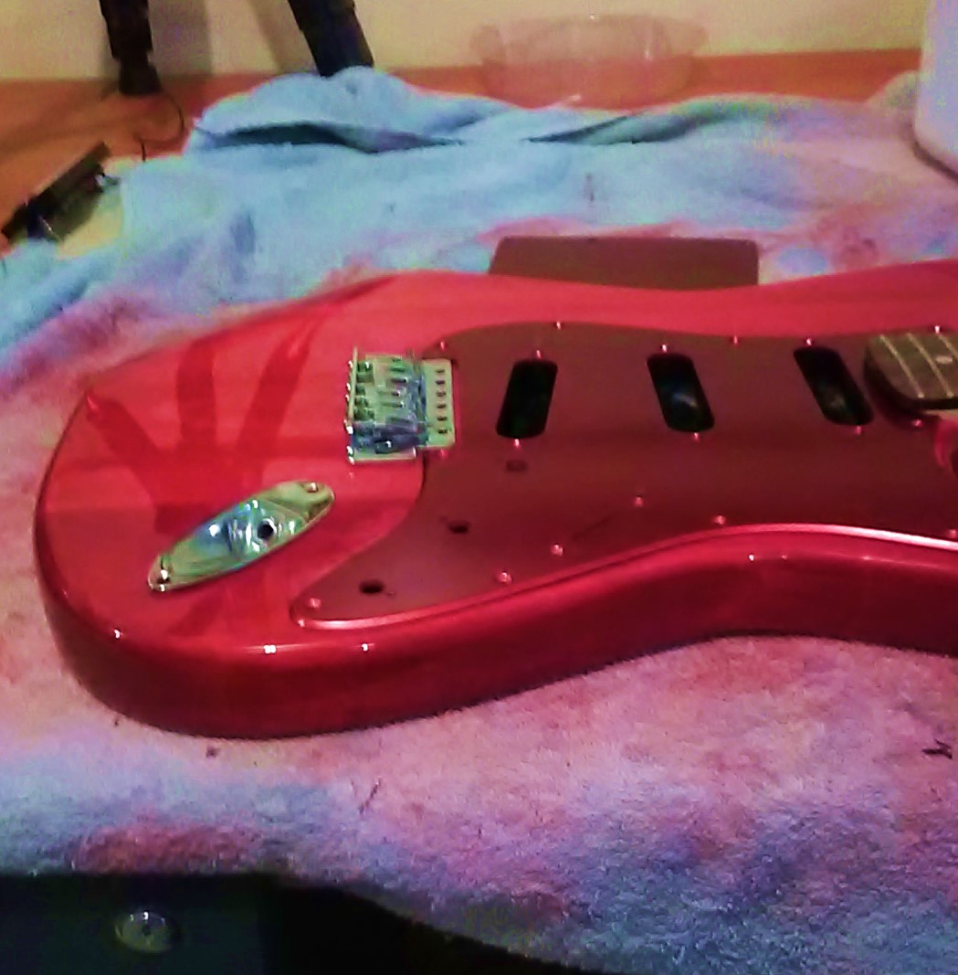

hi guys bit of an update on the lag, i decided to smooth out the front of the body as wasn't sold on the lip, i have tried something different i laid down a red base coat 2 coats and went over the top with candy apple red tint its come out a very deep blood red rather than a silver base and put 6 coats of clear the pic's dont do it justice. Paint is pretty soft as weather sucks atm here in Adelaide going to haft to leave it a week before i polish it have put up a pic that shows the ridge on the front more pic's to come but you can see where im going with it

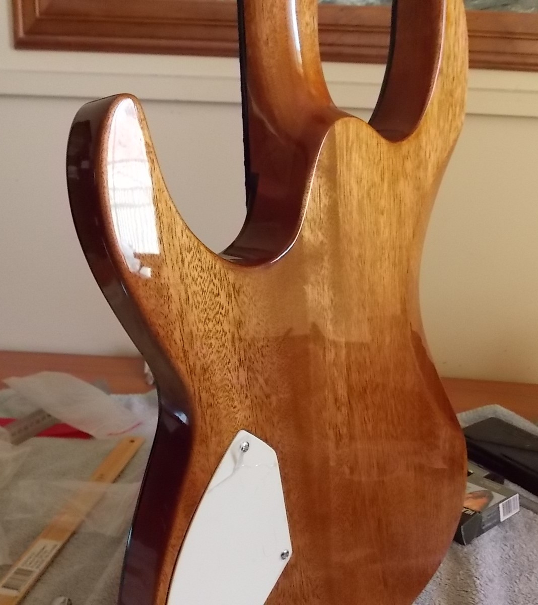

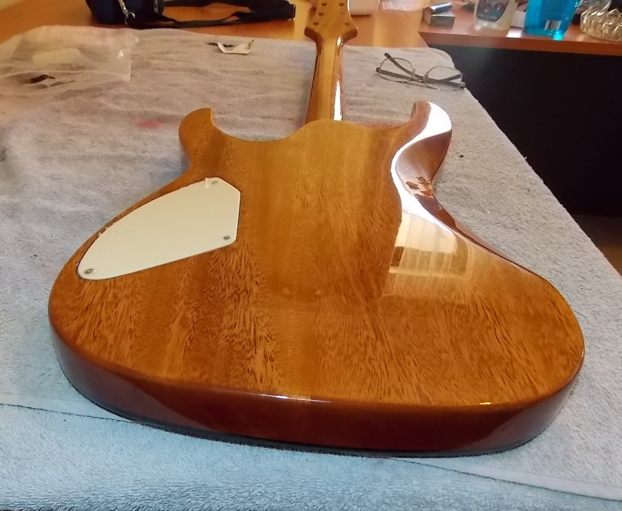

Cheers guys, the Lag is finished very pleased with it its now in my top 3 guitars i have and play every day, colour is amazing but cant get a pic that shows it, i have upgraded pups and surrounds from black to cream, pots and control knobs to Les Paul type. for those who want to copy the colour its 4 coats of hi fill then 3 coats of shanghai red then 4 coats candy apple clear then 10 coats of clear lacquer w&d then 2 flow coats all up i have 110 hours in it heap of sanding to level out the front and smooth out where the knobs are went the extra mile because it will replace my Les Paul with i find to hard to play in a wheelchair anyhow hope you guys like it. that's me till after xmas and PBG have no stock of the one i want

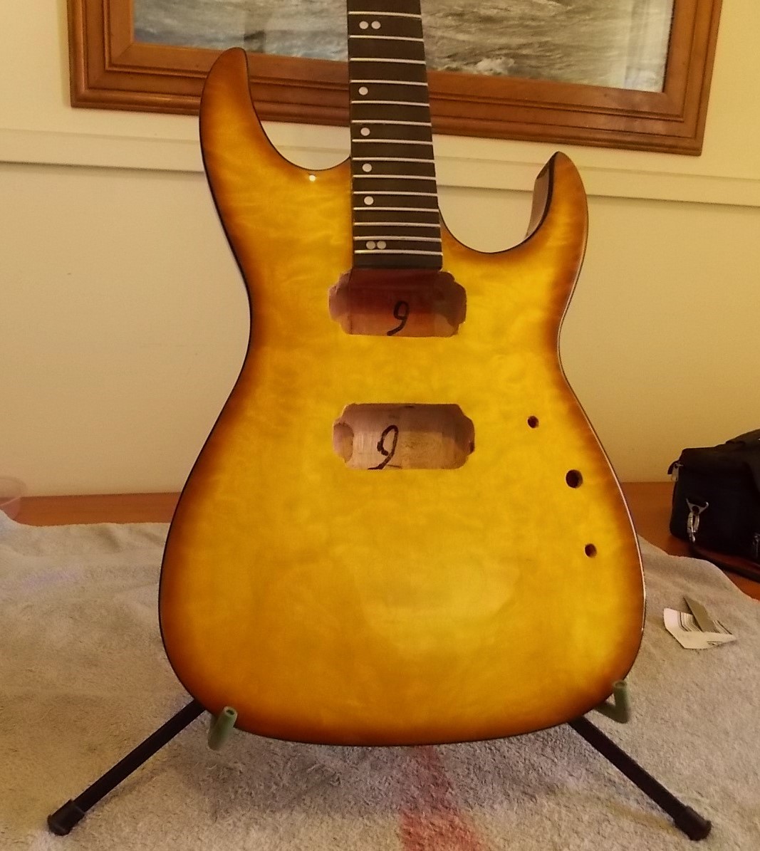

here is my GS2Q not finished yet as still waiting for parts (bridge, top mount string Ferrules) i would not recommend this kit for the 1st time builder as had some really tricky issues to fix the veneer was higher than the binding and over it in places which took a fair wile with a blade to get it sitting against the binding and the neck took heaps of work to get it just right and of cause the bridge and top and bottom Ferrules that need some pretty accurate drilling not for the faint of heart. Any off them done wrong would bugger up the guitar. i have gone with a yellow dye and a brown dye which i diluted quite a bit to get the back light enough but did a full strength to show the mahogany grain 1st then sanded back with full strength brown to highlight the grain, Dyes i used were Rit dye's i got from lincraft and worked really good. i sprayed the same diluted brown for the burst and went finally over with clear its not finished yet

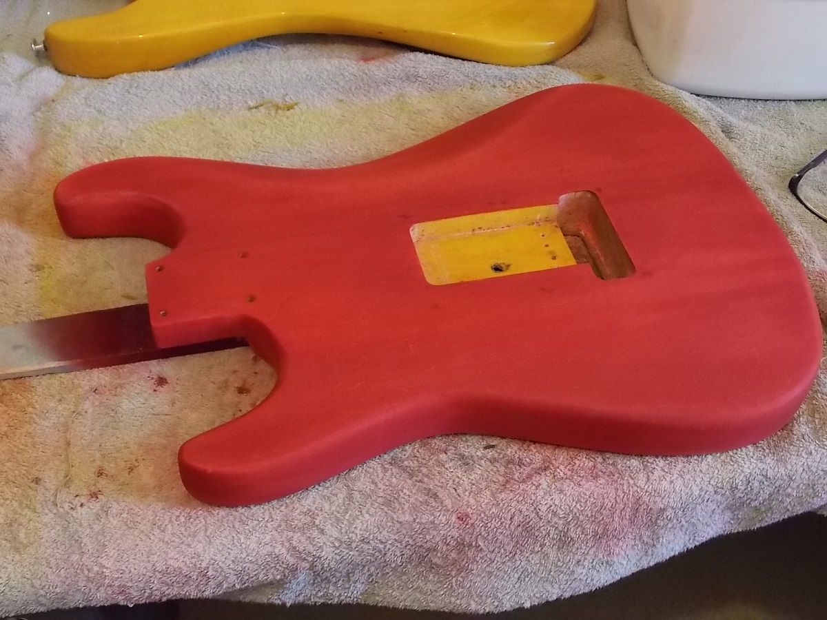

heres a 3 day wonder i been playing with rit dye with different strengths i found mixing 200ml to a box of powder worked best i did 2 coats and let it dry and then wipe it down with a damp sponge till i got the grain showing that i liked worked best, diluting it by 400ml was good for letting the colour to come to a more lighter shade, this isnt a final job as i did it in 3 days, i dye and damp sponge day 1, i shot the clear day 2 and wet&dry and polish day 3. Im going to try some more colours have done yellow, brown and red so far which i'm very pleased with results. I'm going to try blue and green this week, using it was not much different from using colortone dye had no issues with lacquer in fact it was pretty painless so here's a few pic's a pack of the powder was $8.50 far cheaper than dna candys which were just over $220 a tin but you get a lot of body's out of a tin, i think you can get Spray chief for $125 a tin but you require good gun skills to keep it even and not blotchy
