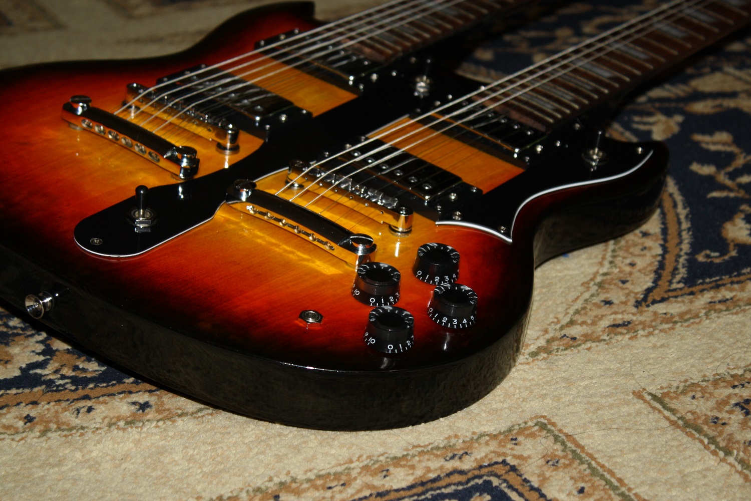

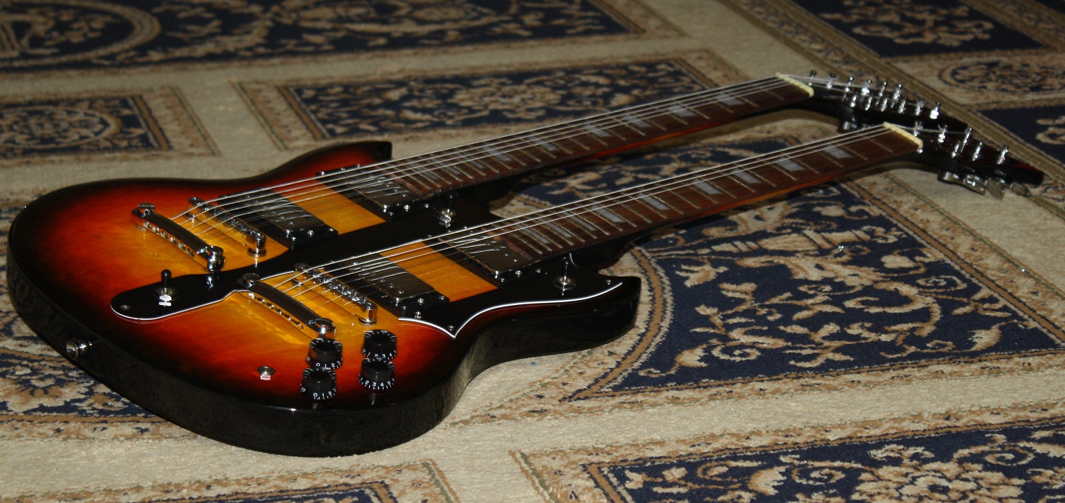

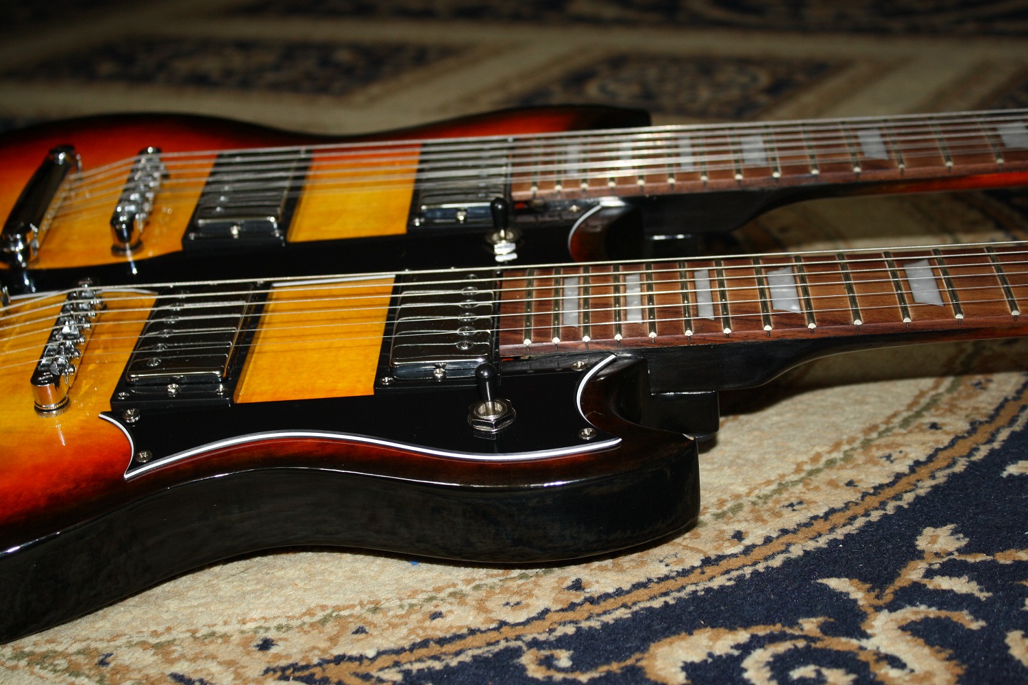

Finished
minor tweaking and intonation needed
Well this is one of my better online purchases I have performed whilst intoxicated. It kept me busy for 9 months and 11 days!
A couple of things:
- This kit is completely PBG stock EXCEPT I pulled apart the pickups swapped the ceramic magnet with alnico 5's and wax potted them. - It has all the other Chinese parts and electrics installed in it, including the strings, which are being a bit temperamental.
- I used Brendan's wiring diagram, which worked perfectly! http://www.pitbullguitars.com/wiring-diagrams/
- If you are considering this kit, you will need to plug the existing jack hole and drill a new one.
- If you are considering a Dingotone burst....do it! take note: Blackstump on Basswood body is uniform with the maple neck!:cool:
- it is finished with Tru oil - sorry DB:(; and
- it weighs 4.5 kg (or 9.9 lbs)

nice work Andy, came up a treat buddy and the video sounds great some cool noodling. Must take a while to get used to the size of the body and the twin neck positions.
You have inspired me to finish mine, few more in the queue first ! haha
Thanks Wokks, it does and my weak fingers need to get used to the 12 strings!

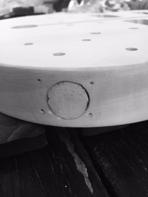

I should post one more photo as it related to questions some people had about dingotone.
This is a photo of the jackhole I plugged with a but of pine and some neutral timbermate. after 3 - 4 stain coats and 3 -4 costs of intensifier of Dingotone black stump, I almost cannot see it!

I just watched the demo video of your double-neck SG, she looks really classy, and there's nothing wrong with your playing, you're way better than me, your playing has a great bluesy feel to it, I also like the tones you got out of the guitar, cheers for posting the video mate, one day I might order a PBG double-neck SG.
Looks awesome Andy!
Great demo too!
Lovely work Andy, sounds absolutely silky. Top Job!
Gee, that looks the goods. Fantastic job. Don't think I've ever seen one of these with a burst, but I have to say it beats the classic trans red by a country mile. Love it.
Wow Andy, you have to be happy with that, not only looks great but sounds great as well. pat yourself on the back , well deserved.
Looks fantastic all buttoned up, Andy. That burst looks even better with all the hardware and shinies, great job.
Well, even though you put the 'ding' in Dingotone, it's all come up looking and sounding lovely. A great job and a nice demo video.

Hi Andy, Congratulations on the safe arrival of your newborn after 9 months and 11 days gestation period. Good thing about this one is you won't need to change any nappies, just strings instead.
Looks great and for stock PUP's they sounded really sweet and authentic to that style of guitar. Have you tried playing it with a strap standing up? Reckon it will be plenty neck heavy and you may end up having to move the strap button to help with getting the balance right.
Well done Andy building this guitar was a mammoth effort and it has turned out beautifully. I like the demo, sounds great
Thanks guys for the great comments. It was well worth it.
@DK, I think thats a good thing checking that browser history
@Waz, yep i've changed enough nappies ...ha ha. Yeah i have used the strap, the weight of the 18 tuners kinda outweighs the basswood body, so if Im ever good enough to play this thing at a gig, i'll have to re-position the top strap button.
Cheers Andy.
I found out recently how neck heavy the EX-5 is when using a strap as the only spots for the top strap button are a fair way back towards the middle of the thing. It also has a very, very long neck with 5 tuners hanging off it which doesn't help trying to keep it balanced at a comfortable playing angle. Suppose I will get more used to it over time, will just have to practice more standing up than playing sitting down.
