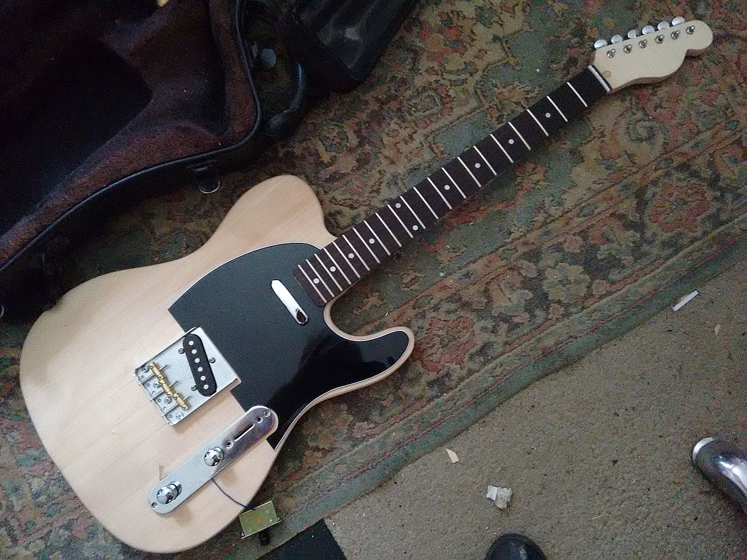

*Reality Check*
Decided that as the buzz-word for this project was 'work-horse', a one-trick-pony approach was not ideal.
So I decided to include the neck pick-up.
Attachment 30557
Now awaiting the upgraded 3-way switch and jack plate.

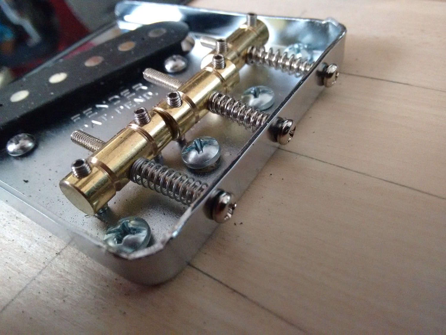

Doh!! plan was to 'top-load' the first stringing up to check for intonation.
Unfortunately discover that the original 'Fender' bridge is 'string through' only.
Attachment 30558

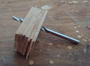

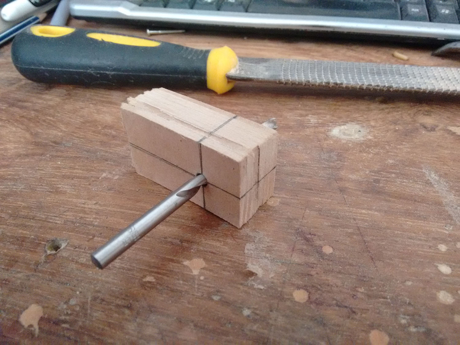

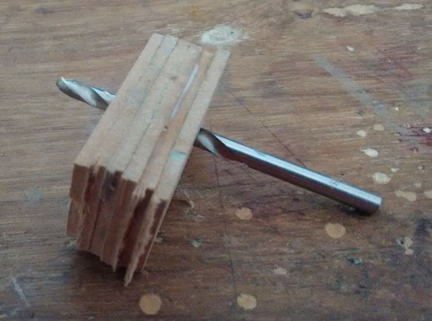

Anyway. Following this 'drill-a-straight-hole-through-wood' tutorial https://www.youtube.com/watch?v=5SZA03DVITA
Here's my straight hole jig drying.
Attachment 30561
cheers, Mark.

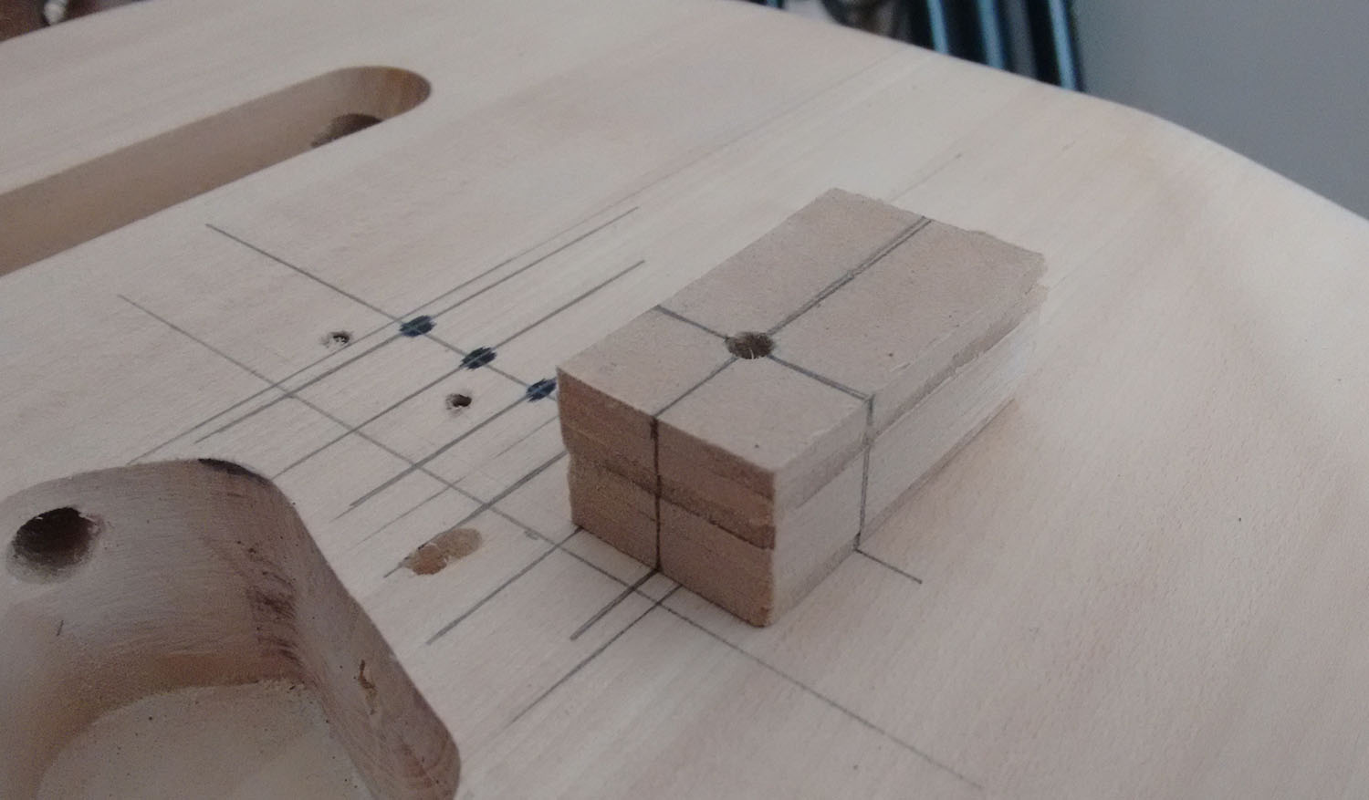

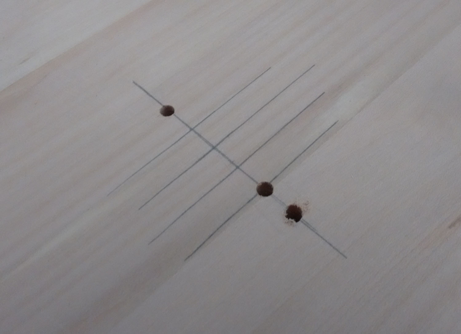

Here we go...straighten the edges and mark it out.
Attachment 30562
Fingers crossed...
Attachment 30563

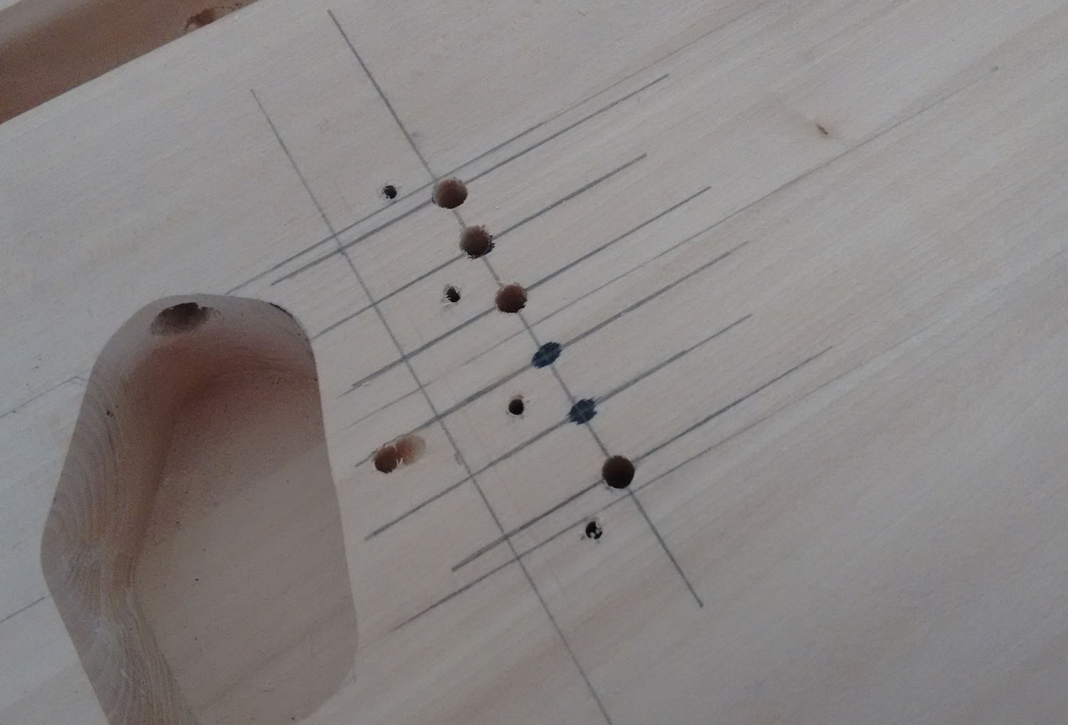

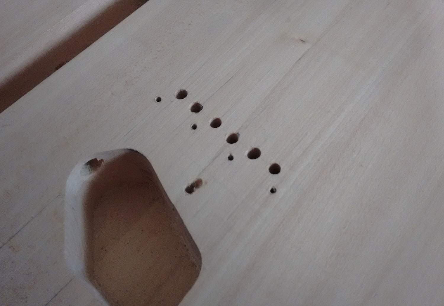

First 2 edge holes I drilled right through.
Marked out from those on the back where the other 4 should go...
Then drilled them half-way from each side (back and front of guitar).
Attachment 30564
Attachment 30565
After the clean up, not too bad for a first go.
Attachment 30566 front
