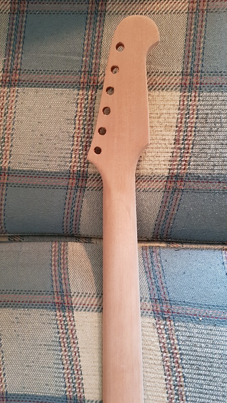

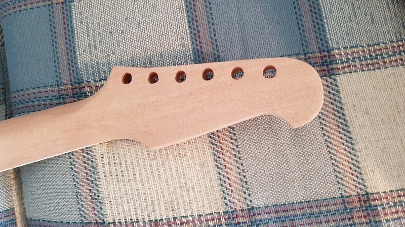

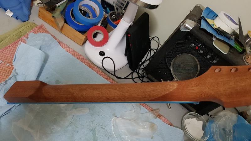

Well I have sanded and shaped with fretsaw, rasp, file and 60 and now 80 grit.

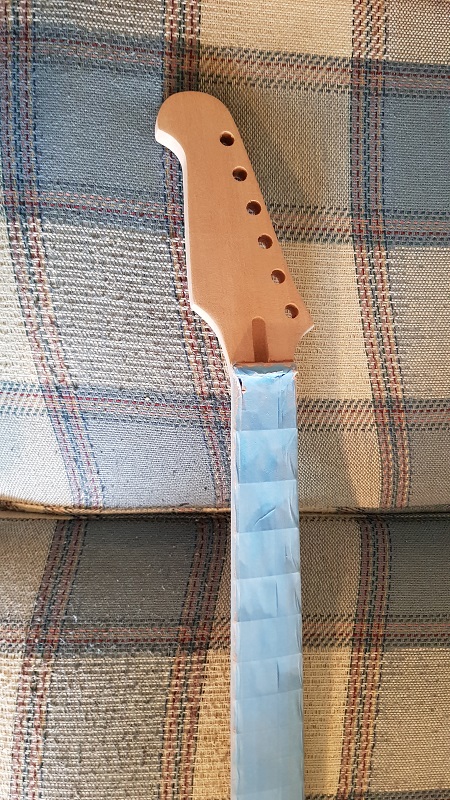

I am about to go over the whole neck with 120 grit.....then mask up the fingerboard and do some timbermate to fill her pores.
The design is very traditional FIREBIRD but with little changes....length...width....shape near the nut.

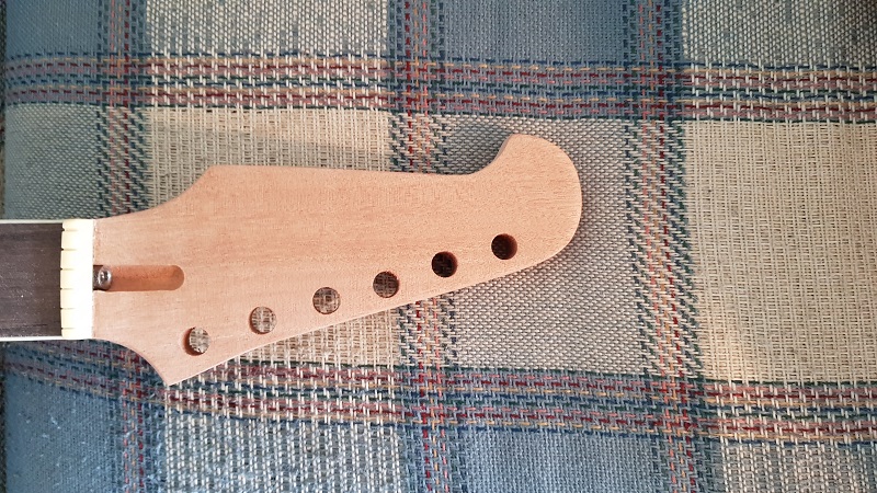

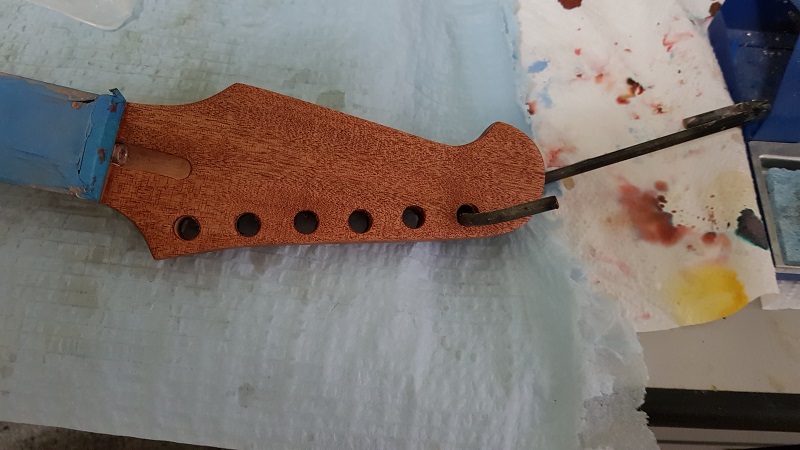

Sanded to 180grit.....then she has has been slopped with mahogany timbermate and then hung to dry for about 90 mins. Sanded to 240grit now. Hang up tonight and see how she looks in the morrow.

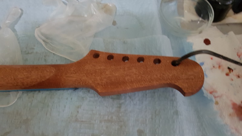

I cannot believe how much jumps out of wood when you drop a little TRU OIL onto it.

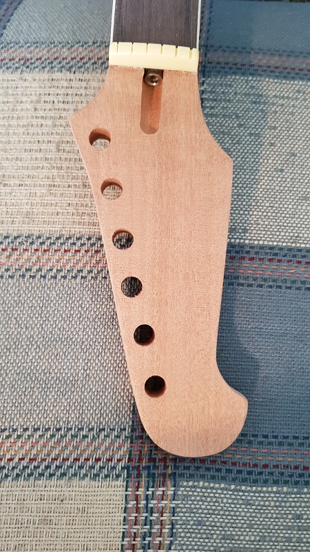

Mahogany neck and headstock.
Little bit of figure on the middle of the neck...but the normal Mahogany spots really show through.
I think that may be enough for now on the face of the headstock until I receive my ordered marquetry veneer pack....but I can keep oiling the neck. :)
Wow, you're not wrong about the Tru Oil bringing it to life. It's good stuff!
