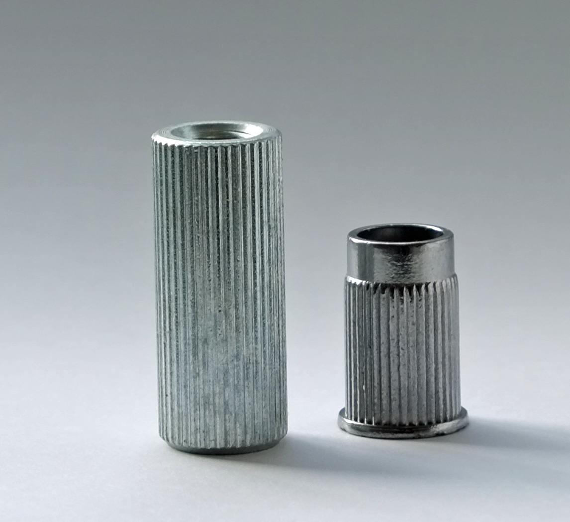

Just got the inserts from Amazon...
Attachment 24515

Put the new insert on the left and the standard insert on the right. The new one is about an inch (25mm) long, and is definitely what I will use if I put this bridge on something. Came in a pack of 10 for under $7.
It looks a bit narrower than the standard insert, so you'd probably want to drill your own bridge post holes. You want the whole of the insert to be in contact with the wood, not just the tips of the threads, otherwise they'd work loose pretty quickly. (I know that you know this, Fender3x - just elaborating for any others who might read this).
It's a shame that you don't seem to be able to get M8 (or the slightly smaller imperial post size) inserts any longer than 1"/25mm, as 1.25"/30mm would be a nice size to use in other possible pull-out situations.
It's less important for a bridge-only fitting, as almost all the force is downwards (which is why Gibson could get away with short thin posts that screwed directly into the wood on their ABR style tune-o-matic bridges). It's the stop-tails and wrap-around bridges that have all the sideways force on them.
Dickybee007, that's certainly a good idea, though would a standard bolt (the hole size on my bass is about 10.3mm in diameter) have wide enough threads to grip the wood firmly enough? These specialist thread things have extra-wide threads to help grip the wood to give extra protection against pull-out, so it would be nice to work out a suitable test to compare the tendency of the hex inserts against a standard bolt thread to pull-out over time.
Looks are certainly an issue in some situations. My Hipshot bridge covers up the inserts as it sits right on top of them, but in other situations, they are going to be exposed. That's where the hex inserts fall down.

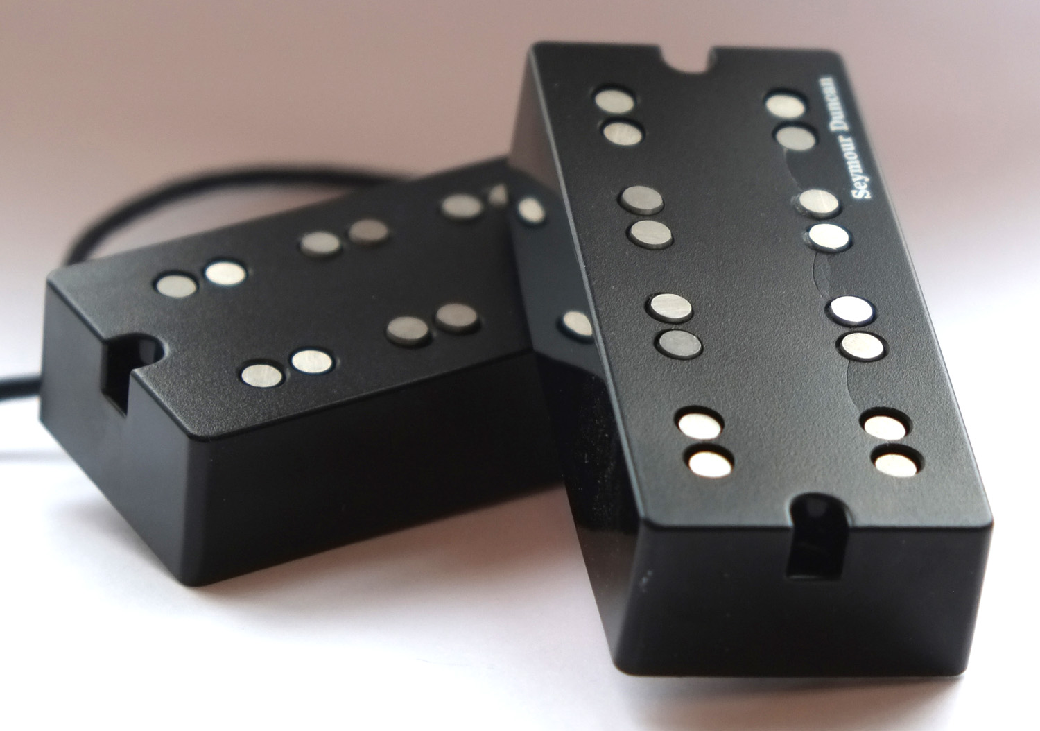

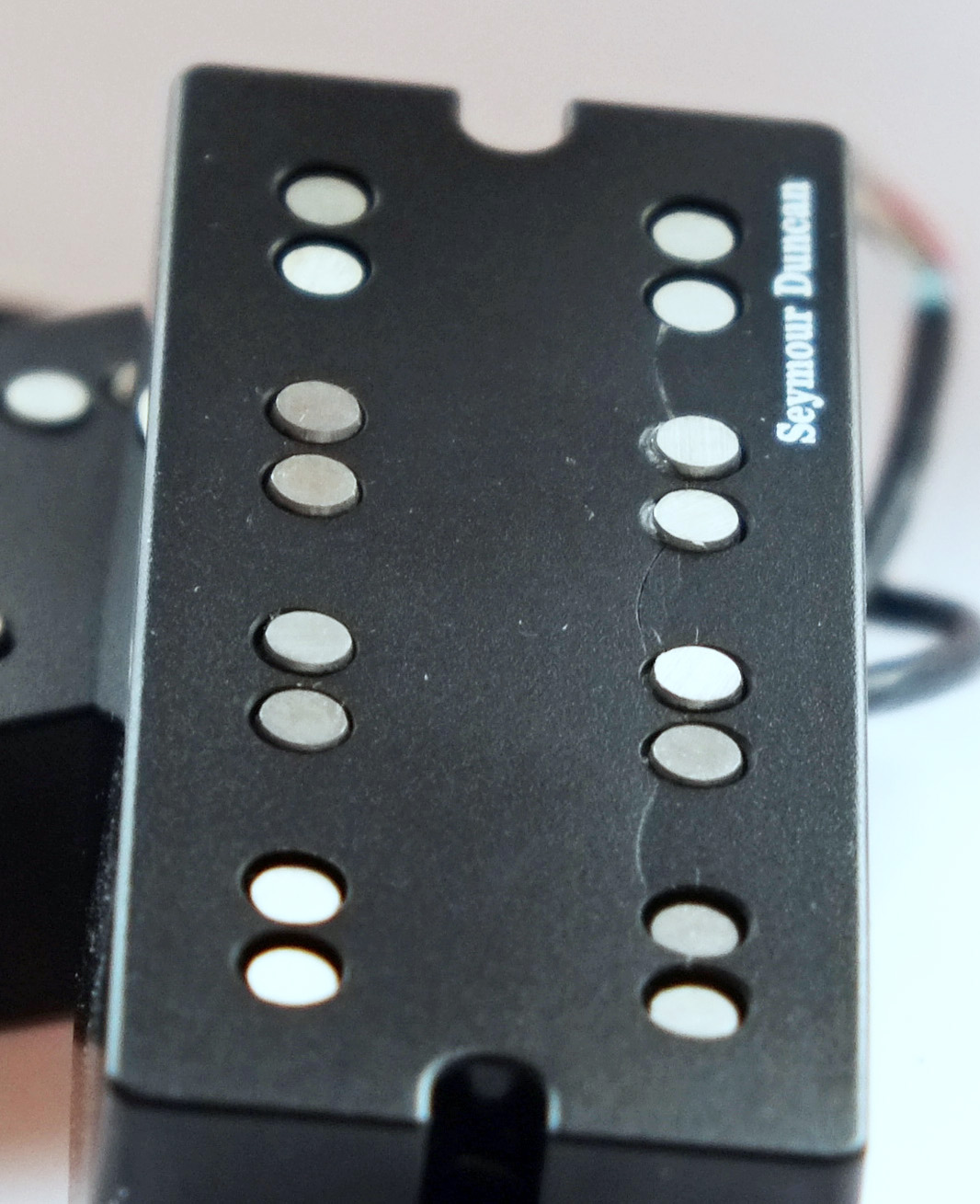

Replacement pickups arrived today. Swearing was involved.
Attachment 24532
Attachment 24533
Not as bad as the first set, but totally unacceptable. Obviously SD have an assembly and QA problem, but I can't believe the store, Guitar Guitar, didn't check before sending these out. I have sent the obligatory email, but I also copied in Rosetti, the UK distributor.
It looks like whoever SD use to fit the covers on has long hard thumbnail and is using that to press the cover into place, moving along the pickup and damaging them in the process.
I await a response.
Wow. Once, maybe. Twice, no.
At least they're fulfilling the consistency aspect of QA. It may not be good, but at least they're all the same.
It's a good thing I haven't tried to rout the body for the pickups yet, for if all of them come like this, then I'm getting my money back and am going to have to rethink the pickup selection.
