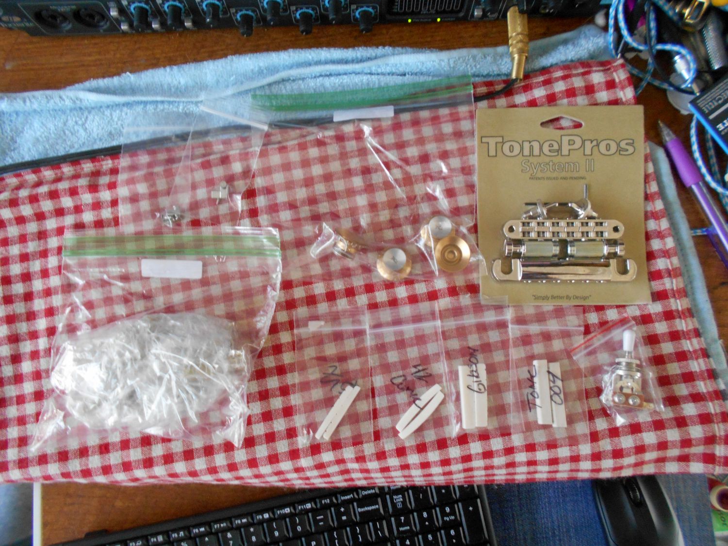

And here's a pic of all the stuff that was in the parcel, it looks like everything I ordered is all present and correct, so I'm happy:
Attachment 24527

So, for those interested, here's a list of the contents of the parcel:
X1 Tone Pros System II Tune O Matic Bridge And Tailpiece Hardware for Gibson guitars.
X1 Full Set Of Gibson Deluxe Keystone Tuners (With screw-in ferrules).
X2 Gibson Gold Volume Control Knobs.
X2 Gibson Gold Tone Control Knobs.
X1 3-Way Toggle Pickup Selector Switch For Gibson and Epiphone Guitars.
X2 Tone Ninja Nuts For Gibson Guitars.
X2 Bleached White Bone Nuts For Gibson Guitars.
X2 Bleached White Bone Nuts For Fender Guitars (Flat-Bottomed).
X2 Bleached White Bone Nuts For Fender Guitars (Curved Bottomed).
There was also two new chrome roller string trees for Fender guitars in the parcel as well.
