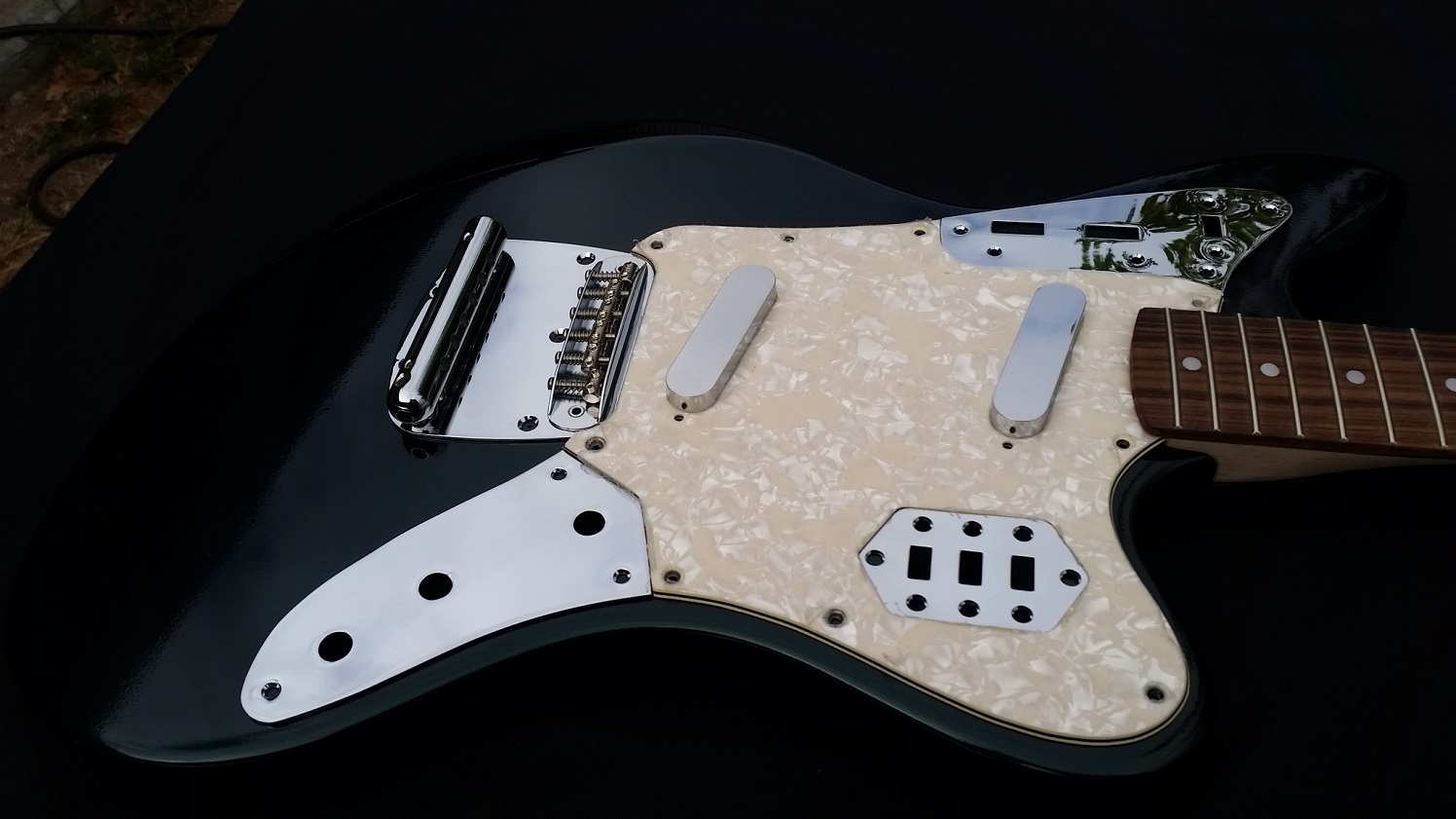

Cut overall shape for the pickguard and the cutouts for the pickups and the switch plate with a scroll saw.
Attachment 31354
Then used my improvised router table to tidy the edges and used a 30 degree chamfer bit to put the angle on the edges.
Now I can see why the usual is 45 degrees, it gives a better separation of the pickguard layers on the edge , but this will do for now.
Attachment 31355
A mock up, pic is a bit dark
Attachment 31356
Now the hard part begins.....eeeeek.
Attachment 31357

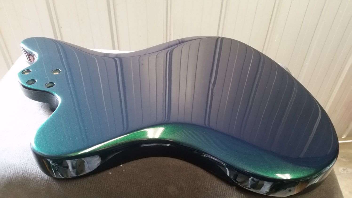

Seem to have hibernated during the cooler months, guitar building-wise, and only progress to show is that the body has been polished.
The finish has settled enough that the trem cavity repair/fill on the back of the body is easy to see with the naked eye, having a hard time getting a pic to show it, if look in the right spot you can see the bottom edge in this one
Attachment 32459

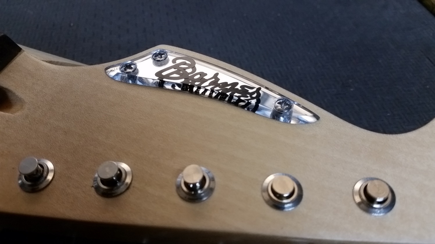

There has been some progress with this one. Made a template for the shaped piece for the headstock and used that to make a piece out of mirrored acrylic, the thinking being it wouldn't weigh much.
Attachment 33686
Once the lettering was applied it became obvious the acrylic wasn't going to do the job.
Attachment 33687

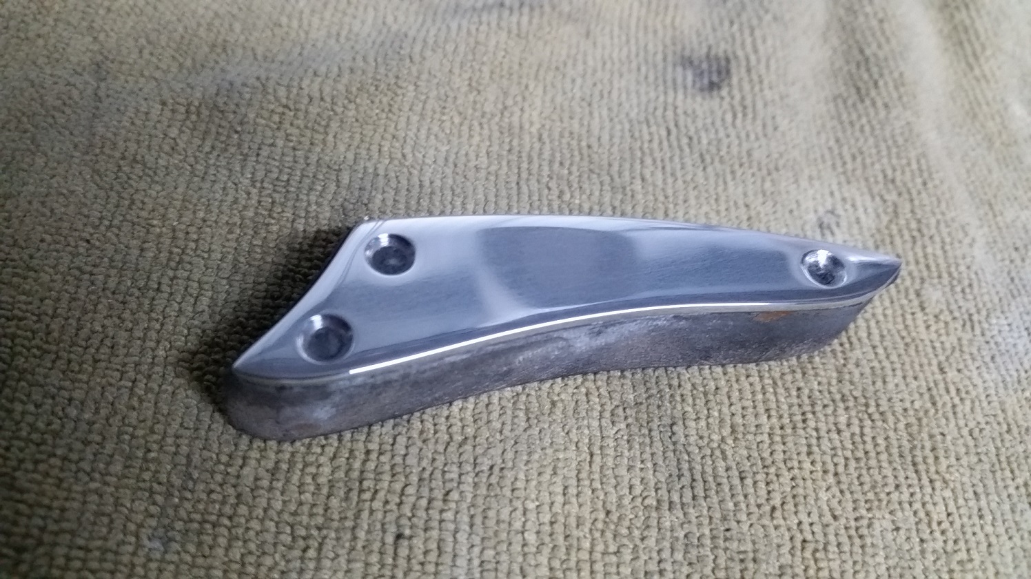

Started again using aluminium, polished as well as I could get it,
Attachment 33688

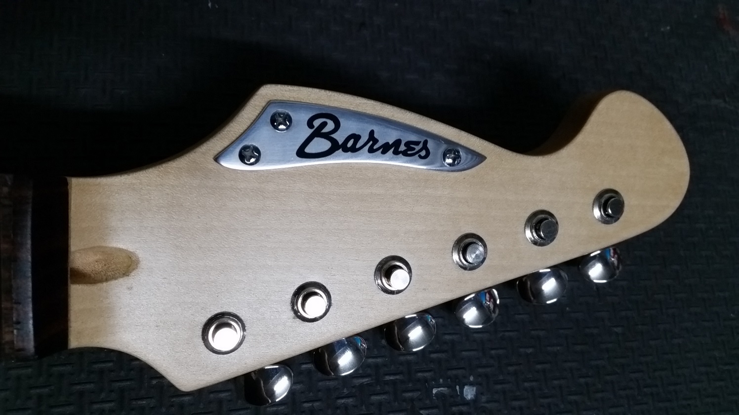

New bit in place
Attachment 33689
and comparison showing why the first one wasn't going to work well.
Attachment 33690
