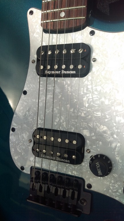

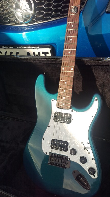

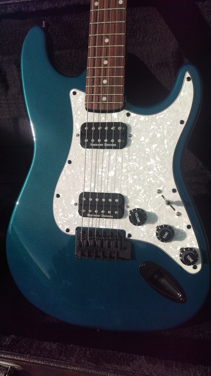

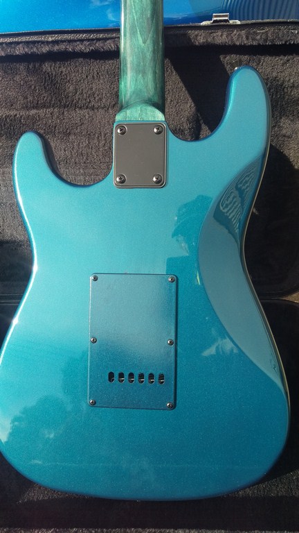

Hi guys, this is my first build and with plenty of help from the guys here its finally finished.
Quick rundown..........
Aftermarket Pickguard to fit twin humbuckers, white pearloid
Seymour Duncan JB and Jazz HotRodded Humbuckers
Upgraded to Grover Tuners
Black hardware

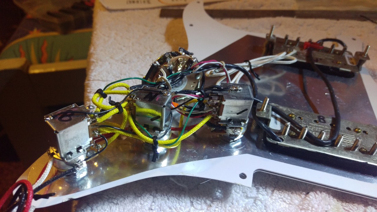

Copper shielding to humbucker bays
3 aftermarket push pull pots to ...1) split the pups 2) series parallel options, 3) in and out of phase.
Vintage cloth wiring
Treble Bleed mod
Plastic nut replaced with a bone one
Replaced stock 5 way switch with 3 way.

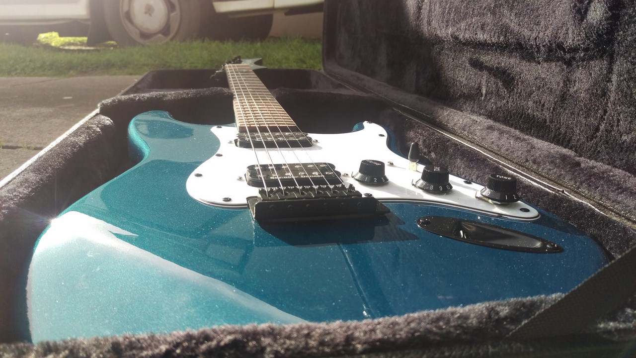

PAINT FOR BODY....
6 coats sealer/primer,
6 coats of black basecoat,
4 coats of metallic undercoat and
6 topcoats of clear 1k acrylic full gloss.
Sanded between coats, bodyfilled and finally buffed and polished

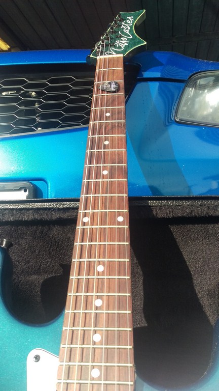

NECK AND HEADSTOCK
Stained and finished off with wipe on poly, logo freehand drawn.
Attachment 13490 Attachment 13491 Attachment 13492
Attachment 13493 Attachment 13494
good stuff Nitro, you just need to post a close up pic of the headstock and back of the guitar
EDIT don't worry the pics just appeared.
