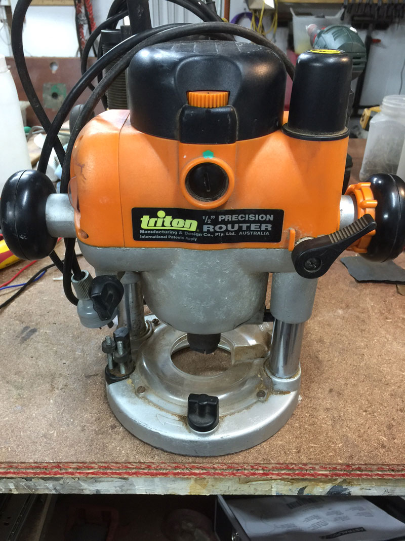

Success story #1
I have a Triton TRB001 router which I keep setup as a table router and the other day it just refused to work. So I took it down to my local reputable, reliable power tool repair man and found that he's closed up shop 18 months ago.
I phoned around and I'm informed that nobody imports Triton parts any more. (I thought they were an Australian product?) Two options... bin it, or download the parts list and work out how to dismantle the motor.
Took the second option - I found the brushes were jammed and not making a connection. Freed them up, filed out the brush guides carefully, put it back together and she's running like a charm. The whole exercise also gave me a much better understanding of how it works.
I've had this router for I don't know how many years and this is the first time I've used it in probably 6 years. Despite this small hiccup, I highly recommend this router, and in my search for a repairer, I found that they will soon be available in Australia again. (CarbaTec and/or United Tools)
Attachment 9515
