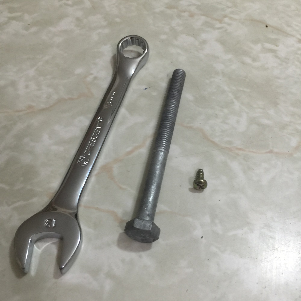

You'll need

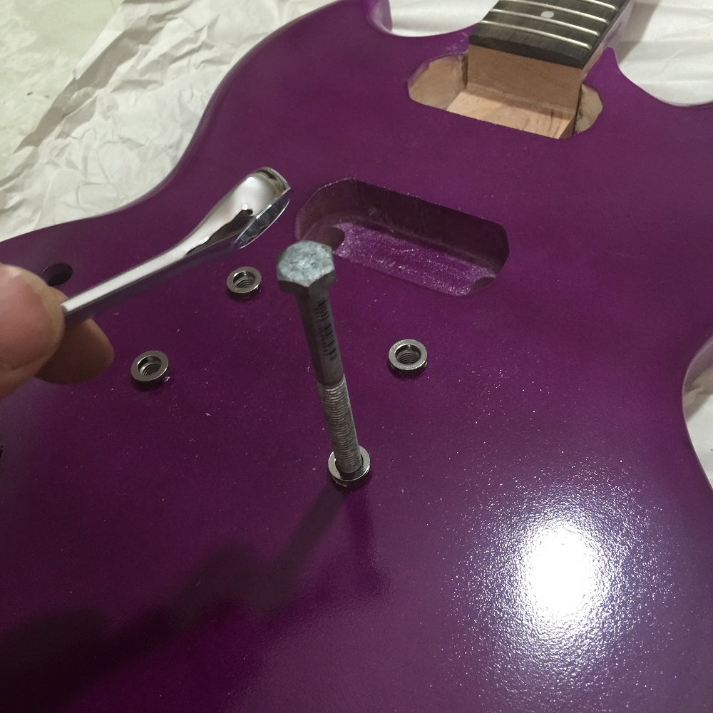

A small bolt or screw that will fit upside down into the bushing
The bolts for the bushing. Or optionally if you don't want to ruin the look of your bridge's bolt you can get an
M8 threaded bolt (Check the threading for your one, might not be the same)
Attachment 3975

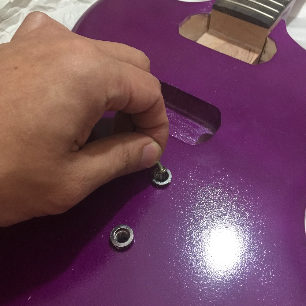

Drop the screw or small bolt in upside down
Attachment 3976

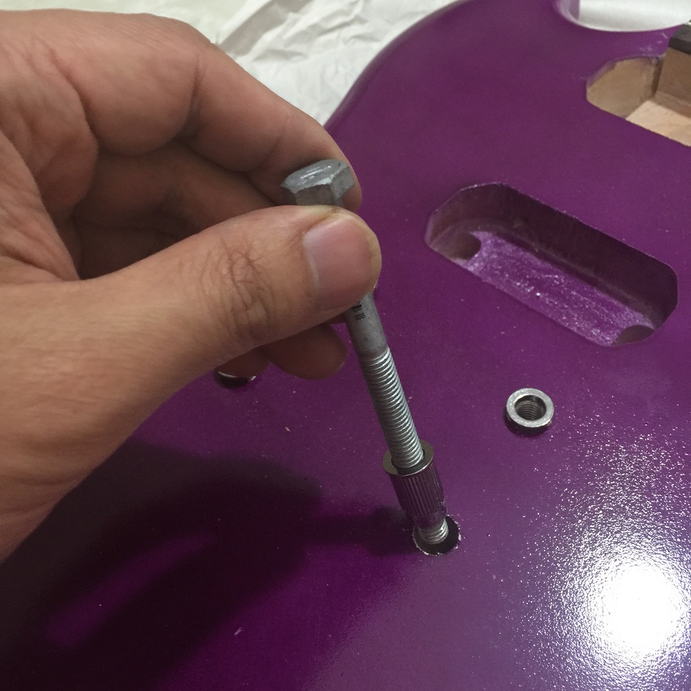

Attach your bolt
Attachment 3977
And screw in the bolt, which will push against your upside down screw and lift out the bushing
Attachment 3978
Abbra ca da bra!
