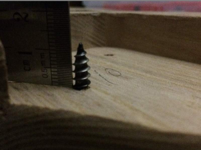

Is this enough neck bolt to hold the bass neck properly...
Attachment 2649
That's about 9-10 mm of effective thread protruding.

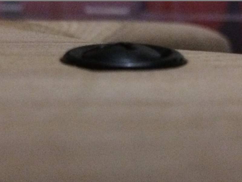

I look at the head of the screw,
Attachment 2650
and I wonder if that hole should have been bored a little deeper so the washer and head are flush. (I didn't change it, that's how it came. Perhaps I should have?)
Suggestions please.

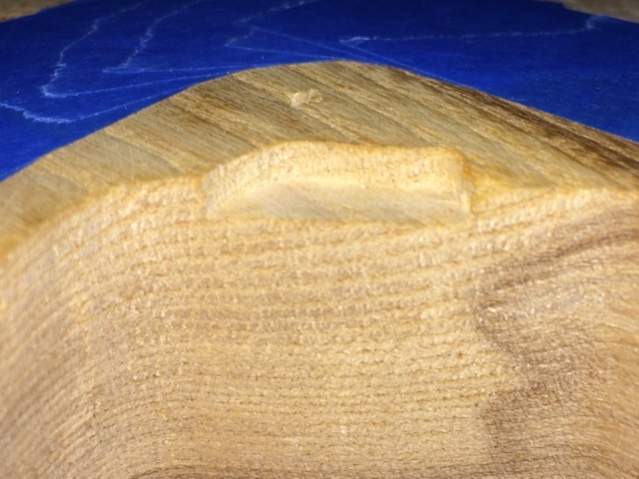

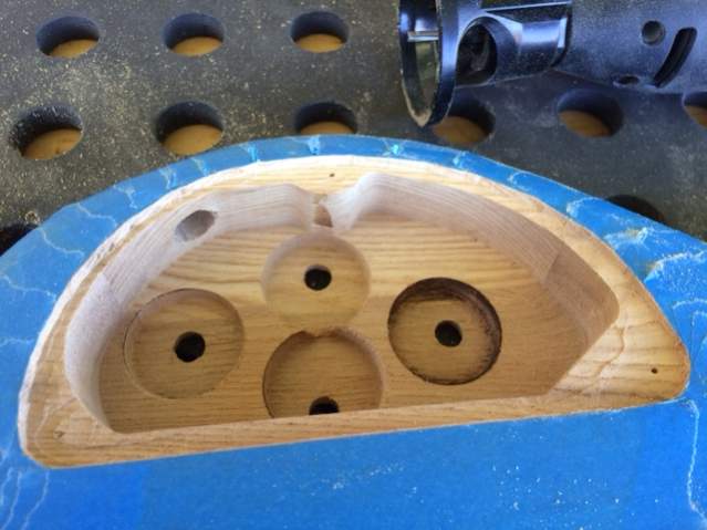

So I decided after much practice with a router bit installed in my dremel with the dremel cutting guide attachment I decided to do a test on a section of the cavity that would be hidden even if I decided not to go ahead with the recessing of the cover. It turned out smooth enough - my concern was that I couldn't predict how the wood would cut even though I'd practiced on a pine offcut.
Attachment 2651

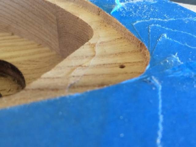

Slowly and carefully I used the dremel to carve out the ledge the cover would sit on. I had masked out the area to cut with painters tape following the edge of the cover as a template.

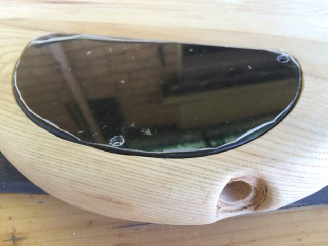

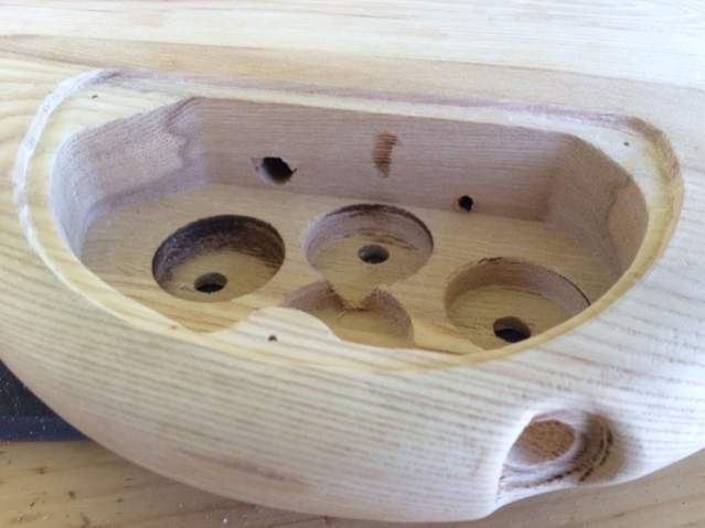

Attachment 2652Attachment 2653
The completed cover recess, open and with the kit provided cover in place:
Attachment 2654Attachment 2655
Happy with that. I may make another cover, one that doesn't have bevelled edges like the provided one - but I'll wait to see after the wood finishing before that decision.

I'm still concerned about the neck screws too. Looked at a few pictures of guitars using similar arrangements and they all seem to have the washers recessed or flush.
post a pic of the screws you have been supplied. My neck screw holes were recessed with black washers.
Edit I scrolled up and saw the pics, my screw heads are recessed further at least flush so I'd drill the recess a bit deeper
should be fine, might need to drill the 2 neck screw holes a bit deeper. Make sure you put the existing 2 screws in before you drill the other 2 as the neck may have shifted a bit
