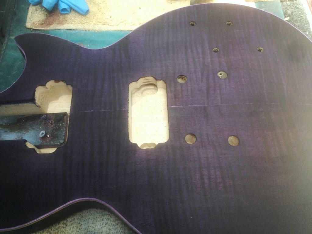

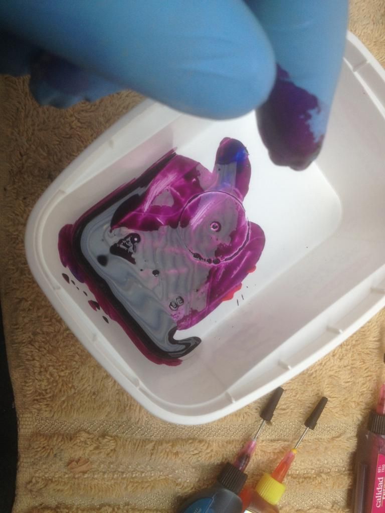

So she wanted purple, so it gets purple.

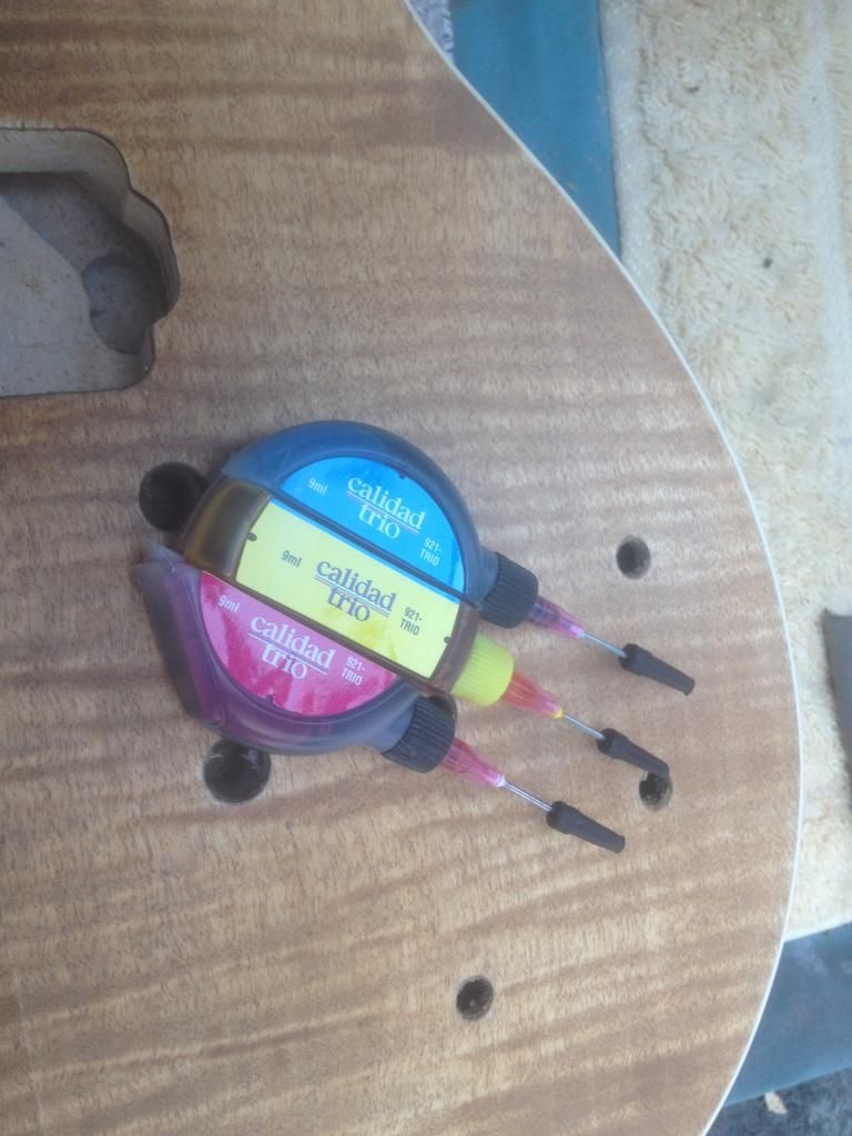

Sanded back the coffee stain, but just to knock down the grain, most of the colour stayed on. Then with a mix of red and blue printer ink, the purple stain is made:
http://i271.photobucket.com/albums/j...20LP/001-2.jpg
http://i271.photobucket.com/albums/j...20LP/002-1.jpg
first layer of stain:
http://i271.photobucket.com/albums/j...1e12a6d71a.jpg
Wow that deep purple looks amazing (see what I did there ;)
