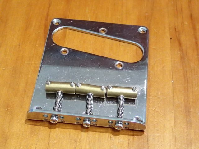

2. String through body.
I drilled string through for this guitar because changing strings on a top loading bridge (Squier/MIM style) was a pain. Unfortunately I still couldn't get a perfect alignment.
