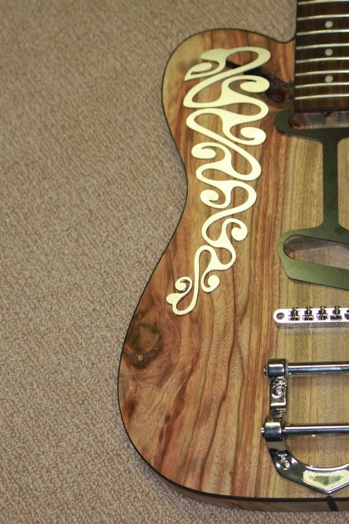

thats why i chose to ditch the standard tele scratch plate, gave me more wood grain ..as i said some will love some wont its subjective, for me its an experiment and learning curve in how to appproach different styles, so this axe will have a few of them, later on with more builds, things will become more polished and slick, im not sold on the ideas just yet so will try more variations with the G10 i have left and go from there!Istill have to get the pocketing system perfect and have to do the practice run in the live stock! best have no fear and take as many chances as possible!That top knot is not very attractive in real life is a 3d stuffup something you dont see with a 2d photo so has to be covered like a shitty tattoo done while you where 16 and drunk !

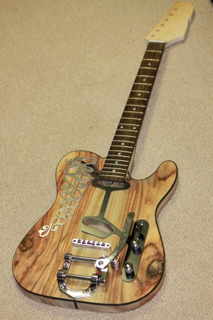

Ok new design as promised ..I pref this look with the grain once its polished up will gleam like the chrome, so will make a new design for the controls and PUPs to see that as well,

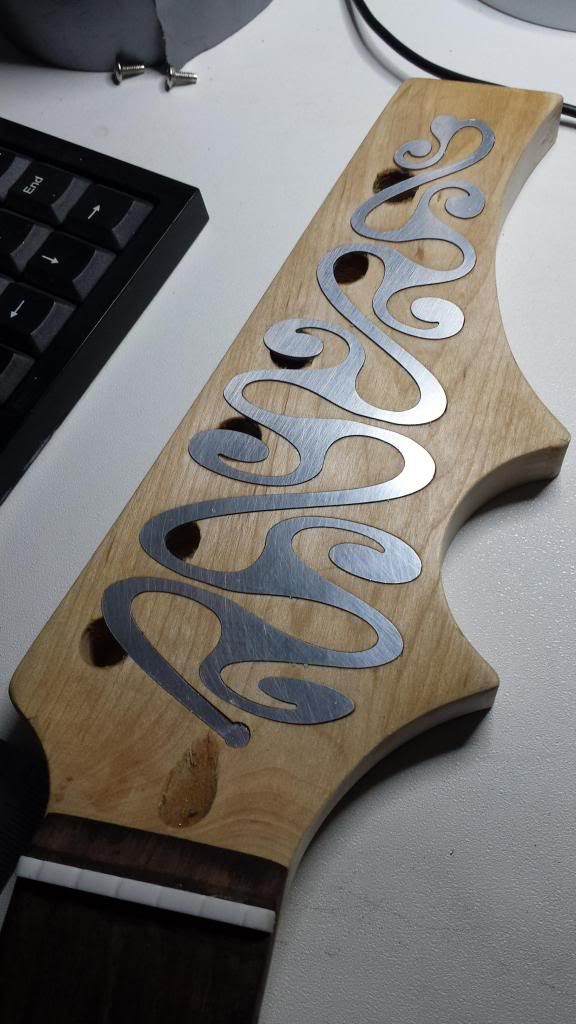

I may actually stick with the flower design but on the headstock will check out how it looks once its scaled down to fit and then also cut the headstock, by buddy started havin a go at this head but abandoned it so it will get some love in my cave!

yea it is bad..there is a piece of branch that is inside the knot that came out clean ..so I epoxied it back but still a massive hole that needs filling ..I will machine the hole out and fill it with the stock that the plug came out of, well near that corner anyway the grain is pretty close so thats the next Job really before I machine the pocket for the inlay

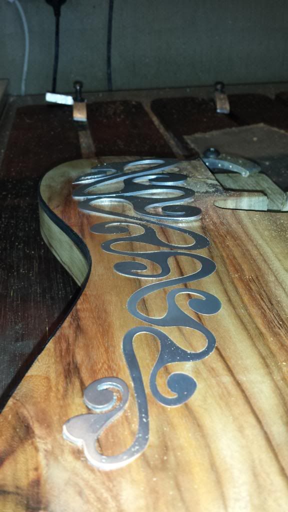

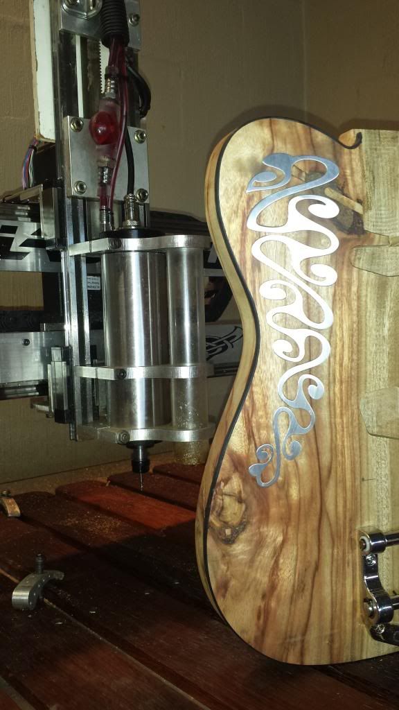

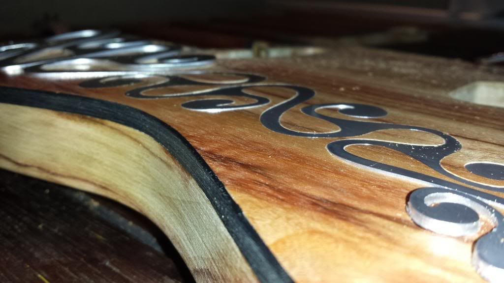

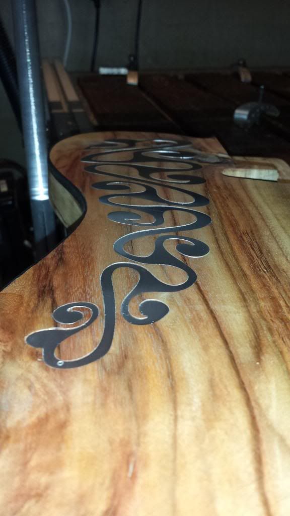

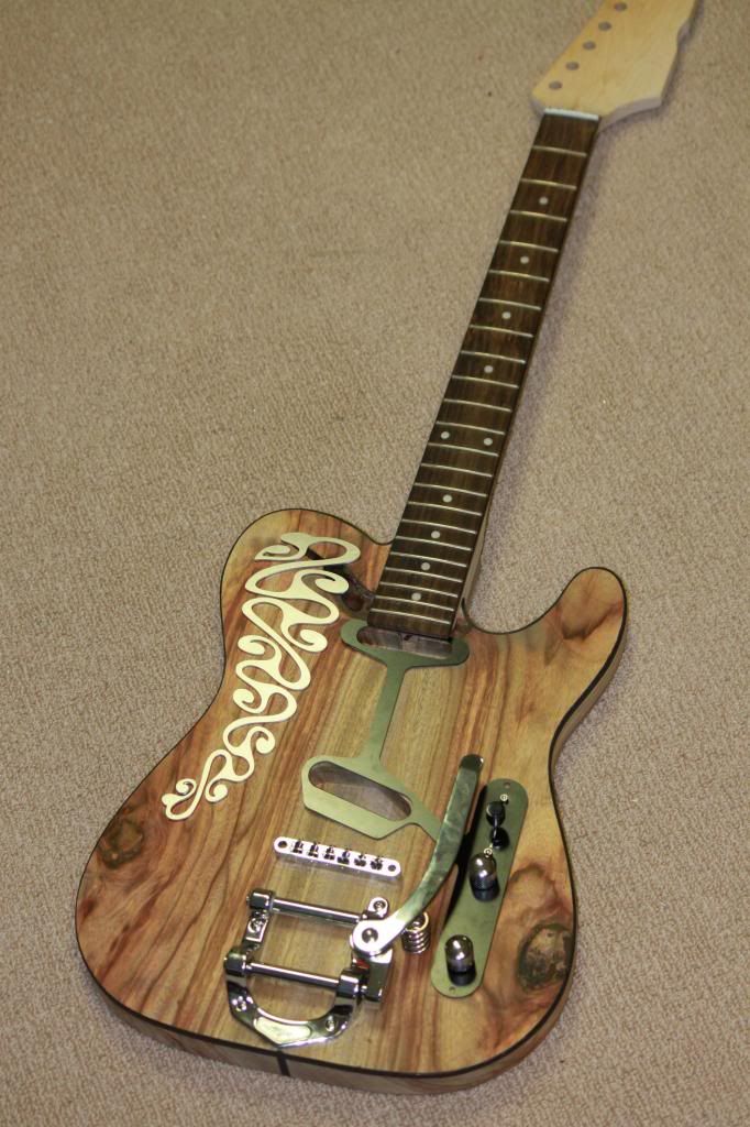

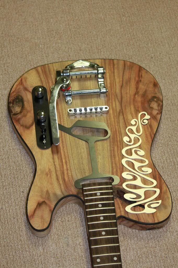

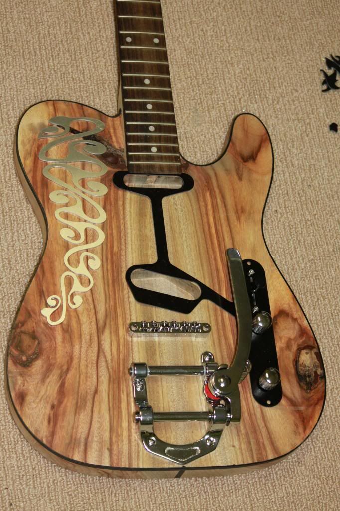

Ok inlay went in and a few hairs went out! Turns out if you want to pocket a curved surface (without Knowledge) you need a 4th axis machine the size of a house! so all I did was center line the guitar on a long oak dowel rotate to make the surface i wanted to pocket sorta level and did a 2D pocket , unfortunatly this method make an even pocket depth on an a curved surface. Not what i was after..so back to school and try learn some new tricks, but pretty happy with the outcome anyway! had to smack the inlay in with a plastic interface and a light hammer! I cut the pocket exactly the same size as inlay and we all know that will never fit...so made a new toolpath to take .2mm off the walls and its match made in heaven!

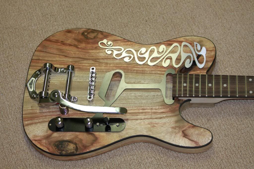

and standing tall with its maker!

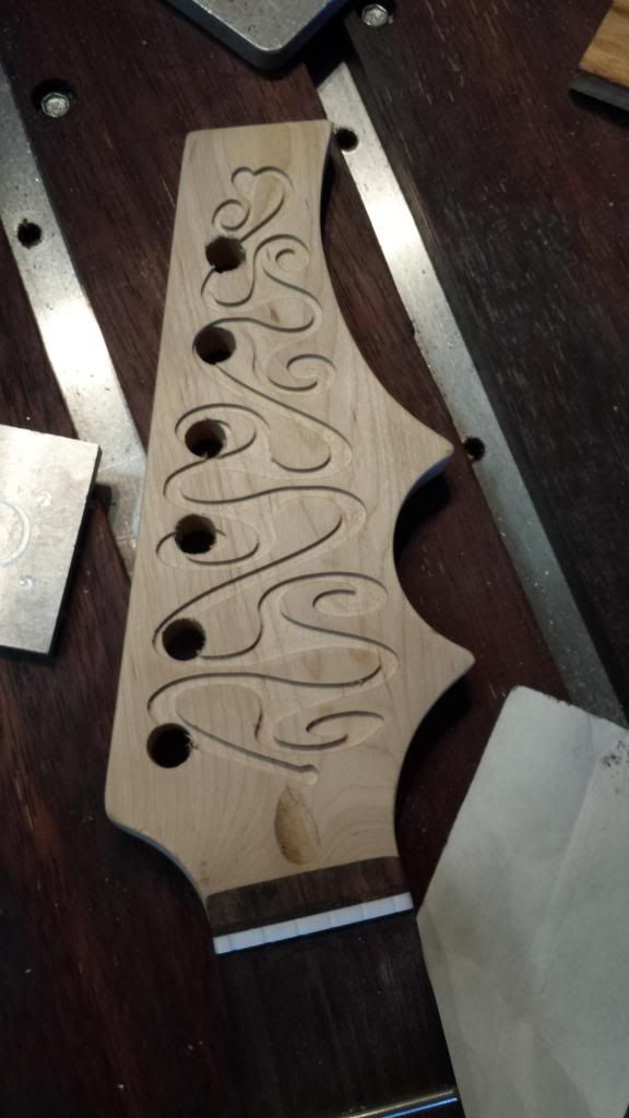

doing the headstock and the back now..hope to finish this today!

ALRIGHT! The serpentine style inlay has much more attitude IMO 8-)
