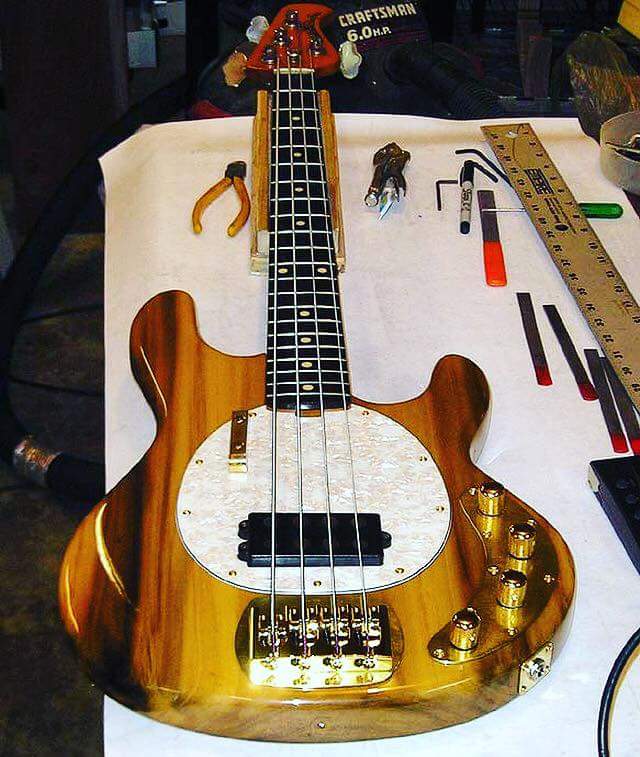

How's this for craftmanship!!
https://scontent.xx.fbcdn.net/v/t1.0...12&oe=5942DD05
https://scontent.xx.fbcdn.net/v/t1.0...27&oe=5903293B
https://scontent.xx.fbcdn.net/v/t1.0...7e&oe=59360378
Printable View
This build is still in progress, here's the body with some Naptha over the top.
https://scontent.xx.fbcdn.net/v/t1.0...88&oe=59347BD2
The neck being built
https://scontent.xx.fbcdn.net/v/t1.0...27&oe=5958995F
Carving the face of the headstock!
https://scontent.xx.fbcdn.net/v/t1.0...53&oe=5966CFD0
And now, the ultimate fretboard!
Started with Ebony FIngerboard
https://scontent.xx.fbcdn.net/v/t1.0...db&oe=59054C8B
Cut the fret slots
https://scontent.xx.fbcdn.net/v/t1.0...1d&oe=59003361
Cutout where the inlays will sit
https://scontent.xx.fbcdn.net/v/t1.0...9a&oe=59042B9A
Glued white veneer to the fret slot sections
https://scontent.xx.fbcdn.net/v/t1.0...3b&oe=5909CA54
Preparing the Inlays
https://scontent.xx.fbcdn.net/v/t1.0...32&oe=593C2D63
Masking the fret slots to keep them clean
https://scontent.xx.fbcdn.net/v/t1.0...2f&oe=59048300
Gluing in the inlay pieces
https://scontent.xx.fbcdn.net/v/t1.0...bd&oe=593DCA66
Cut off the taper
https://scontent.xx.fbcdn.net/v/t1.0...28&oe=5946001C
very nice Zandit, shows you what you can do with a truckload of experience, patience and good tools
Preparing and gluing white & black veneer to the sides
https://scontent.xx.fbcdn.net/v/t1.0...d9&oe=58FFC516
https://scontent.xx.fbcdn.net/v/t1.0...f2&oe=5941650B
Added some more binding and Purfling and done!!
https://scontent.xx.fbcdn.net/v/t1.0...6d&oe=5939B85E
https://scontent.xx.fbcdn.net/v/t1.0...4c&oe=593F8CE9
Wow, Zandit. Just wow!
Customised Stingray. I suspect koa is involved. Nonetheless, phwoar!
