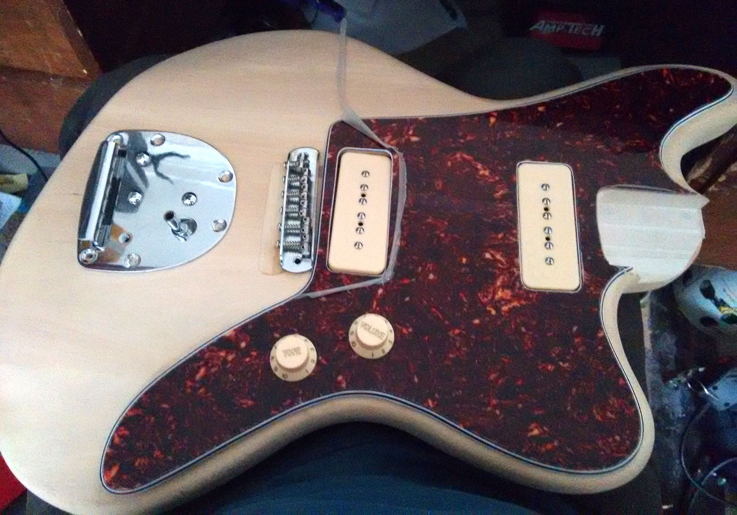

Bit more work today, pick guard design testing. I also did another pass over the frets and cleaned up and re oiled the board (excuse the dust).
https://i.imgur.com/PLyZgQH.jpg
https://i.imgur.com/iQJjZoD.jpg
I'd almost be convinced to do white/white perloid 3 ply based on this... tough decision.

I opted to change the switch to a Gibson style toggle, but seeing as I have yet to drill the hole...
Also considered using the metal switch plate but decided on the 'Jazzmaster' pickguard configuration.
