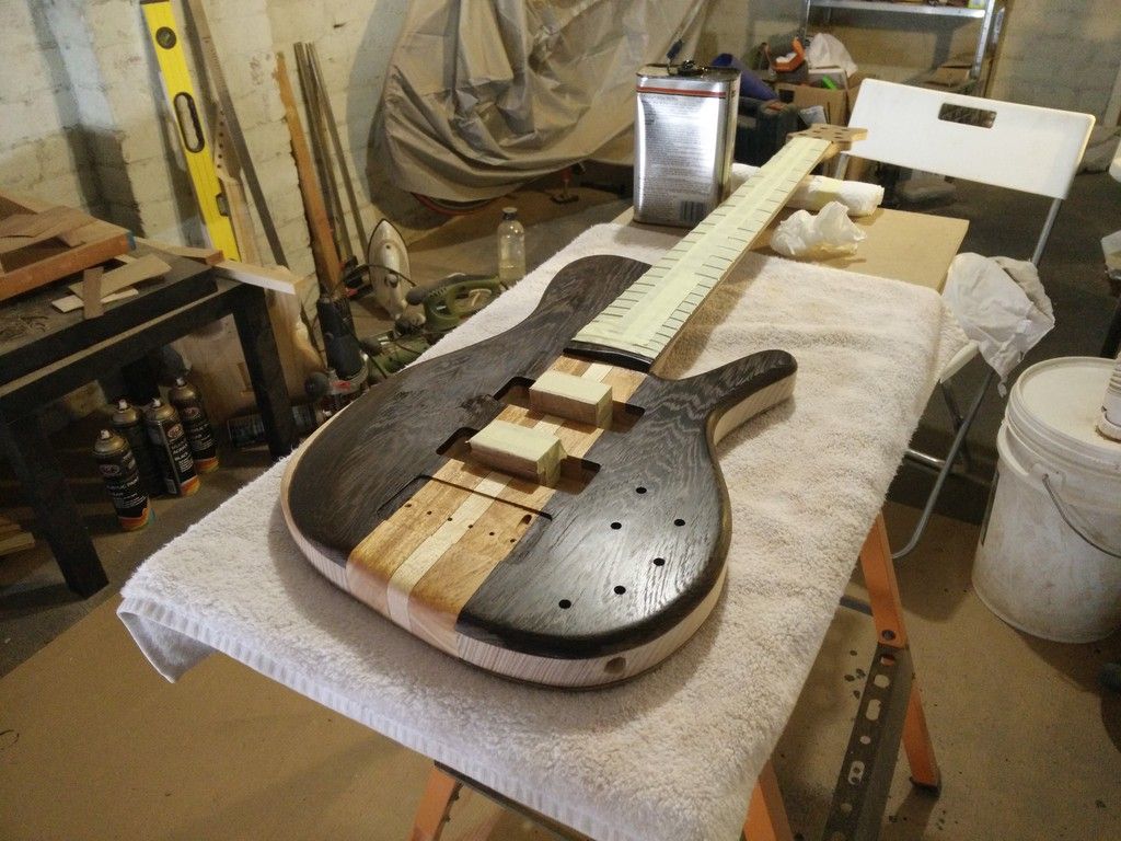

With some mineral spirits applied. The wenge became really dark so I think I'll have to sand to a higher grit and hopefully that won't make it too dark when the oil is applied.

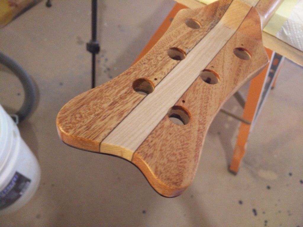

Almost there! I'm doing the headstock inlays tomorrow and will have to make a truss rod cover. I already made some matching wooden knobs and hopefully they'll turn out nice.
And then I have to wait for the machine heads to come before I can complete the headstock. Then it's the finish sanding and finishing!

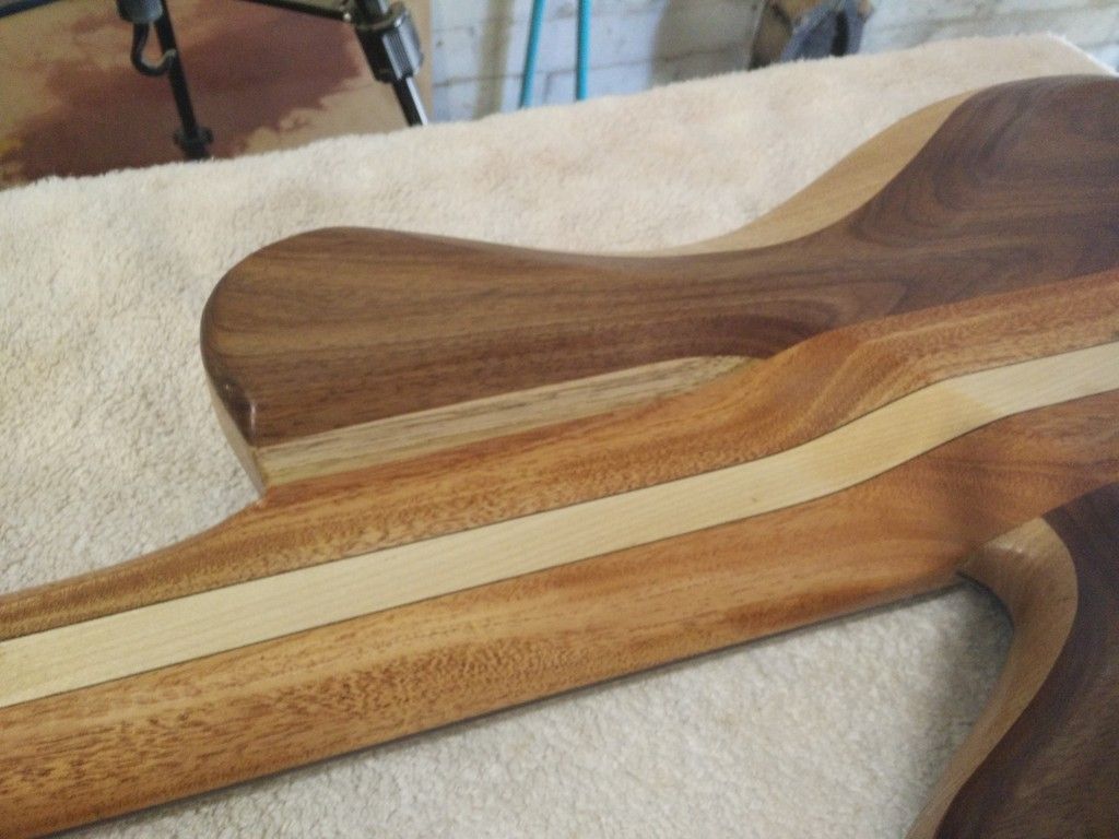

Then I also had to get rid of excess wood on the neck heel. I'm going for an all-access neck heel which would allow me to easily get up to the 24th fret despite it being a single cut. You may have seen the pictures from my previous posts and this is how I did it.
http://i23.photobucket.com/albums/b3...pszu8c1y96.png

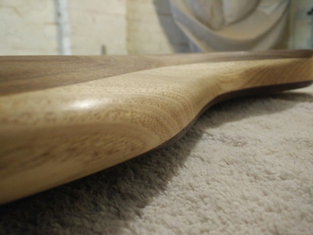

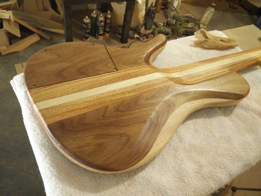

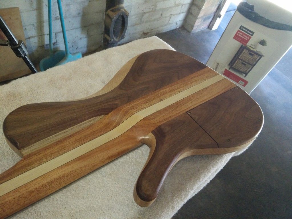

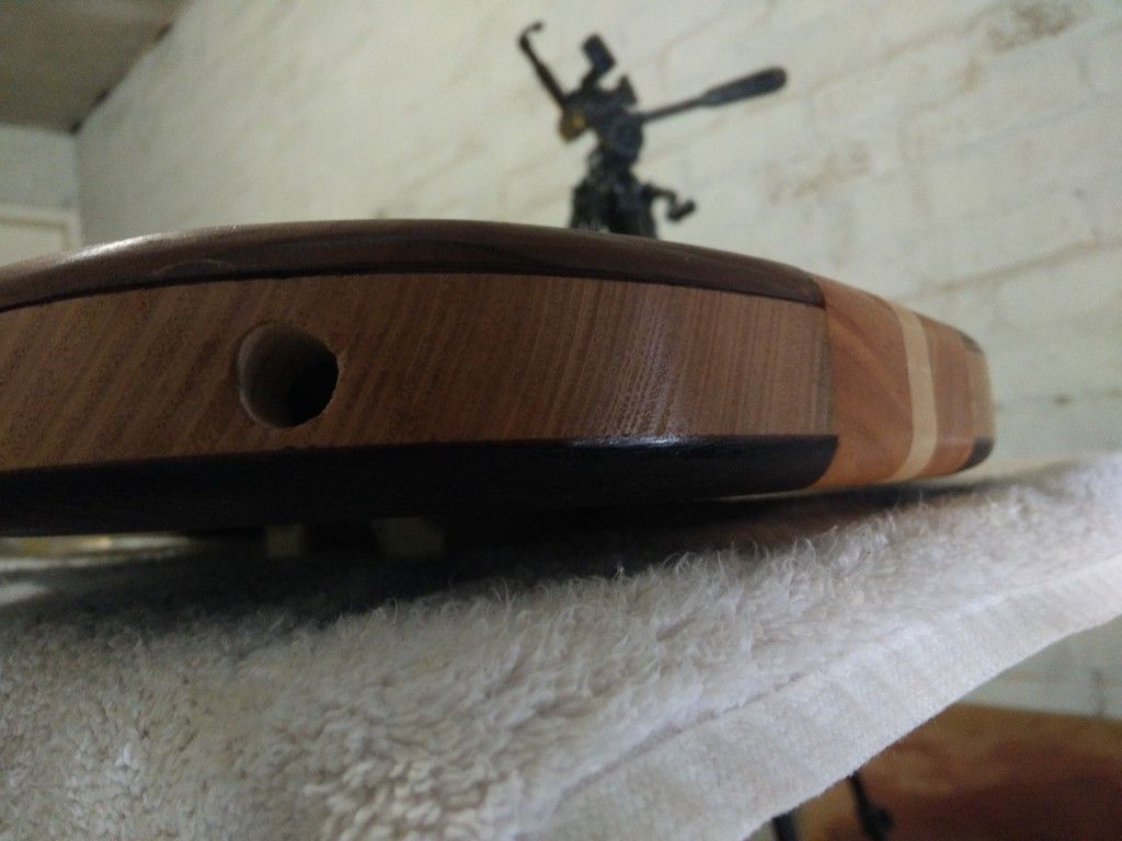

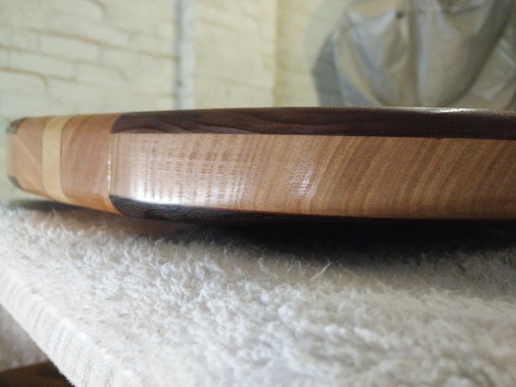

Ok I've been spending the last few days sanding and sanding and sanding...Sigh I really, really hate sanding. But it's important to get a great finish!
This is after one coat of wipe on poly...
http://i23.photobucket.com/albums/b3...psab2yu7xf.jpg
http://i23.photobucket.com/albums/b3...pstsdcmh0p.jpg
http://i23.photobucket.com/albums/b3...ps8yhsdpam.jpg
http://i23.photobucket.com/albums/b3...psblvgpskg.jpg
http://i23.photobucket.com/albums/b3...pssg8yxuje.jpg
http://i23.photobucket.com/albums/b3...ps0nz3n7mv.jpg
http://i23.photobucket.com/albums/b3...pswvauyreq.jpg
http://i23.photobucket.com/albums/b3...pseefnglvo.jpg
There are a few spots where the tear outs were which I couldn't fix well enough. Also some glue spots in the tight corners which I can't be bothered to get rid of. It's been a long two months and I have to finish this project. Other than that, I am very pleased with how this turned out. Definitely the hardest project to date but worth it.

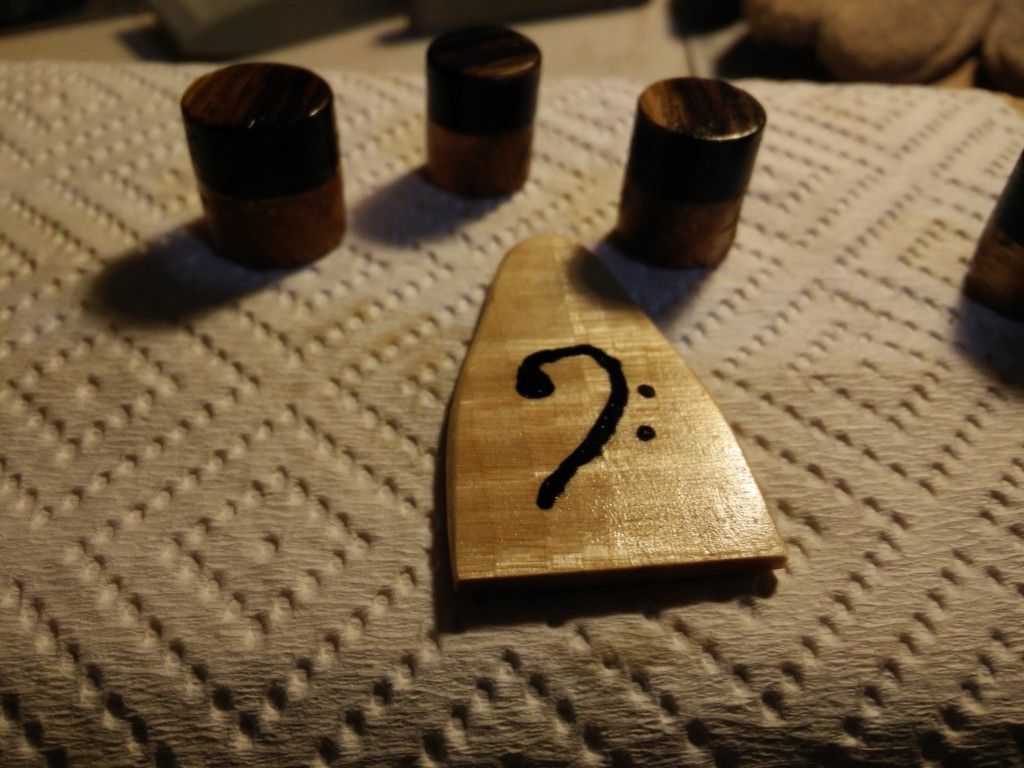

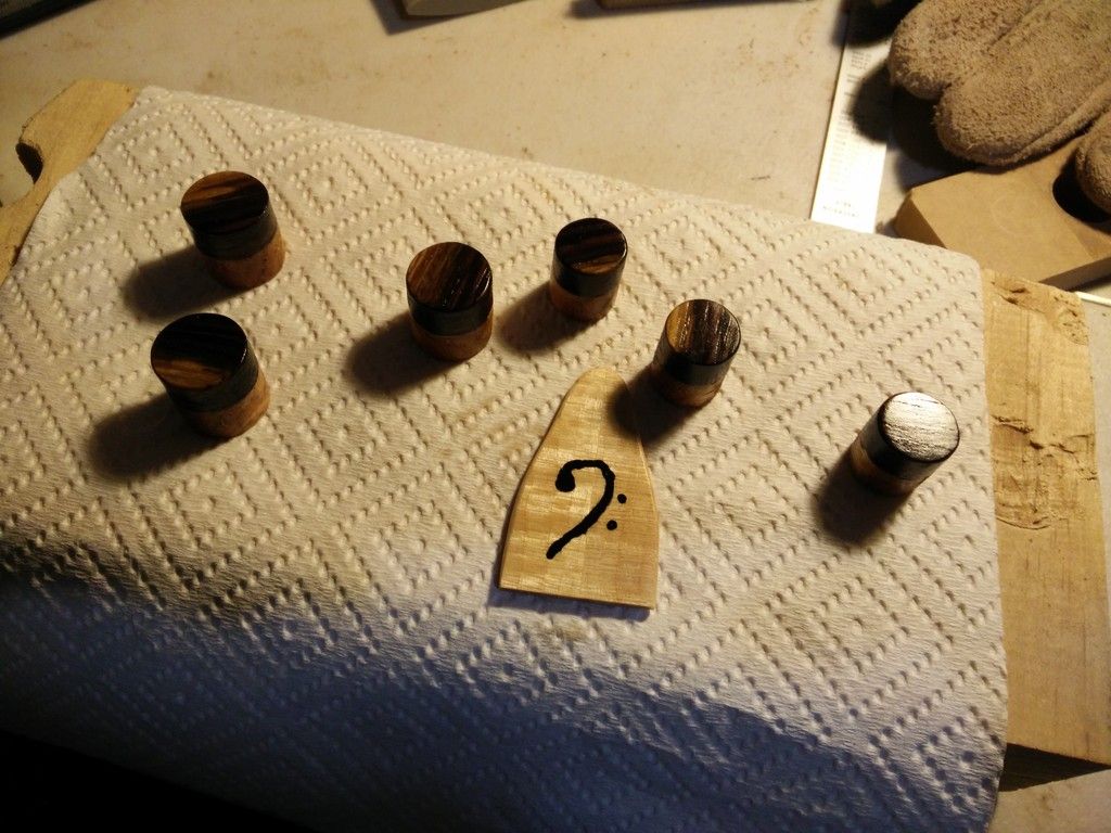

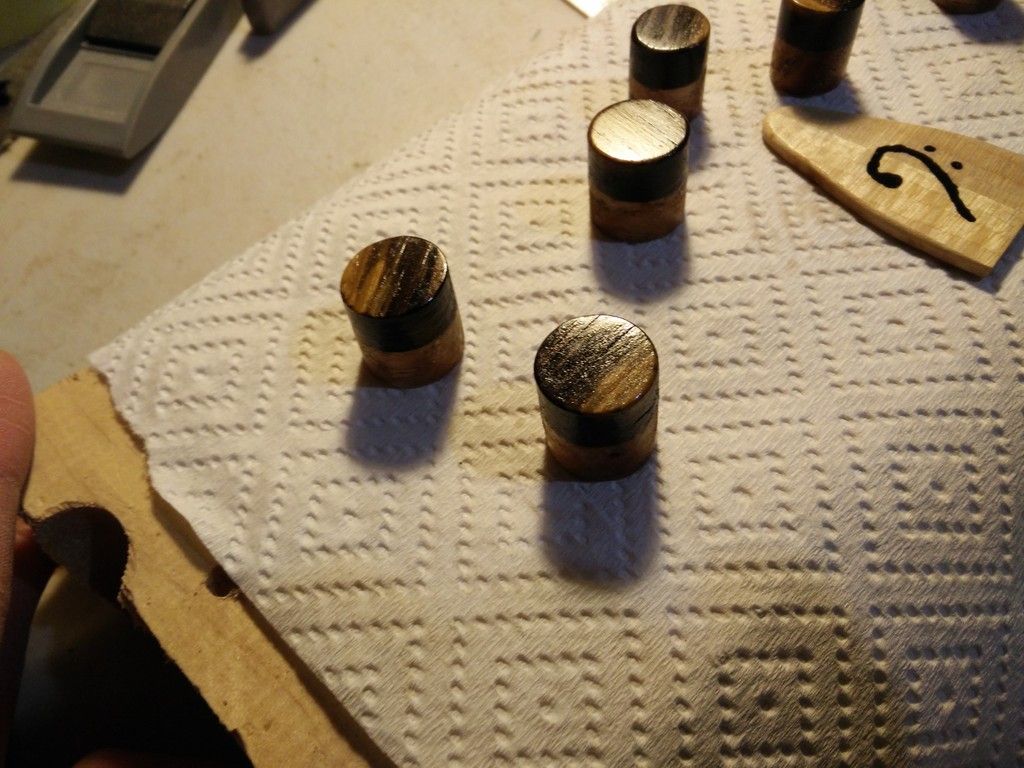

I also made matching wenge/vic ash knobs and a flamed maple truss rod cover.
http://i23.photobucket.com/albums/b3...pso7e0ro5f.jpg
http://i23.photobucket.com/albums/b3...psa4qcr2rd.jpg
http://i23.photobucket.com/albums/b3...psmfhdwa4f.jpg
on the home stretch now Simon it's looking like a real piece of art. Love the knobs and truss rod cover. How did you shape the knobs and did you glue the wenge to the vic ash ?
ah ok I'll remember that technique Simon cheers, so it must have been the smallest hole saw you used about 18mm diameter ?
