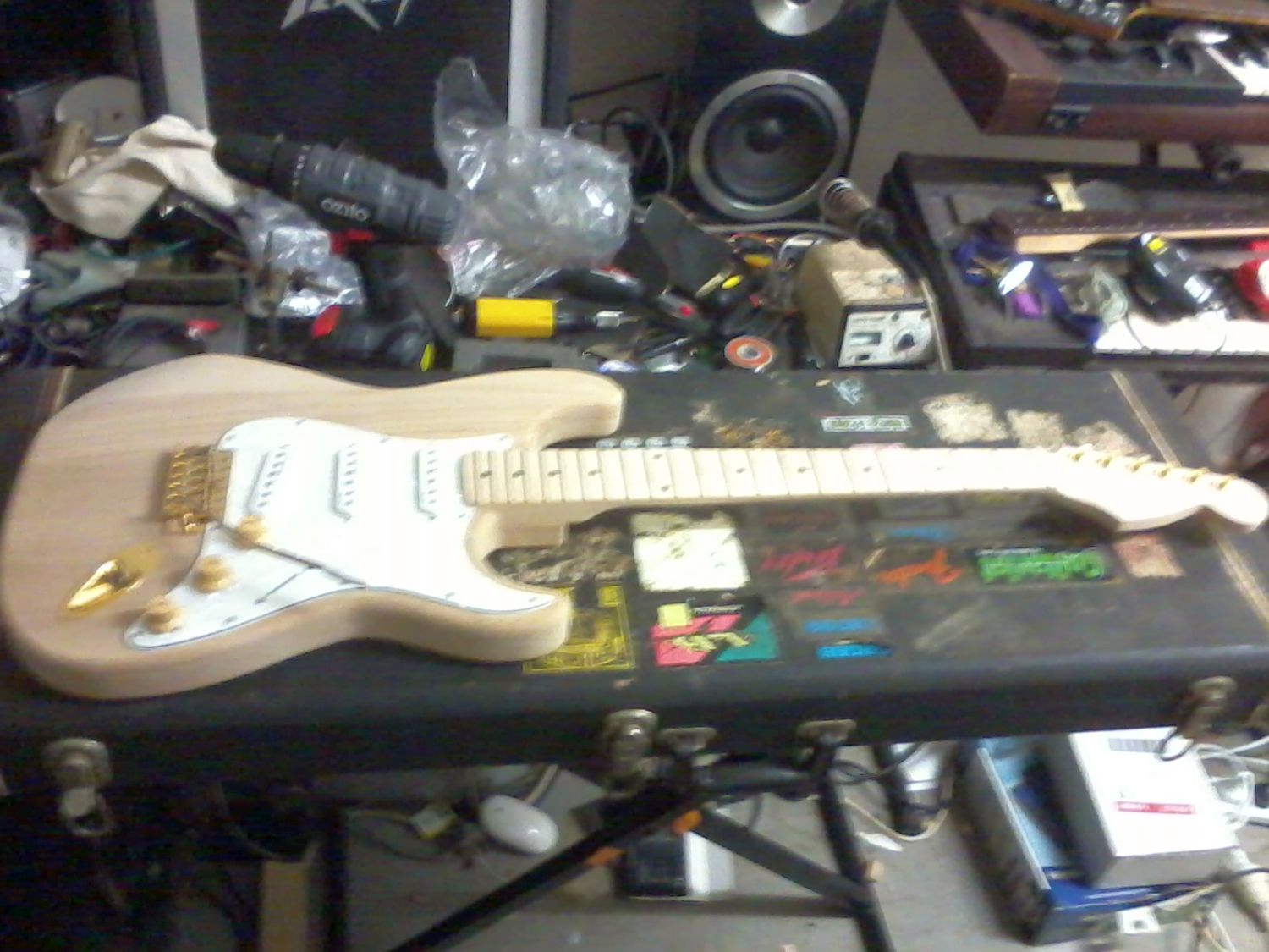

I've just finished installing the three 250K CTS Pots on the scratchplate, and put the knobs I found on the pots, even without the 5-way Pickup Selector, this guitar is looking good.
While i was looking through my bits and pieces, i found some 360 grit sandpaper and used it to get rid of some red pen marks on the rounded edge of the headstock, I'm happy with the way the headstock has turned out so I reckon i am well and truly ready to do some sanding, sanding,sanding, sanding.....yet more sanding, and when I think I've sanded enough....some more sanding.
I'm going to go with wokka's suggestion of using some Ebony Timbermate on the body (assuming the Big Green Shed has some in stock), and will be staining the body in Coolangatta Gold MK II once I get it from Dingobass, along with the Gold Highlights, so we'll lock that in as my official plan for this build.
Still looking for my Samsung Galaxy Y Phone so stay tuned for more updates where I'll post a new pic of the body.
I swear the more I work on the guitar the better it seems to look, maybe it's just my imagination but you never know.
Finally managed to find my Samsung Galaxy Y Phone so here's a pic of my guitar with the 250K CTS pots and their knobs installed on the scratchplate, I think the colour of the knobs does work with the colour of the scratchplate.

mock build looks great Doc, pity the pic was a bit out of focus
ebony timbermate on ash will make that grain pop twice as much. 2 x 250g will be heaps
I'm definitely going to have to do something about getting a replacement for my old Canon A480 Digital Camera, my Samsung Galaxy Y phone's camera is not really cutting it, will see if I can get a new camera soon.
I'm happy with how the mock build went, since I found no real major issues, so I reckon I'm ready for the next stage in the build process, I'll have to order some PBG Luthier supplies which'll probably mean another two week wait till I can start, not to worry.
