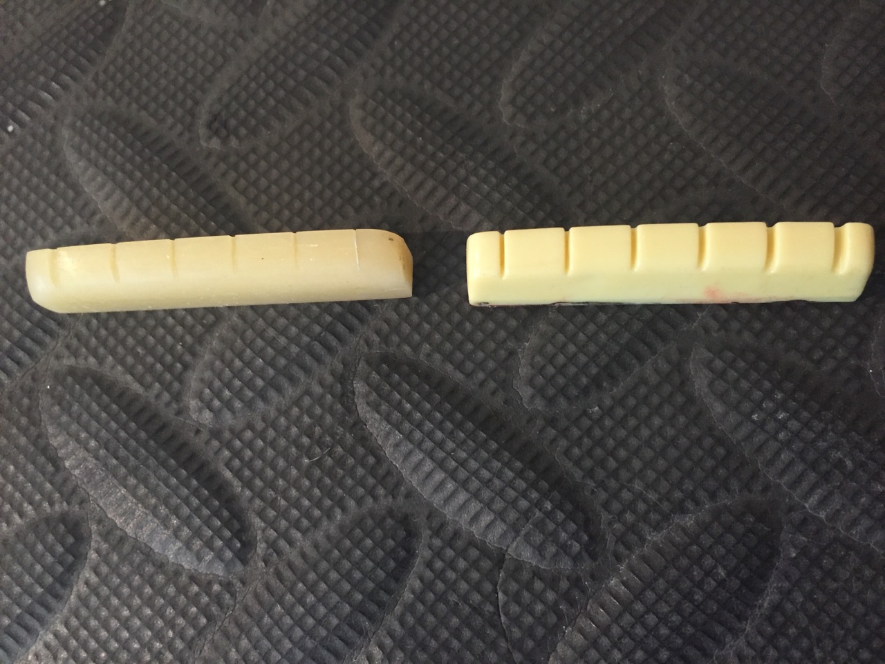

Hi guys,
I think I got sent a left handed bone nut by mistake. You can see it alongside the plastic one in the pic. For all intents and purposes the nuts look the same except for the size of the slots.
Attachment 9470
I don't have any nut files, what should I do? is there a fix
Hi Andy, DB must have been half asleep when he sent it, the bone nut is definitely slotted for a lefty.
Send DB an email and ask for a righty slotted nut. He may want you to post the lefty back to him
there is no fix, you can't turn a 0.046" slot into a 0.010" slot haha
Play ambidextrous, i do :D
I see your point Wokks. I'll send him an email. Cheers.

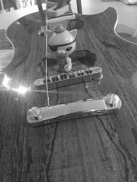

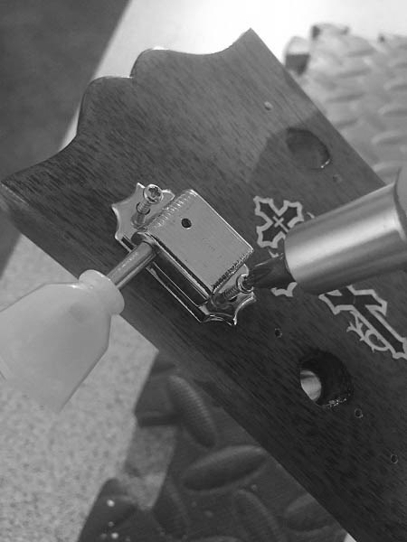

Alright...well while I am waiting a right handed bone nut (thanks for sorting that out DB and Ads) I re-glued the plastic one, so I could fit my Klusons and set the neck!!!!
Attachment 9527Attachment 9528
Yes....I've gone B&W to keep a bit of mystery with the colour effect....sorry Wokks
Ohhhh, looks nice, PM sent re lefty bone nut...

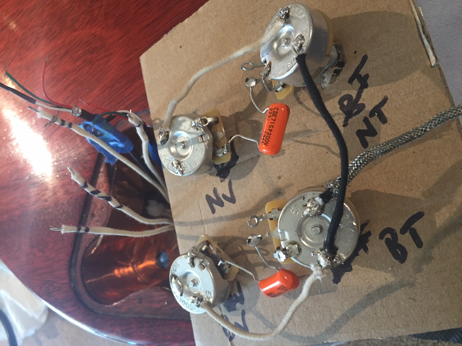

All electrics done. I am waiting for the day my luck runs out. This is the second kit I have wired from scratch and its worked first time.
Summary:-
Tonerider Alnico Classic 2's
all vintage cloth wiring
Switchcraft Jack
CTS vintage 500k pots
copper shielding
Gold toggle switch
Attachment 9690Attachment 9691Attachment 9692

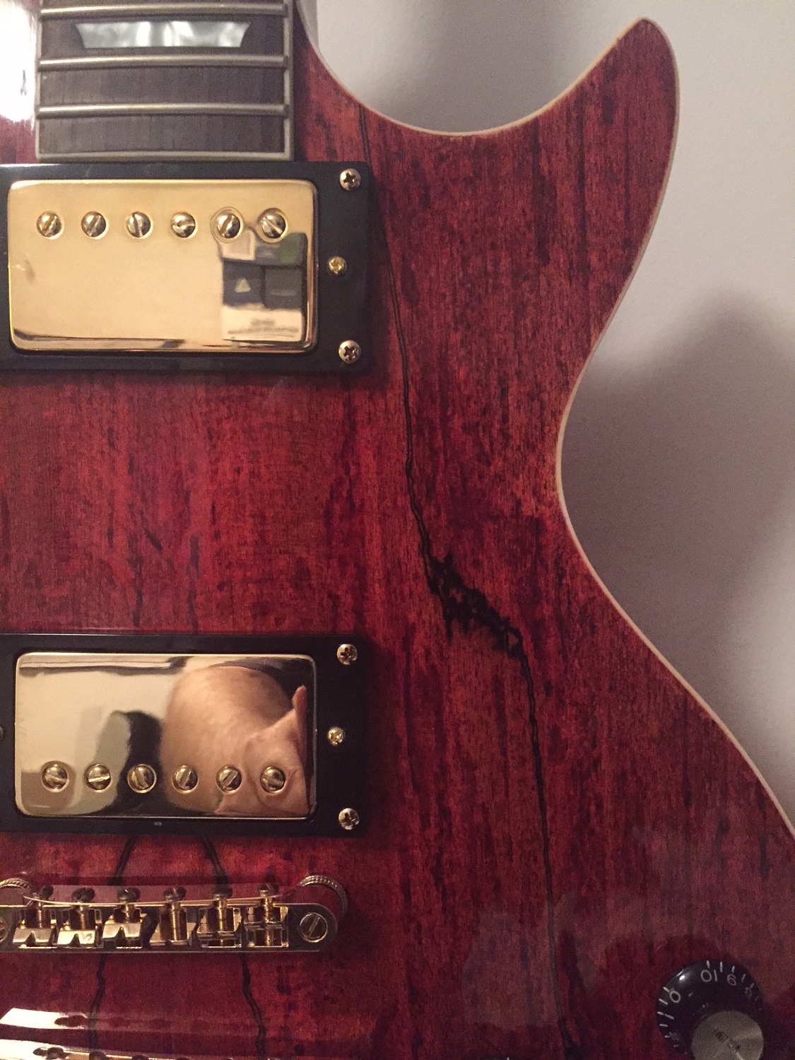

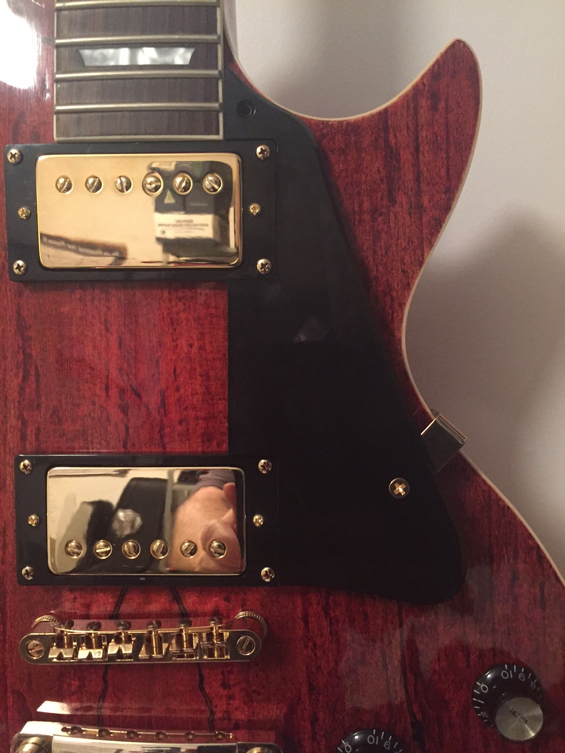

Alright guys....stuff the black and whites....I need help....I really cannot decide...
Pickguard or no pickguard?
Attachment 9693Attachment 9694
I'd leave it off. Unless you put some gold text on the guard (kinda like Gretsch do)
Another off from me
First thing I did when I bought an Epi Les Paul was took off the PG. I hate 'em.
And why would you want to cover up ANY of that gorgeous wood?
Agree with everyone else to ditch the scratch plate as It would hide a big part of the spalt.
Looking good with the gold hardware.
Off for me
Based on those two pictures, I'm leaning towards putting the pickguard on. Might change my mind if the pics were of the whole body.
Agreed Frets, need whole body pics to decide.
Here's something from left of centre... What about a white PG?
Interesting idea Muzz. OK well today I've strung her up and checked the intonation. With the exception of the nut height it was good. Its well in tune with open strings and from 5th fret up and no buzz. Open chords sound bad. I reckon its the nut height. after fretting at the third I could drive a truck on the first fret wire!
I've de-strung and removed the nut. will sand it down to size, re-assemble and try again over easter.
I also got finger prints of glue on the finish after setting the neck so im going to have to sand back, maybe apply some more tru oil wait and re-polish in a few weeks time.
Once assembled in some state of a guitar I will take full body pics with and without the PG and see where we are at.:cool:

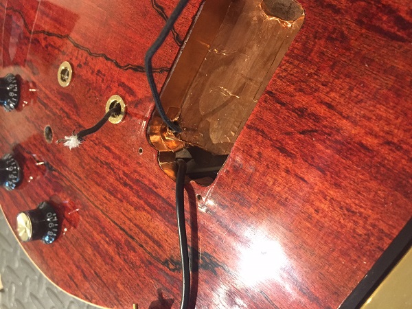

Update and Question
Ok, I've got the nut in perfect position and the guitar is intonated and works.
Except for the incessant hummmm. The hum goes away if I touch the switch or humbuckers and works perfectly.
I've wired the guitar in line with the Tonerider diagram (which is too big to load). The only exception is that its shielded with copper tape.
I did not ground it to the bridge because the diagram didn't say to do that.
I am guessing thats my problem?
Ground to bridge mate it also grounds the strings, that will be the problem.
I'll give it a got, thanks Tony
Ok so I looked everywhere for a hole in the control cavity that goes to the stoptail mount. It was difficult as I had already copper taped. I did find a small hole near the neck vol pot. however it did not go all the way through. As I already had installed the bushings I couldn't drill a hole like in Ads video with the SG.
Instead I drilled a hole from the bridge pup rout to the saddle mount hole. As the PBG bushings are hollow I fed the wire up through the bushing and soldered it on the bottom of the bridge mount then screwed it back in twisting the wire with it. I then fed the other end into the control cavity and soldered it to the pot to earth.
All I can say is it works so far!
