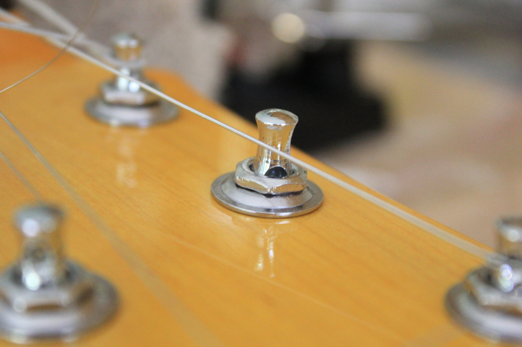

Anyway I found the missing screws and bushings. Can anyone guess where?? Yes - stuck to the back of the pickup :P. Anyway I got the tuners installed but unfortunately one of the tuners is deformed and has the hole drilled way too low
Attachment 8474
I managed to squeeze the string through with a little coaxing, but I'll see if Ads maybe has a replacement lying around somewhere.

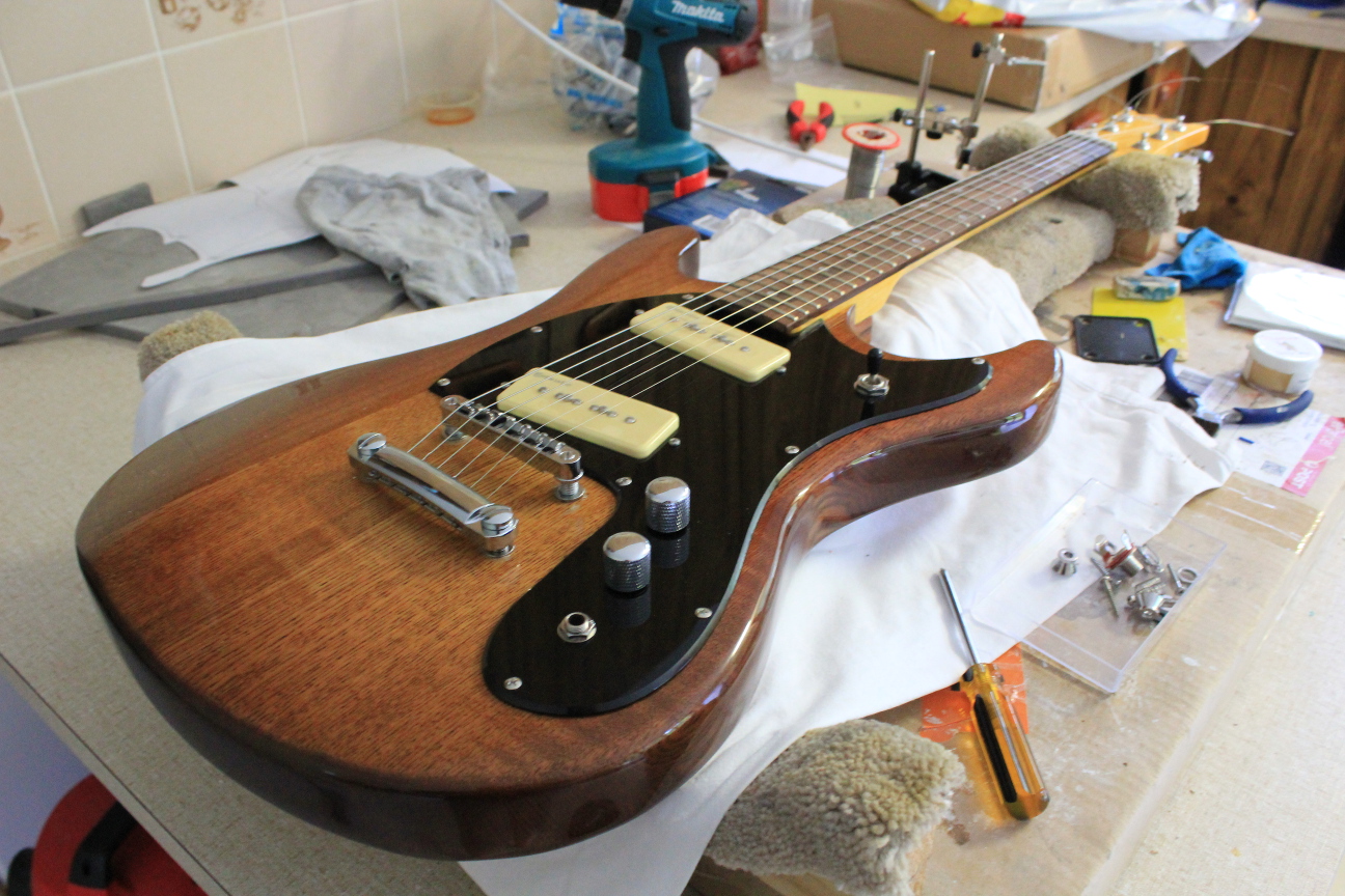

It's pretty cool having her strung up now. I need to do a complete neck overhaul, but I just wanted to see how she looked :).

Wow Gav, she's turned out to be a stunner. Love the colour mate.
Thanks @Rob!
thats come up a treat Gav, very nice looking Mozzy, can't wait to hear those P90s
Thanks Wokks. It's been a bit of a struggle this one, and it doesn't look quite as nice up close ;) but I'm glad it's finally getting there. I really want to hear the pups too! Very soon I hope.
