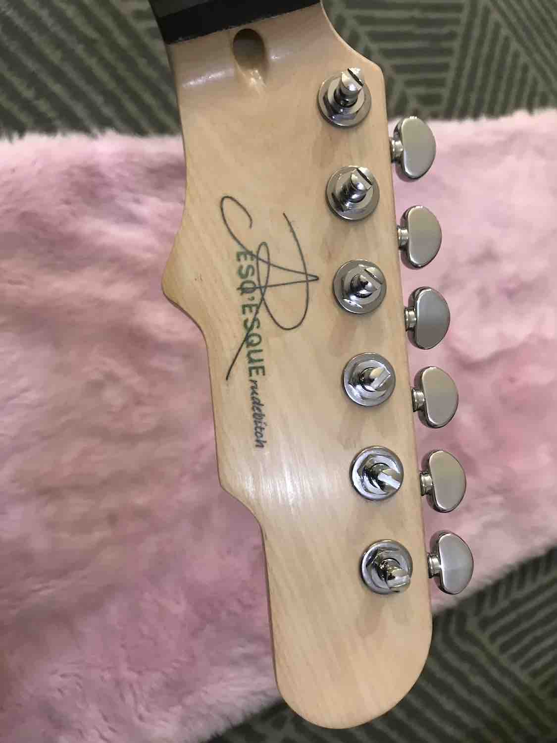

I wonder about the tuners as well..... how "snug" (a tight fit) are they supposed to be?
it they are to fit in snug to the point where they cannot "wriggle" - that might be the problem - because they are not that snug....
I've just placed the Grovers into the second neck... and there was a bit of wriggle room (I can't remember if it was the same for the first neck, which have the "standard" tuners in)- so if they are supposed to be snug the holes in the headstock are up to 1/5 millimetre or so too big.
If you don't think the tuners are snug enough you can wrap the shaft (B in the pic) with aluminum or copper tape (what you'd use for shielding). It's stiff and won't flex, so should work pretty well.
Attachment 45715
That said, I have some that are not that snug and don't rattle at all. When in tune, the string pulls the tuner snug against the wall of the hole, so it should not cause a rattle. The part of the tuner that does often rattle is the nut (A in the pic). I spent a couple of weeks looking for a rattle in my acoustic, only to discover that I just needed to tighten down the nut on the tuners.

the shieding tape wrapped around the tuners did help too.

Glad that the shielding tape worked! It took me an embarrassing amount of time to realize how much easier that would be than dowelling and re-drilling.

The shilding tape doesn't ensure a "perfect fit" but it does stop the movement substantially (before the screw is put in).
YT=Youtube.
Perfect fit isn't necessary with the tuners that use a nut (as opposed to push-in ferules), IMHO ;-)

Well it's been a while - I've had a few things to get done - and some waiting to do (still waiting on the pickup - a cheap Filtertron - type).
Once I have everything - I can finish routing and throw a white stain and finish on it
I have now completed the neck - putting a "logo of sorts and a finish on it.
The finish has a slight amount of a white tint in it - I wanted to keep the "new" maple colour rather than the yellow" that it turns into.
In hindsight I might have put a black stain on it and sanded it back - but that's an experiment for later?
