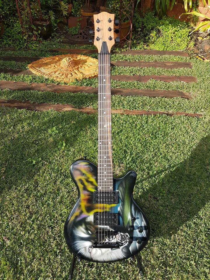

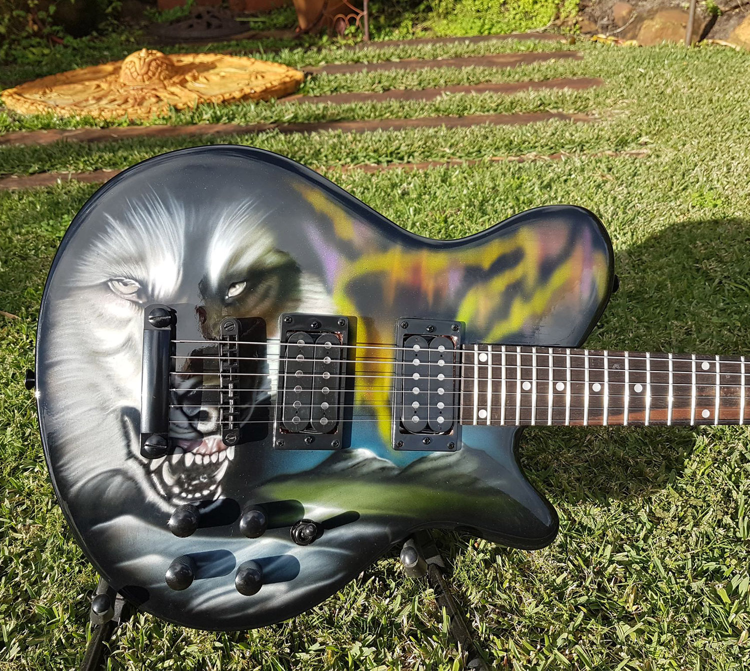

After a few wiring problems which luckily ended up being easy to fix.. I finally finished the last details of the guitar today. Really happy with how this turned out and cant thank all of you enough for the help and advice you have given me. Will most probably put better pickups etc on this as Im really happy with how it is playing but all in good time :)
Attachment 27241Attachment 27242Attachment 27243Attachment 27244Attachment 27245
That flecked finish is very impressive - it looks about an inch deep. :)
That turned out really well. The bridge and tailpiece aren't as much of an obstruction as they could have been.
