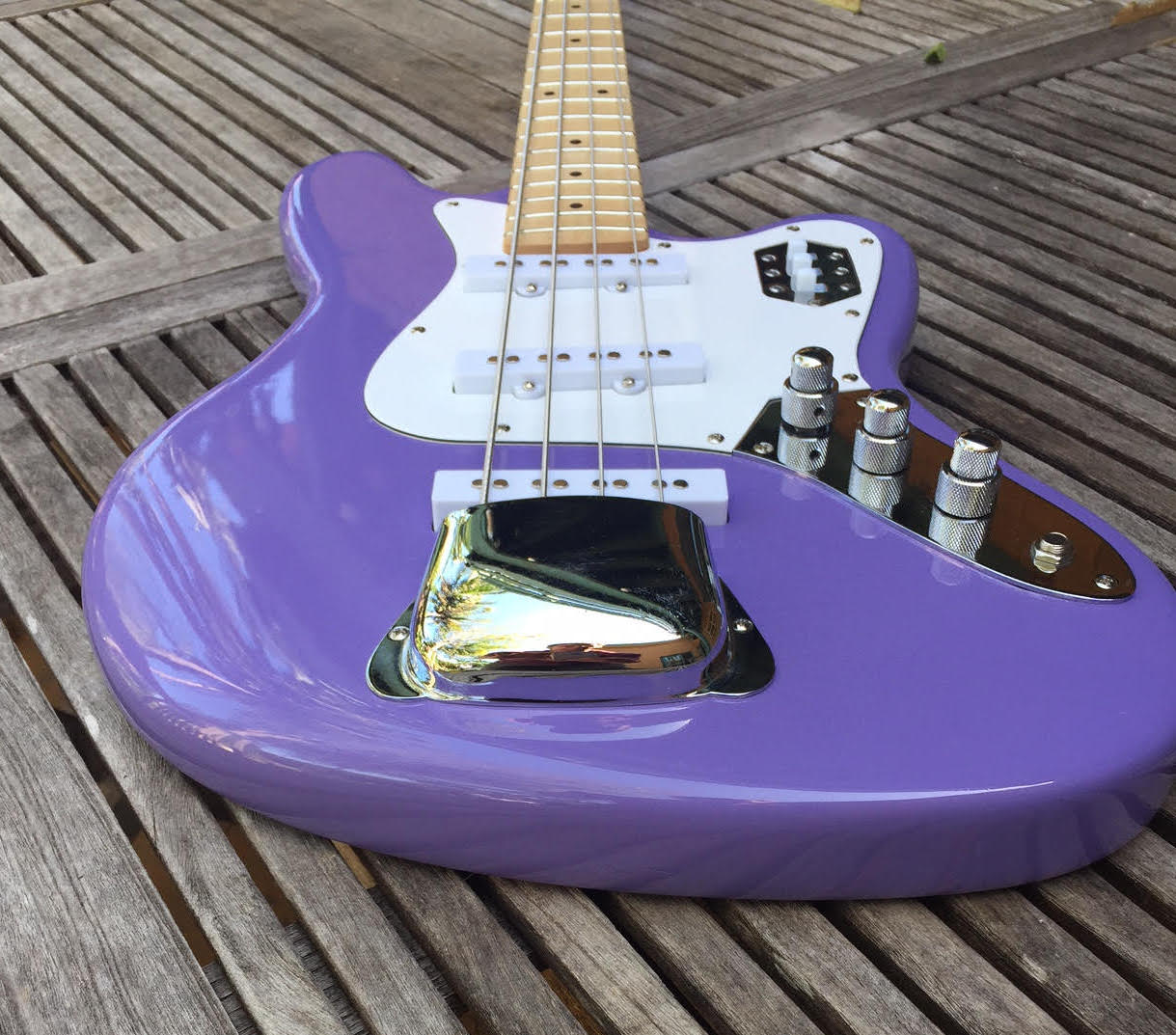

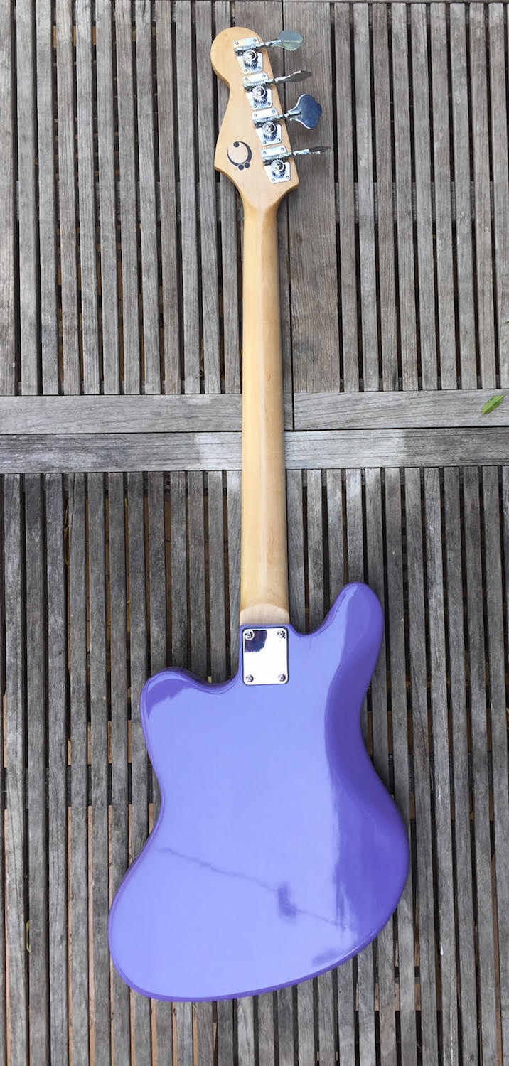

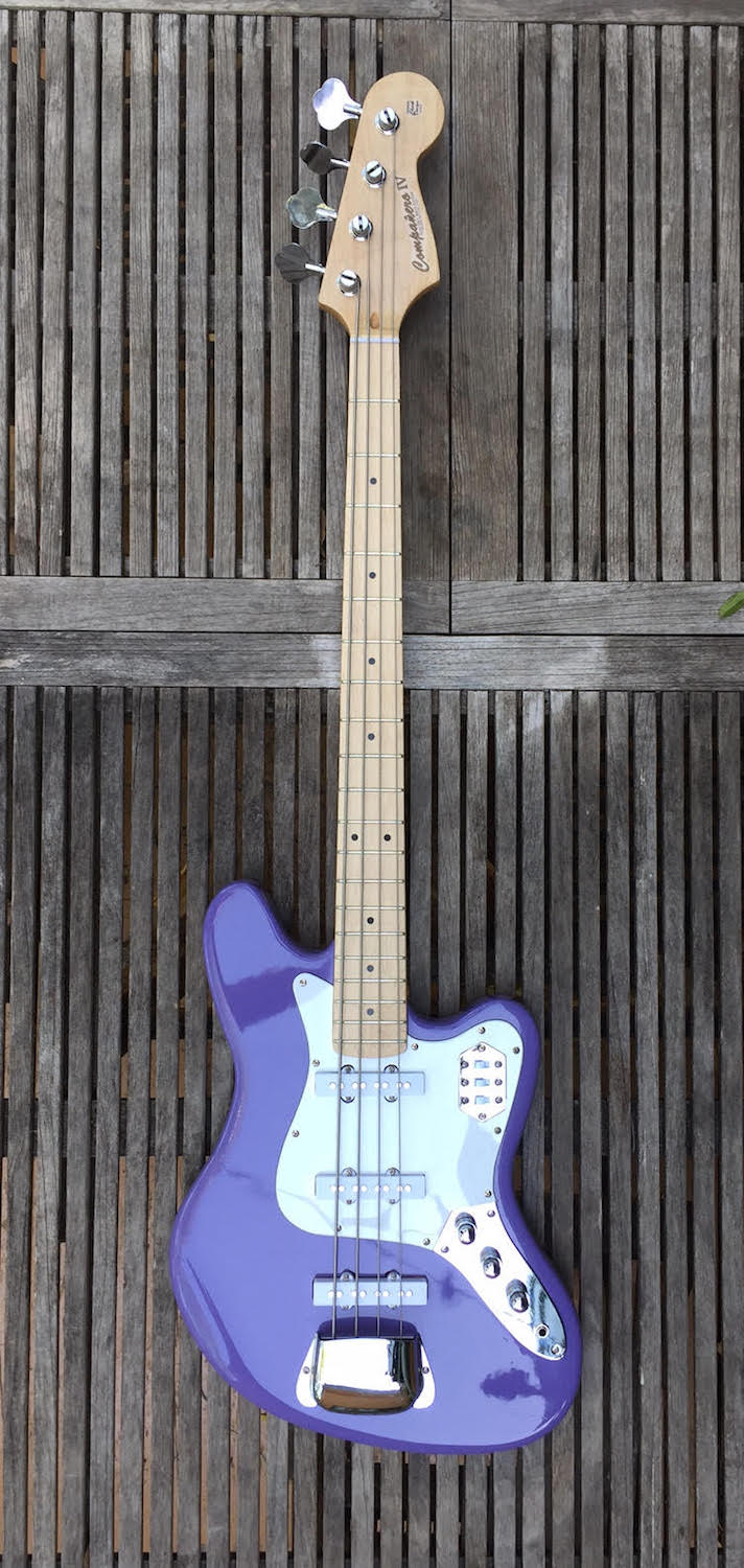

Off the back of Stan’s LP build I figured too much purple is barely enough so here’s my JB-4M kit!
The build diary is here, but these are the basics:
Stock JB-4M kit, with the shape modified to a more offset/Bass VI style. Finished with MTN94 RV-173 Ultraviolet rattle cans and clear coated with White Knight Crystal Clear Acrylic. Fitted with Jaguar style switch plate that acts as an on/off switch for each of the three jazz pickups (I bought two sets of cheap Jazz pickups with white covers off ebay), with each pickup having a dedicated stacked concentric pot controlling volume and tone. Custom cut pickguard, replica P-bass ashtray bridge cover over a knock-off Badass style bridge. Neck finished with Naughty Oil, and fretboard with Dingotone Wax. The thing I’m most pleased about is that it delivers on my original vision: to get a variety of tonal mixes between the pickups, although it’ll take me a while to dial in/get to know the best settings!
Attachment 15695Attachment 15696Attachment 15697Attachment 15698
Stunning work Chuck
Yep, really nice build Chuck. That ashtray suits it nicely.
Thanks guys - and thank you in particular WeirdBits for your help on the wiring advice!!
