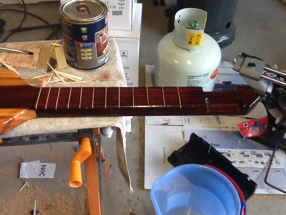

Hey Bruce I have to thank you mate, you have inspired me to build a similar lap steel but mine will be a baritone scale. I am hoping it will sound like a baritone guitar with heavier strings and a lower tune. Just want to try it out. I have glued the neck through piece together and after some sanding will glue the wings on and route the tuner post cavities. I'll post some pics soon !
BAttachment 16619
Whoops forgot the frets ...
More sanding and laquering ahead....
nice one Bruce, what are you using for the fret markers ? some sort of plastic ?
Balsa wood ,
Don't laugh ...
It was cheap , the right colour and easy to trim up.
ah ok good work Bruce, whatever works !
