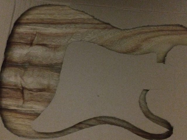

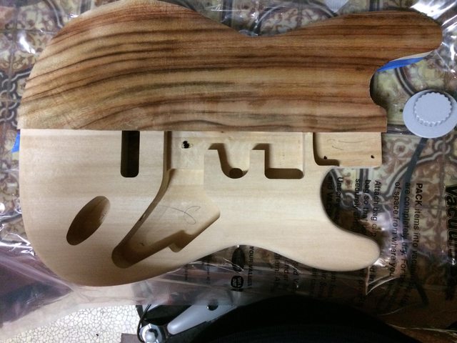

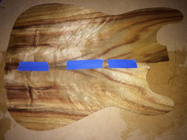

Template and cut the top section of the veneer. This was sprayed first with veneer softener.
Attachment 5123

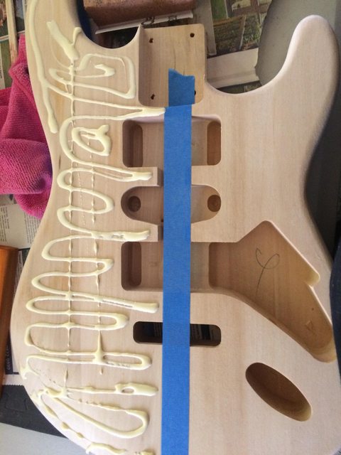

Apply glue. Titebond I.
Attachment 5124

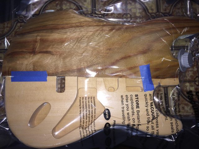

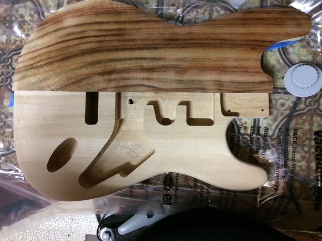

Vacuum press.
Attachment 5125

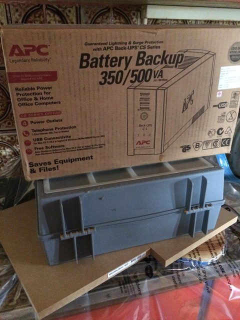

This is just a common vacuum storage bag and household vacuum cleaner. Wasn't going to lash out on a proper vacuum press and pump at this point.
and press...
Attachment 5126
(that heavy UPS I haven't been motivated enough to install finally has a use...)

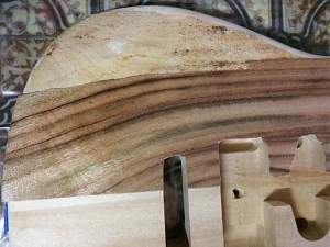

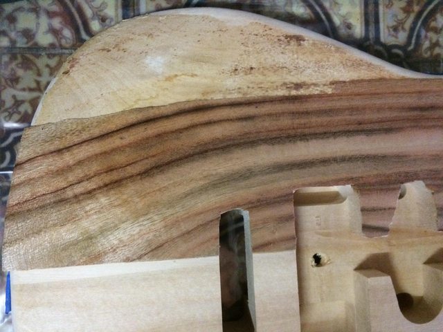

Removed from the press hours later.
Attachment 5127

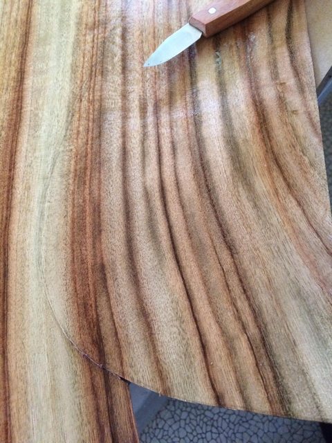

This is where I realised that at some point my template had gotten flipped over.
The straight grain was supposed to be at the end of the body with the curved grain under the pickguard.
It had a better look about it.
Tried to make the other section line up and look acceptable, but couldn't so it was time to select the undo function.
Steam to loosen the glue.
Attachment 5128
And peel...
Attachment 5129

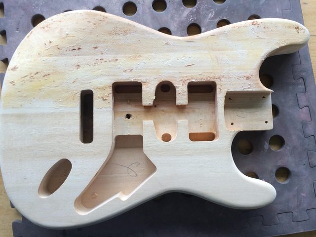

Some time later... a ST body with veneereal disease.
Attachment 5130
Some more work with a cabinet scraper and then some sanding cleaned it up well enough to provide a smooth surface for another attempt.

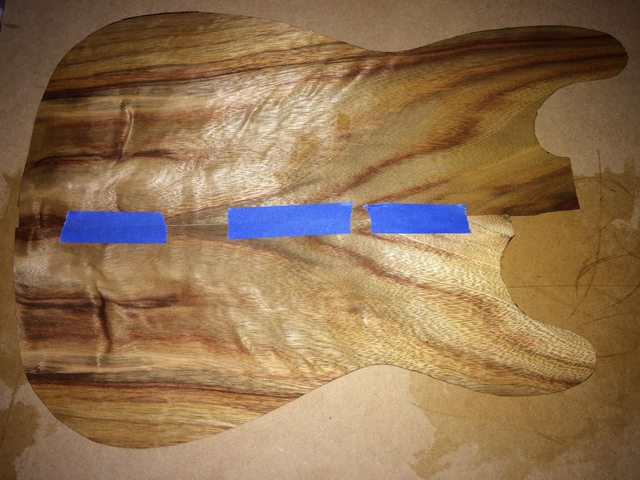

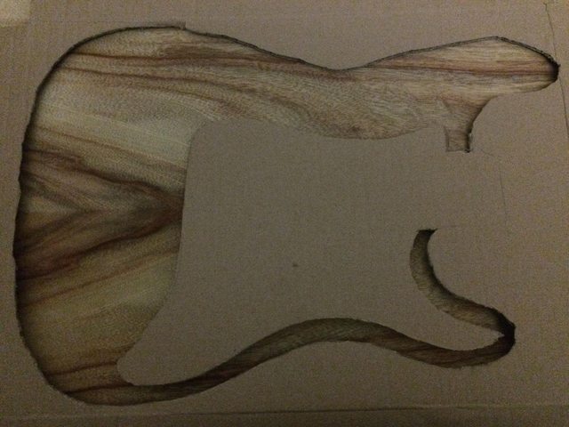

Cut properly this time, checked and checked again.
Attachment 5137

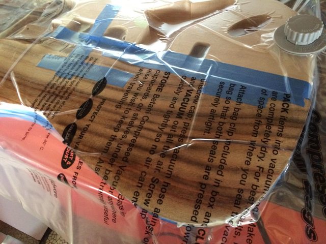

Into the vacuum bag.
Attachment 5138
Which was then pressed with MDF and clamps.

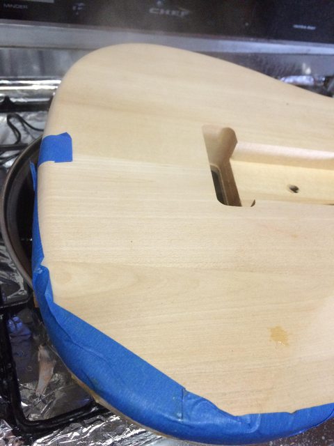

Top part glued, time for another visual check.
Attachment 5139
Still on track.
