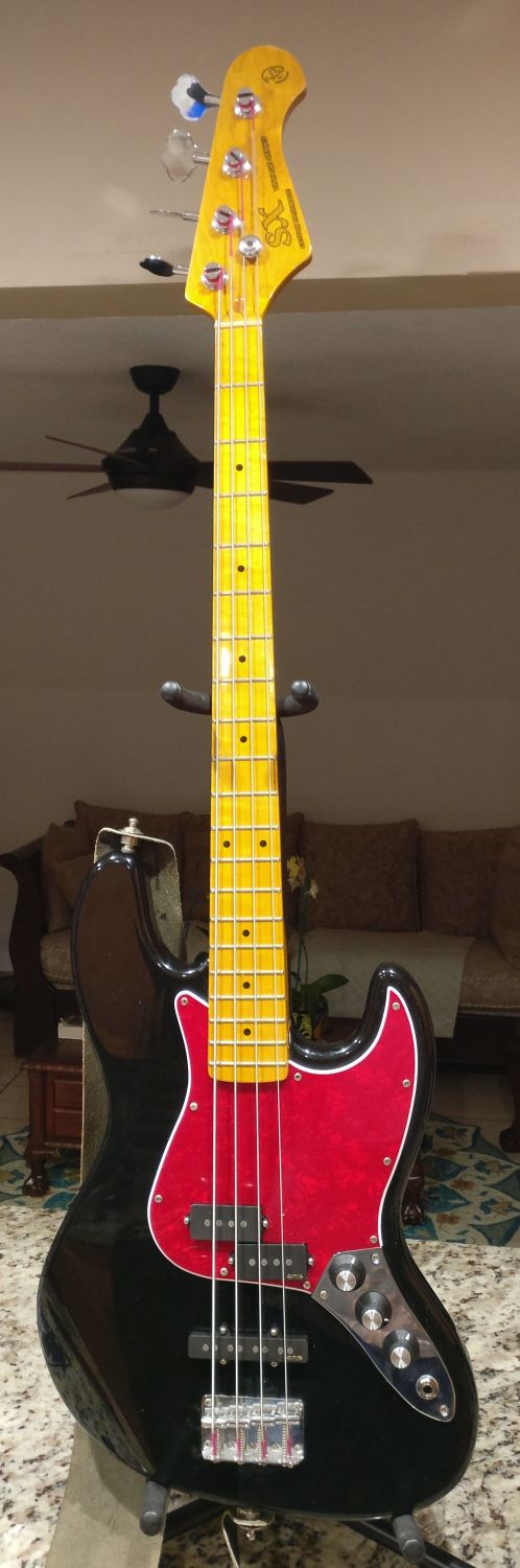

Of course if you're not getting the punch of your P-bass from your J-bass you can do what I did...
Attachment 44835
:cool:

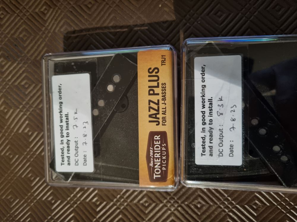

Fender3x, I have had thoughts of going the PJ route, I did upgrade the kit pickups. Had to open up the pockets slightly to get them to fit in there "real tone" pickups. I didn't use the kit pups at all, so I don't know what they are like. I could possibly use an EQ though another amp. I was just wondering if it were possible. Thanks.

Those should be fairly good if they are the ones that I see on the Realtone website. It looks like they are Toneriders? I haven't used them but they are popular here. For me "punch" tends to come by boosting the low mids. If you have an amp with a lot of EQ it would be worth a try. Or a cheap bass equalizer pedal. Of course you can only boost what's there. I had a set of DiMarzio J's once that I hoped I could dial in to sound like a p-bass. I finally decided that the only reliable way to get a p-bass sound might be from a p-bass pickup...and thus the bass in the pic got a bit of routing and a new pickguard ;-)
...the bass in the pic got a bone colored bone nut, however. Curious to see what black die might do to it... hmmm...

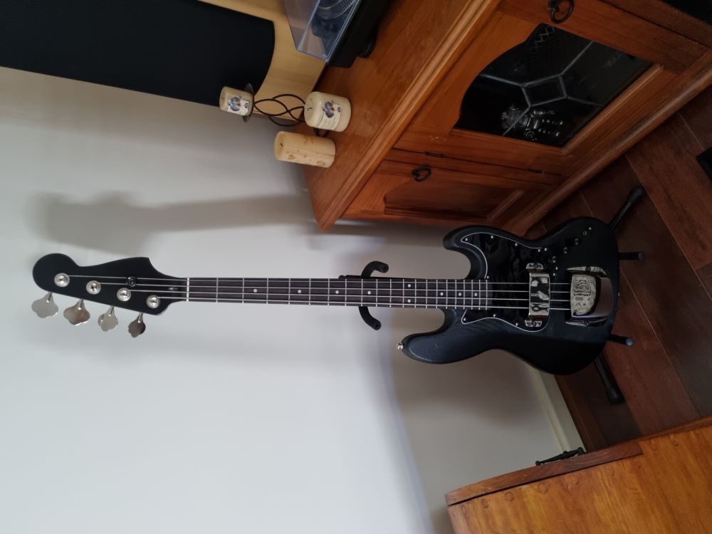

1 Attachment(s)
Yeah Rabbit I ordered a black nut with the kit, trying to keep with the Jetblack theme but I didnt like it, It made the first fret look like it didnt exist strings kind of disappeared over the top of the neck, if you know what I mean, so decided to go back to using the white bone nut. Im super happy with the way it finished and the chrome "bling" helped to highlight it. Attachment 44841

Attachment 44842 Tone riders are what they are, they work fine good tone control very clear output no issues with that a all Im just used to my Pbass with its extra punchy output.
