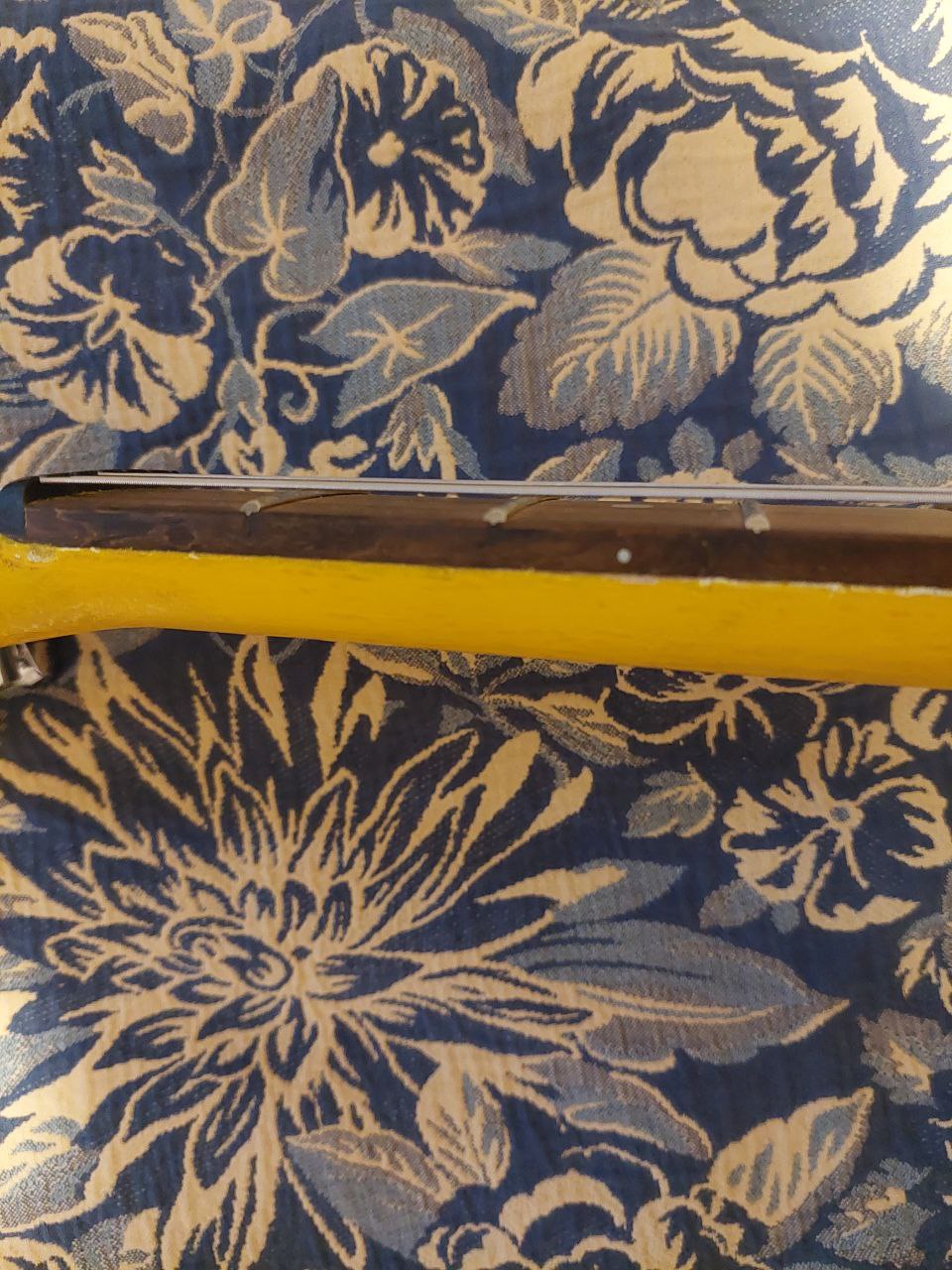

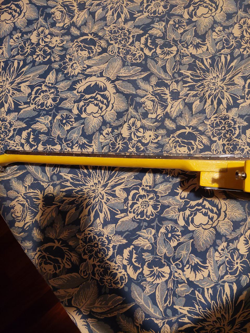

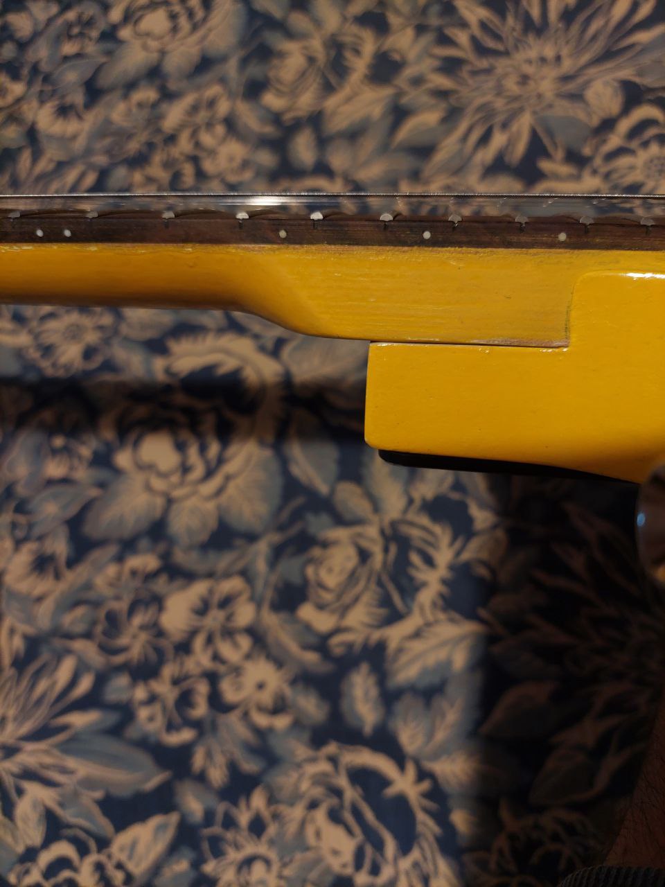

So I unscrewed the neck, sanded a bit the lower back part that touches the body and mounted all again, after a few days it got better, the neck settled a bit more and now there is a small buzz only in the first and second fret in low A and D strings but you can't hear it when you plug it to the amp - here some pics:
Attachment 44305 Attachment 44306 Attachment 44307
Attachment 44308 Attachment 44309
Truss-rod is still untight almost to the limit, if I push the first and last fret to check the neck relief the low E string touches the frets until the 6/7th fret after there is less than a mm of room, I think I'll leave it like that by now, looks like it works and it's playable, I am afraid of doing some damage.
I also rised the pickup a bit with some small cardboard shims in the right side (high strings side) because the volume was too low :D.

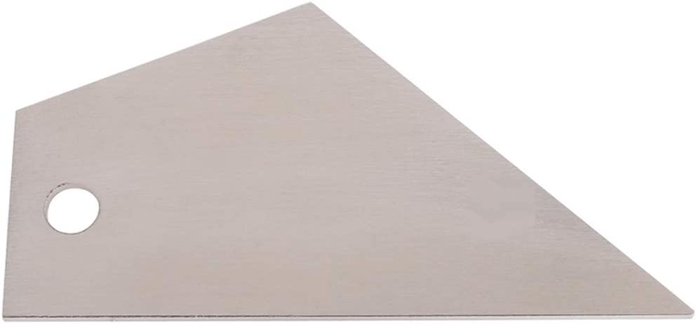

If you are not happy with the way the guitar plays...you might want to check if your frets are level. They usually need some work from the shop so if you have not done a fret leveling and crowning you might want to. You can check the fret level with one of these to see if any frets are standing a little proud.
Attachment 44311
You can get these under $8 US on Amazon if you don't have one.
