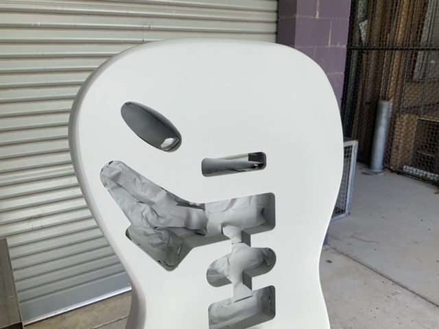

Found quite a few spots where wood grain waves were noticable. So I sanded back with 100 something or other and 240 and 300 something or other sandpaper. Nearly took it all the way back so that I would have all the grain filled. Didn’t take an upside down or sideways picture for that.
I’ve then second coated SCA Primer Filler with better results all around. Still need more attention getting one line of machining out and a couple spots of grain waves.
Here’s some pics in random orientations.
Attachment 35223
Attachment 35224
Attachment 35225
Attachment 35226
Attachment 35227

Another round of primer filler producing better results. May sand back one more time and hit with one more prime filler before I start priming and painting. Still having issues with photo orientation despite taking them right side up on the phone...
