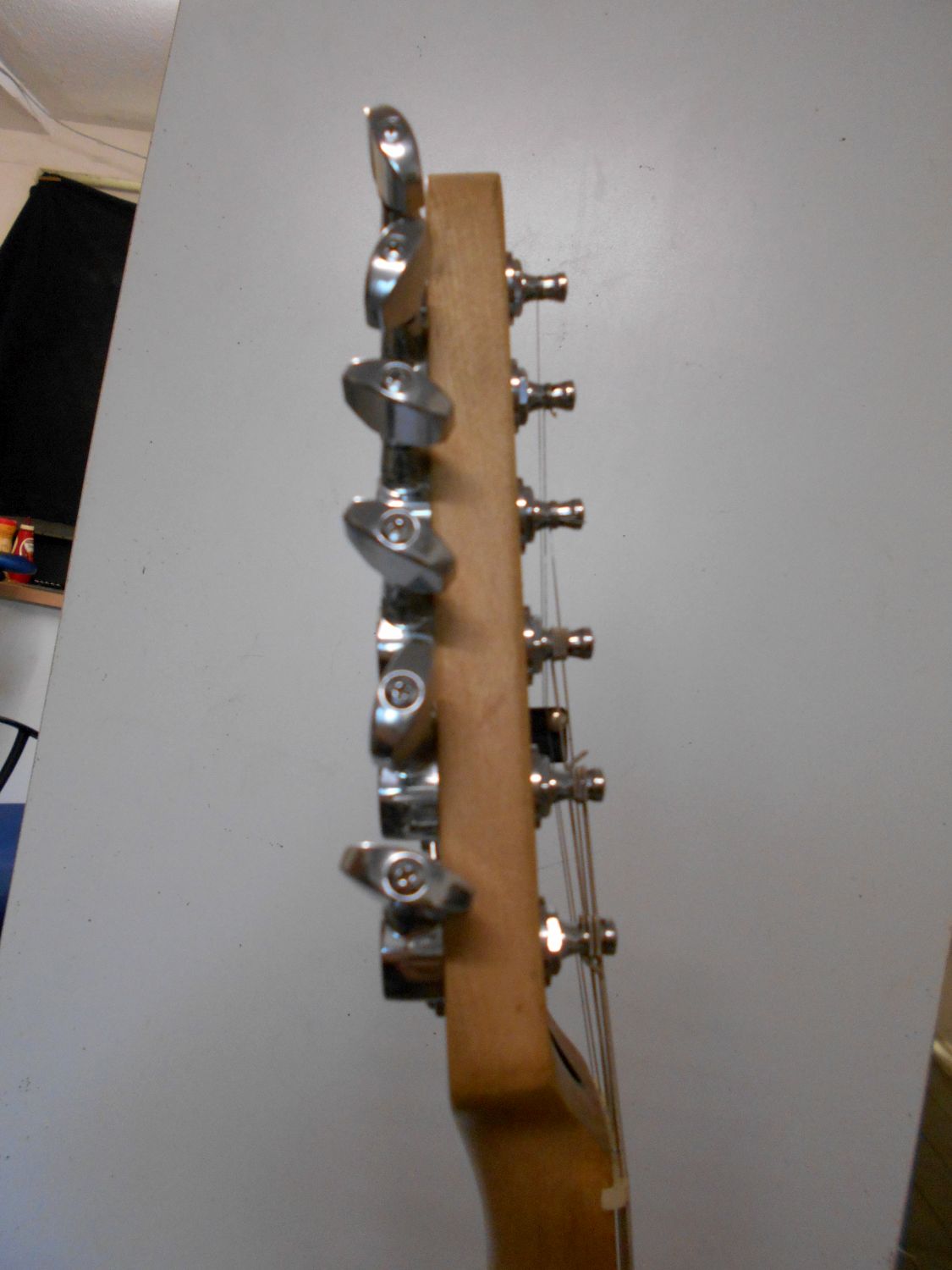

Here's a little tip for those who are building, or have built Strat style kits and are having trouble keeping the guitar in tune when the bridge is set to float as per how I've set the bridge on my Gold Strat, if the low E and A strings seem hard to keep in tune it's probably due to friction in the nut slot caused by the break-angle of the string when it goes over the nut being a bit excessive or too steep, this causes the string to pull down into the nut slot under string-tension which in turn increases friction, to remedy this consider winding the string "Up" the tuner shaft rather than "Down", I know it sounds counter-intuitive but I found that doing this to the low E and A strings on my Gold Strat improved the tuning stability of these two strings, and they still sustained properly without buzzing like a sitar.
Next, once you have the offending strings winding up the tuner rather than down, tune each string on the guitar up to pitch, then give the trem arm a good workout, then tune each string back up to pitch, repeat until the strings no longer go horribly out of tune when you give the arm a good workout, they may all go slightly randomly out of tune but that's okay, as long as they aren't going horribly out of tune, I've got it to the stage where I can do some pretty aggressive trem-abuse (almost what you can do on a Floyd Rose equipped guitar) and the strings only go very slightly out of tune (less than about 5 cents +/-), so light Surf Chord shimmers should be fine to do now.
Here's a pic showing what the strings should look like when wound up the tuner shaft:
Attachment 20174
Notice how the break-angle for the low E and A strings looks a lot like the high B and E strings?, this is what you should aim for in order to remedy tuning stability issues with your Strat-Style trem when it's set to float to allow pull-ups and dive-bombs, this worked for me after trying graphite and lubricants in the string-slots failed, I guess if I combined winding the strings up with nut-slot lubricants it'll produce even better results, but I haven't tried it yet, might do later on though.
Note that this is assuming that the tuning-stability issues you're having isn't being caused by the string binding in the nut-slot due to the slot not being wide enough to allow the string to move freely through it.
