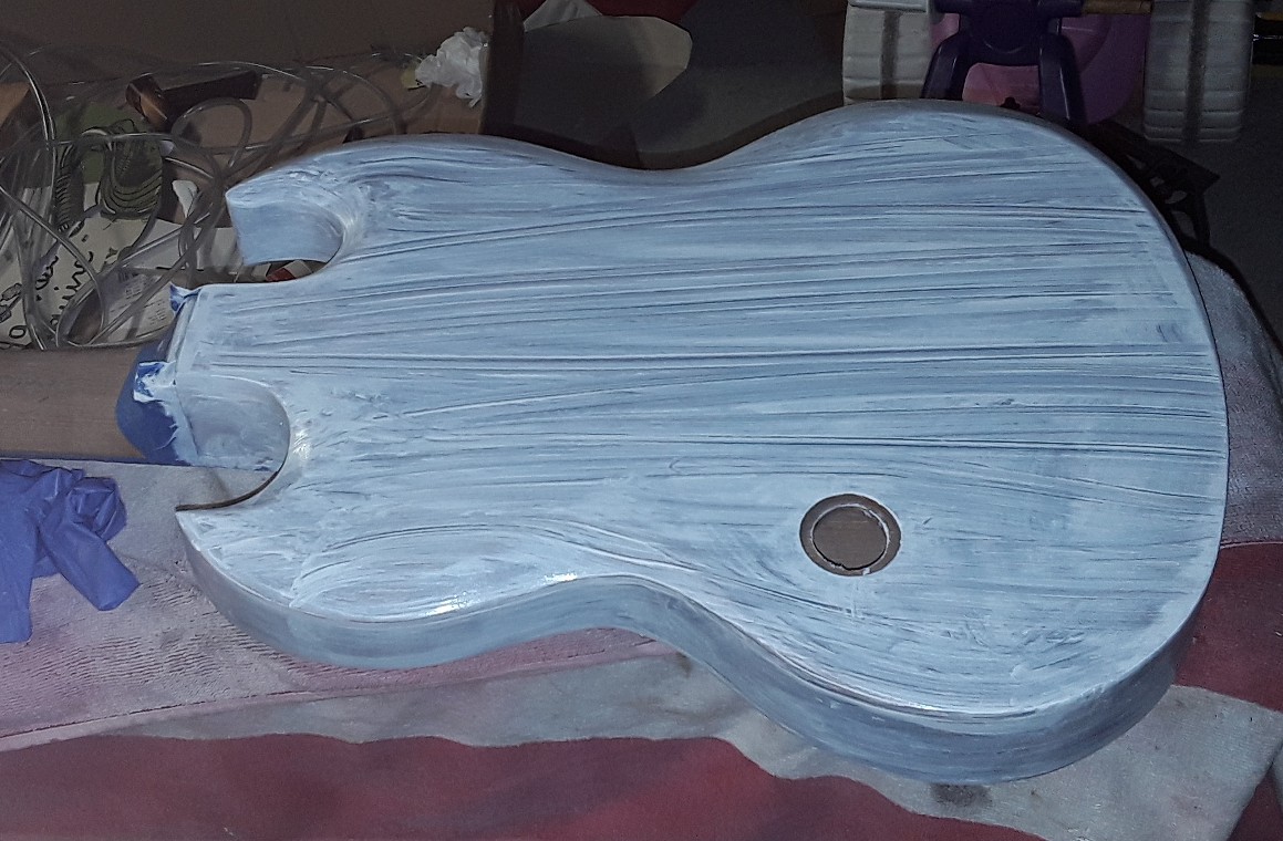

Attachment 29075 now some white
Ooooh, nice.

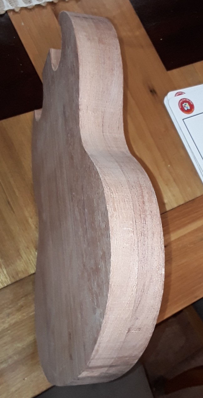

Attachment 29095Attachment 29096 ive sanded back the white wash and done anothe thin coat its made the hit and miss of the black sanding back really show
Attachment 29102Attachment 29103 the flash on the camera changes the look
wow it really does change the look! I like the white coming through.
I'm not really liking the look of this, thinking about sanding at all back and going black
I'd sleep on it as that weathered look is great, but yeah, sg's do look great in black as well.....
It looked best just before white wash was applied.
I think mahogany being a harder timber doesnt really grain pop too good. Lesson learnt

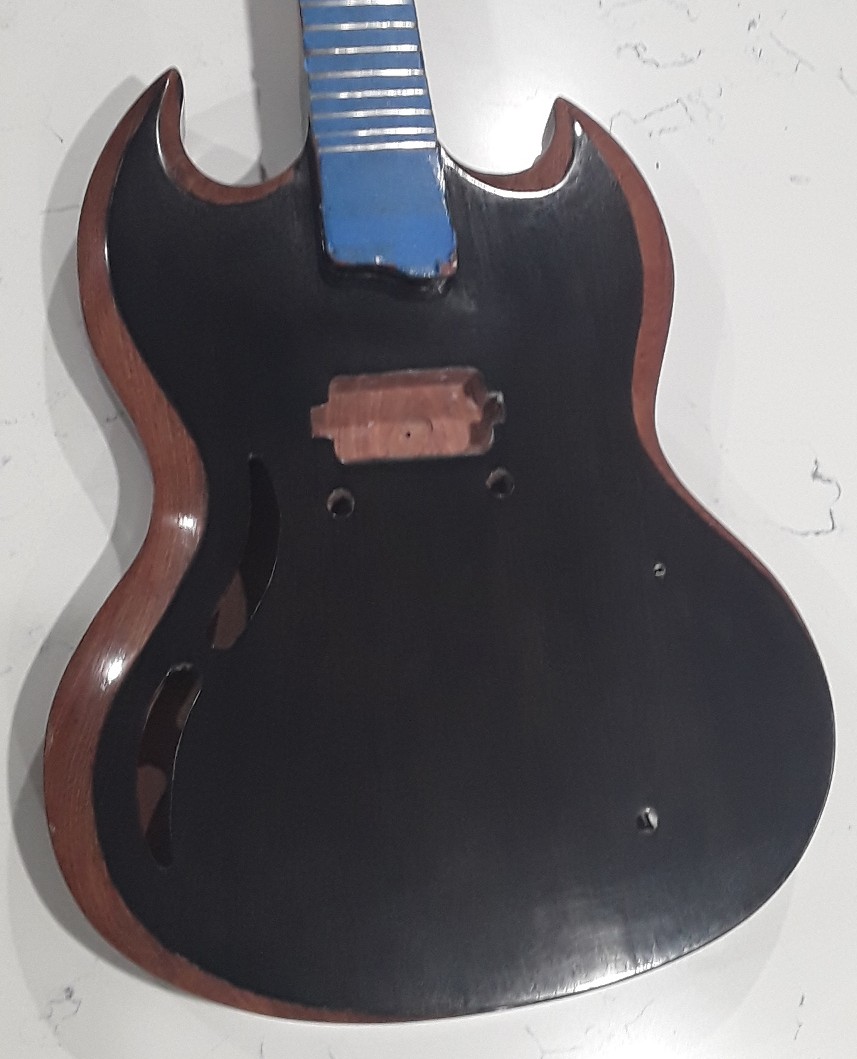

Attachment 29115 back in black the white wash looked terrible
Good call I tried something similar on a telecaster good in theory but the whitewash just didn’t take

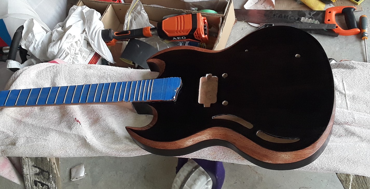

Attachment 29133Attachment 29134Attachment 29135Attachment 29136Attachment 29137 I'm happy with the look now so first coat of tung oil this afternoon
Thinking about it (with obvious hindsight), it might have been better to do the white first, then try and grain fill with black filler over the top. You may then have needed another white coat after sanding back. There are enough small pores in mahogany to show the grain pattern and make it look interesting (like a Gibson 'TV yellow' finish), but it hasn't got the cross-grain figuring that flame or quilted maple has to take up a darker colour for 'popping'.

Thanks simon. After looking at my other builds i don't think mahogany is really suitable for grain popping Attachment 29157 same process on basewood Attachment 29158and the mahogany its all a learning curve

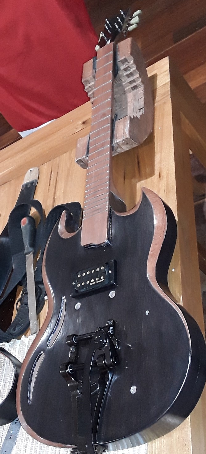

Frets levelled and polished, first look at the red fret board with the black finish on the body Attachment 29456 Attachment 29457
