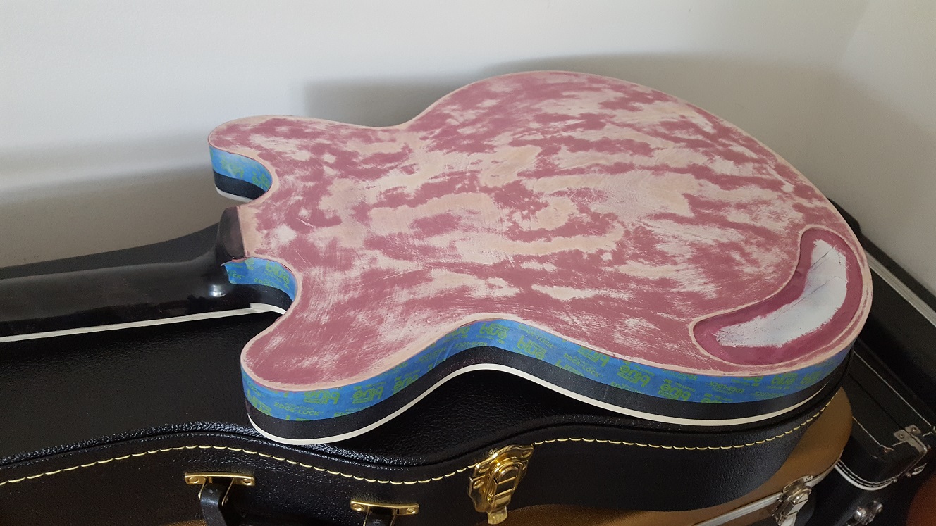

OK, the "oh sh*t" from last week was me painting the back dark deep purple, so dark it would look black in bad light. The woman at the paint shop and I stuffed up and it took overnight to dry before I could remove the PINK paint :-(
I've saved it, now polished black enamel and in tomorrows daylight I'll decide if that's it for the back or sand again, more paint, sand further and lay poly over the lot, Hmmm.

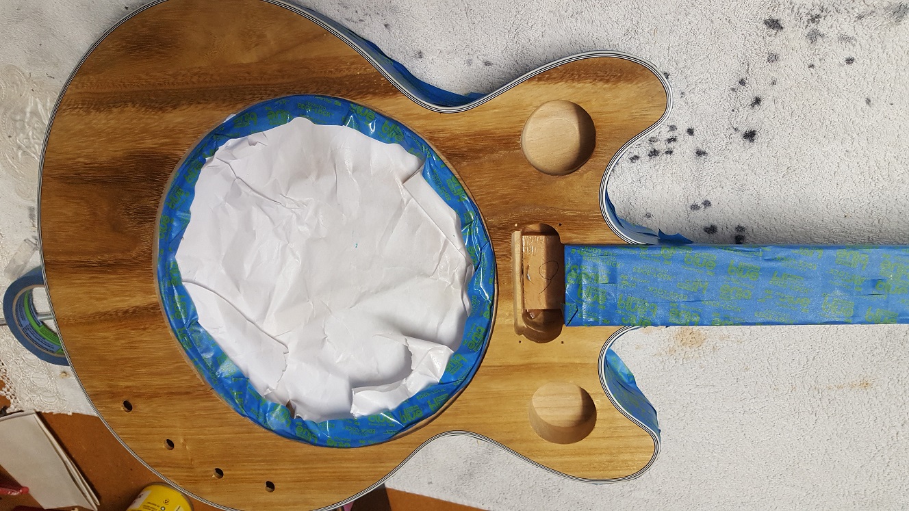

The finish is now hard and a couple of days away from the final sand and polish. Today I took opportunity to correctly slot the nut and make a bridge.

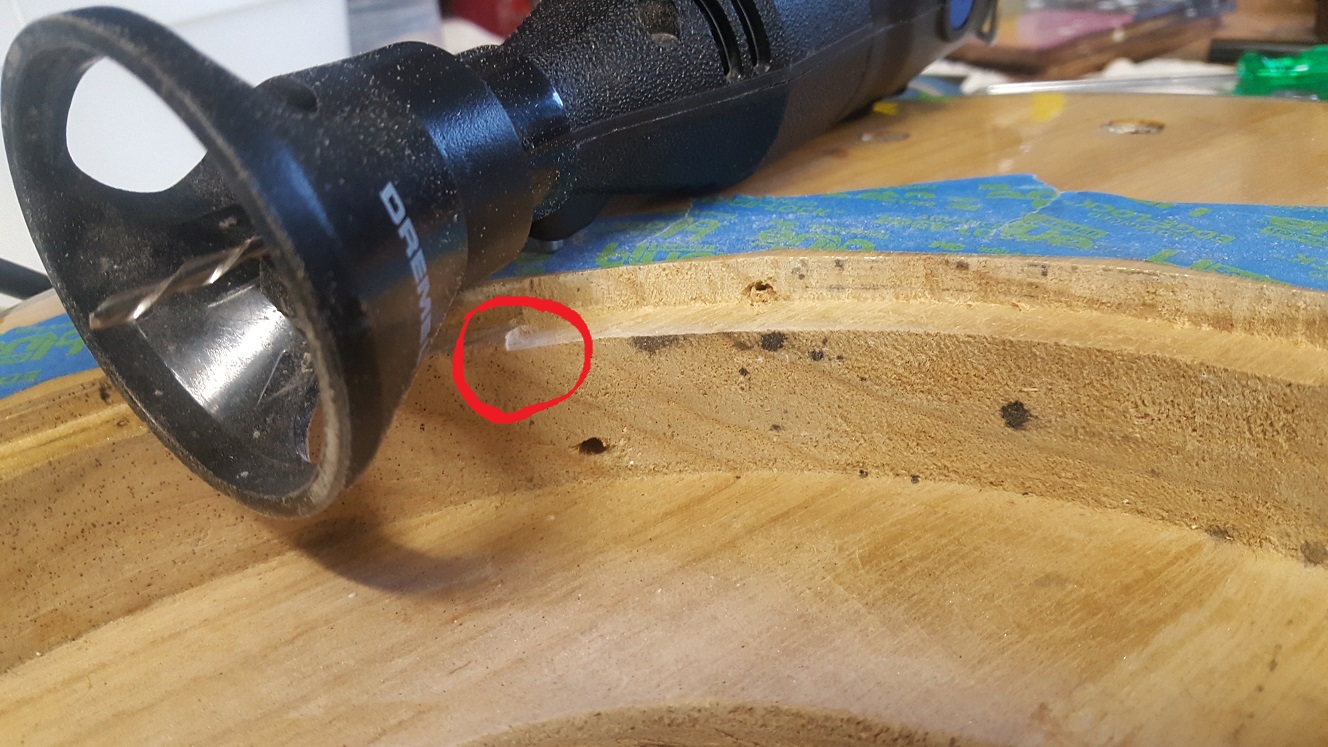

BUMMER, I couldn't get the action low enough so after a bit of a think decided to mill timber off the surface the cone sits on and in turn drop the bridge.
Attachment 26883
This shows a witness mark of old cone level.

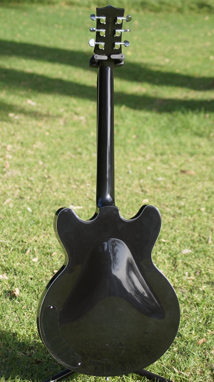

The "halo effect" polished out, happy days!
Late today I was happy with the finish so decided to assemble.
Very happy with the look, feel and tone, a couple of small tweaks tomorrow and it's over :-)
Attachment 26937

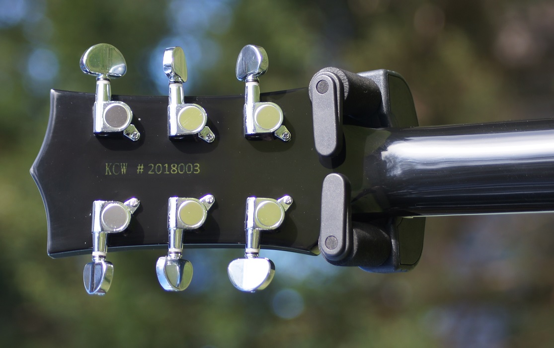

Anyway while these things are never really finished I'm for now calling this one done!
A couple of final photos and I figure I'll only come back to this thread to possibly reply to question or any comments.
After the 12 string Tele (now on the bench), I'm thinking of doing a second resonator as I enjoyed this my 3rd assembly and know I can improve second time around.
BTW, yesterday 3 accomplished players gave it a good workout and I was blown away as to how it sounded, happy happy!!
