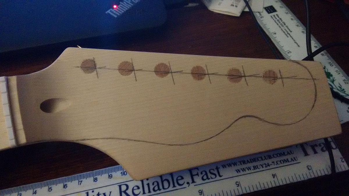

You did a great job shaping that headstock. It's equal parts tele-inspired and original at the same time!
Thanks trv. Yeah I wanted to add a slightly 'curvier' aspect without deviating far from the original idea.

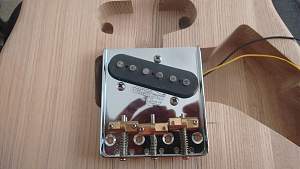

Last remaining items finally arrived: brass nut, string through ferrule and the Tonerider bridge pickup.
Attachment 26390
cheers, Mark.
nice going king casey, pleasure to watch build progress
regards
Guv
Thanks Guv, I have since noted that between the Tonerider Pickup and Wilkinson bridge...neither include the mounting screws/springs. Doh!!
cheers, Mark.
Edit: Further exploration of the Tonerider box revealed

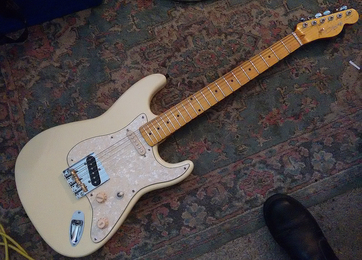

Well the end has arrived. My first Pitbull kit is completed.
Thanks to the many folks that have posted build diaries that made the process so much easier.
Even though some steps required re-doing, I have certainly learned a great deal.
Yep, even the decal had to be re-done.
Attachment 26412
I'll try to get some better shots when this Melbourne wintery blast has subsided.
Attachment 26413
cheers, Mark.

Here's another attempt
Attachment 26417

Well time has certainly passed and I have done some slight modification.
Wasn't happy with the bridge location. I was within intonation, but set too far forwards which meant a severe angle for the low E string.
Decided to relocate the bridge 5mm further back.
Upgraded the potentiometers and installed an orange drop capacitor that was laying around.
Relocated the volume and tone, and installed the 'Gibson' style pickup selector.
edit: Oh, and made a different scratch-plate.
Attachment 31271
cheers, Mark.
Oh yeah. Furthermore, I added an 'asymetric' neck plate, and 'Grant neverwas' transitional neck mod.
Attachment 31272
cheers, Mark.
