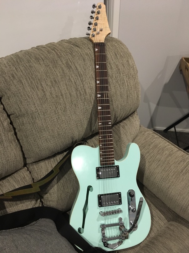

Life has been hectic so the poor old guitar project took a back seat, but I had a few hours today to bang her together in the hope of using her for our New Years Eve gig...
Attachment 23845
It’s not 100% perfect but when I get time I’ll go back and make it so, but spare time is super rare at the moment so I have to make do. The two main problems are (I’ve never owned a bigsby style tremolo before so I could be wrong) the tremolo arm seems to sit pretty high so I’ll probably get a shorter spring. The other problem is I replaced the nut with a Graphtech one and the strings hit the first fret, even with the action at twice what I would normally run at. I didn’t take any off the bottom of it before installing so I’m a bit bummed but I’m sure I’ll be able to work out a shim to get it to a more suitable height. It’s not too bad, the strings just rattle a little on open strings, so I’ll still use it for a song or two, I’ll just make sure the songs have no open chords ;)
Anyway, thanks for looking and have a safe new year...
Robbo
It's turned out nice. I think the "bigsby" sits a bit high because it needs the clearance over the knobs. I got this model as well. It's been my main guitar for the last few years.

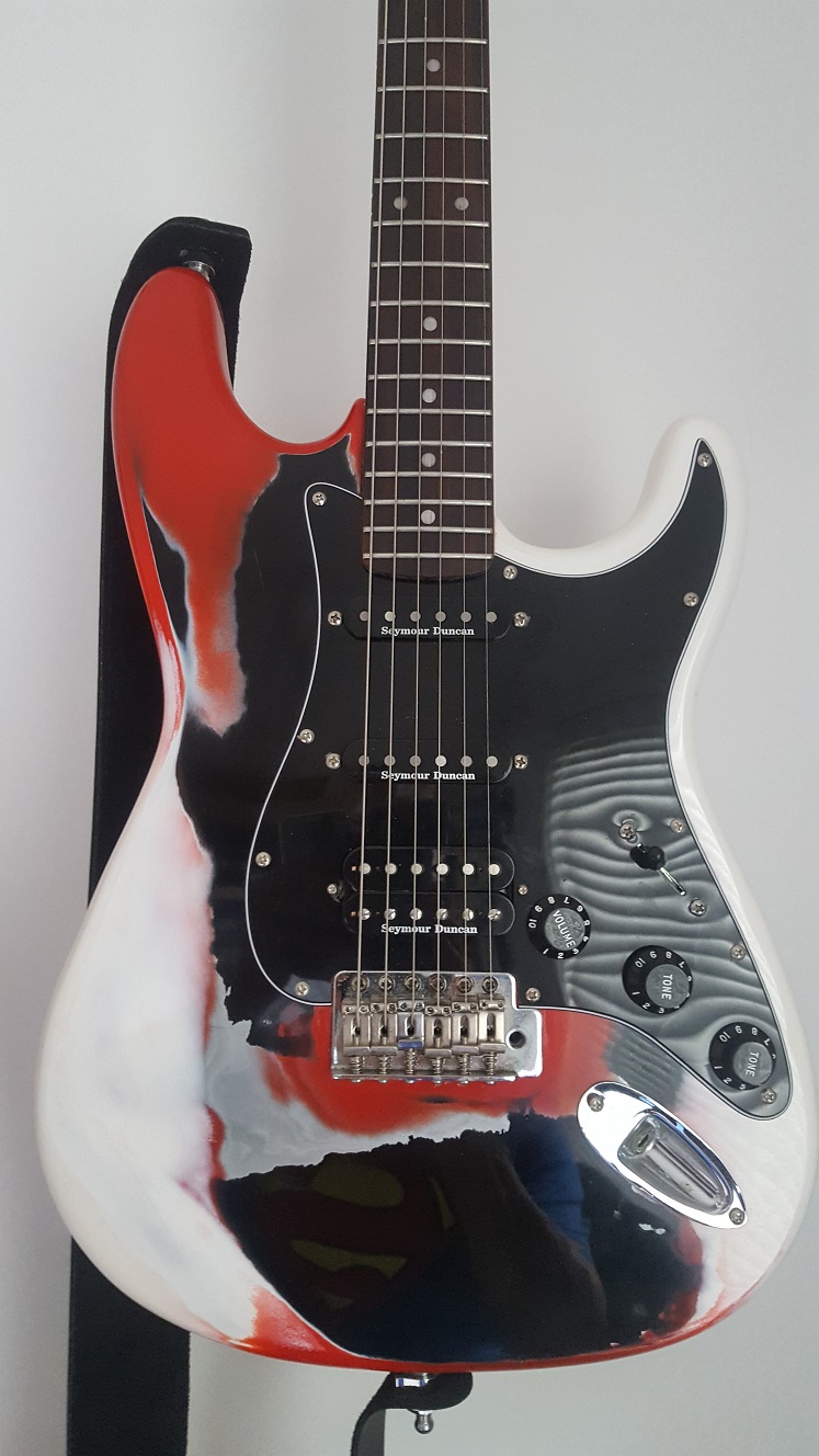

Sorry to (slightly) hijack Robbo's thread but I must ask ...
My first build I brushed and wet sanded 8 coats of acrylic clear and ended up with a HARD attractive finish.
My second I sprayed every different almost empty can of enamel on hand in what was to be multiple prep coats, wet sanded each. It looked so cool it stayed that way and after a weeks went hard HARD and is standing up to use.
My third build is getting close to paint, I had intended spray enamel, I don't mind spending a few extra $$$, what should I be buying?
Hmm, probably going to start an argument here, but I'd be confident in saying that an enamel will be harder than an acrylic finish, and will stand up to abuse better. Enamels tend to soften with contact with hydrocarbons such as fuels and alcohols, but iare otherwise very hard wearing. That's why the goof off stuff was the wrong choice.
Enamel takes longer to go off, and tends to set from the outside in. Acrylic dries from the inside out, and dried much quicker.
Enamels sometimes have a yellowish tinge after time.
The auto stuff you get in Australia car shops for body panels will almost certainly be acrylics.
This info comes from respraying vehicles more than guitars, but I'd say that the same should be true on timber.
I like the Cabots range of polyurethane clear. I have used this over acrylics with no issues, and does make a good hard covering.
Thanks for that comment, keen for further as this stuff is reasonably new to me.
The enamel job referred to started as a knocked about body I found in a garbage bin, filling, sanding then empty whatever pressure pack I had on hand, more sanding, more paint etc etc. End result made me smile so I stopped before final colour coat, it's HARD.
Attachment 26153
Don't mention the t shirt, my identity must remain a secret ;-)
The pickups came on a loaded pick guard from 920D
https://www.siglermusiconline.com/co...ded-pickguards
they have great stuff but a bit heavy on the $$$'s.
Nice upgrade for a strat. Especially one from the bin!
Will it be called The Strato-castaway-er?
