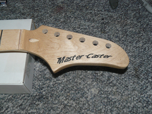

head stock with 1 coat of TO . The decal was done with the grease proof paper and iron method.
Attachment 13871
Was going to prime the sides and back of the body today but its blowing a gale :(
slow and steady mate, decal looks good, did you find the process difficult?
the first time I did Stan. Then I found it worked better if you tape the greaseproof to an a4 paper, on my printer (lazer) it didn't like feeding the greaseproof by itself. Also, the smoother the timber is , of course the better the adhesion.
great tips thanks, good to see different ways of doing headstock decals

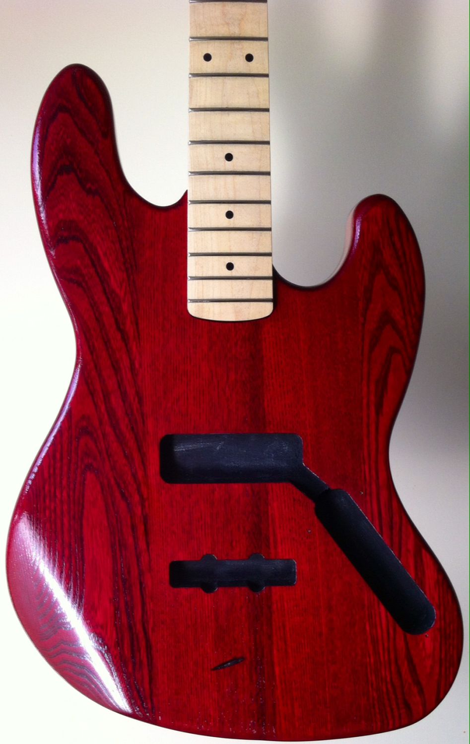

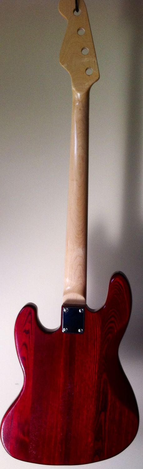

I successfully did TO on the Fret Board of my J Bass, just put down less coats than for a whole body. Probably 6 - 8 from memory and here are a couple of shots of the end result. Looks and feels just like a Maple Fender would and really happy with the outcome.
Attachment 13881Attachment 13882
I lurv that J bass, I think it's the red that does it.
Thanks Frankie. Tend to think a Rosewood Fret Board would have detracted from the body and really happy with the outcome.
Suspect this may be the colour scheme Dedman has in mind and wholeheartedly encourage him to do it.

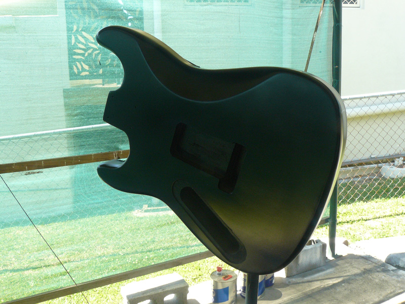

got some black on the back of the body today
Attachment 13926
looks good Dedman great job buddy. So red stain for the top ?

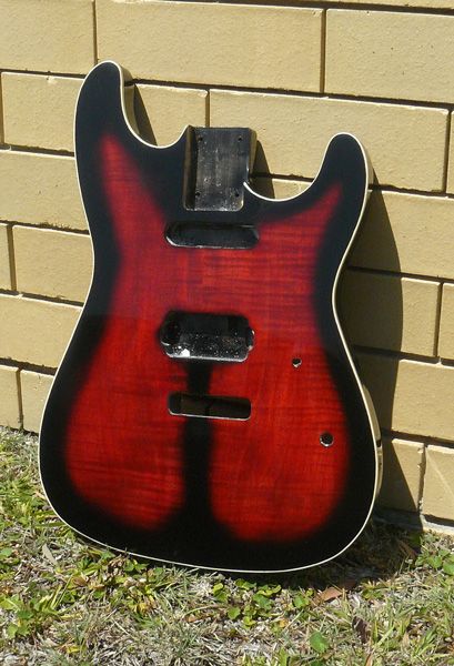

first clear coats are on
Attachment 13970
looks great Dedman, is that black strip around the centre to cover more glue ?
yea, it was pretty thick, by the time I'd dug it out I had to fill it with timbermate
fair enough Dedman, looks cool anyway. How did you clean the binding did you mask it or clean/scrape it after the burst ?
glad you cover your motorbikes, would hate any overspray to land on them !
I masked it then had to scrape it anyway there is always some that gets under. I just use a bit of 800 grit paper folded down to about a centimetre square and us my thumb as a guide on the edge.
