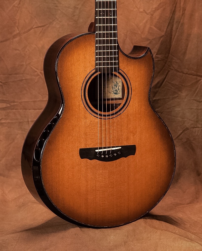

Update - I've ordered the DT clear stain for the front. I also ordered a small bottle of black base stain so I can play with a Moon Burst effect on the front.
I'll see how it goes with some trial on a piece of Laminated pine I have at home.
Probably the best way to describe it is as a very subtle burst. I've mostly seen it referred to in Acoustic Custom builds. Hopefully I can pull it off.
This possibly the best version I have seen of it.
Attachment 12342
I see, thanks for that. It is very subtle, shall watch on with interest.

Going Natural with a very subtle burst, sometimes called a Moonburst.
There's a picture on the last page of an Acoustic with the effect I'm trying to get.
