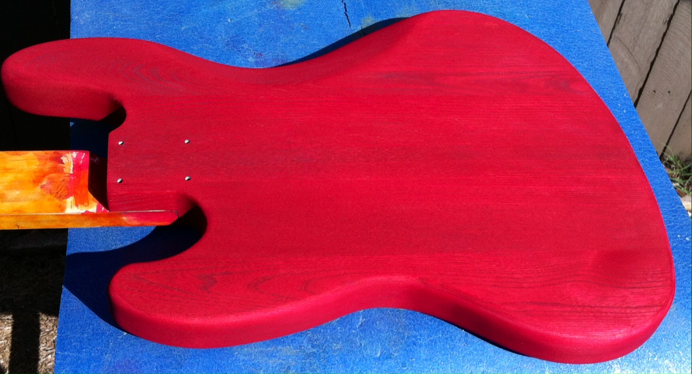

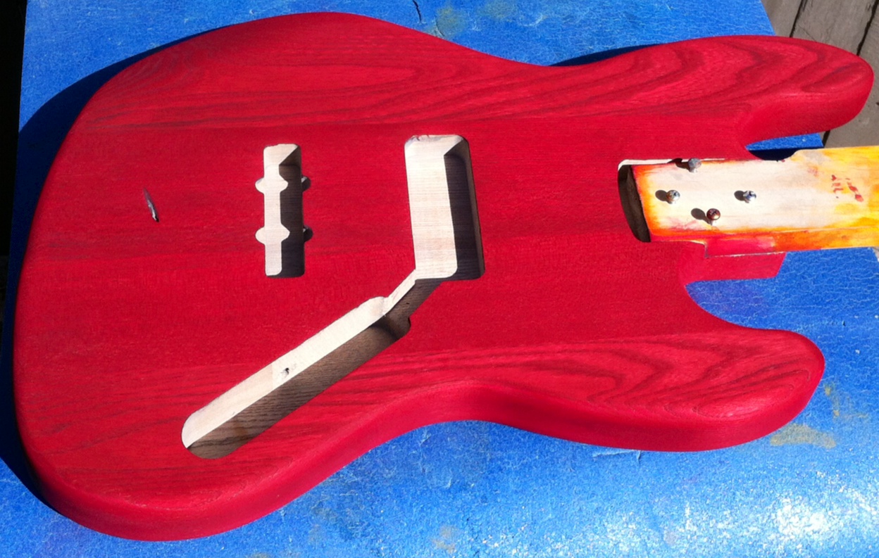

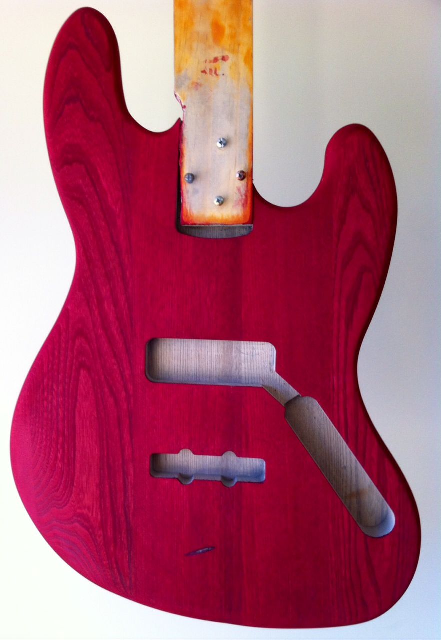

Thanks euroa & Dedman. This was probably the easiest of the 4 builds I have done so far and really happy with the colour as that part of any build does not always end up how you pictured things in your mind before starting.

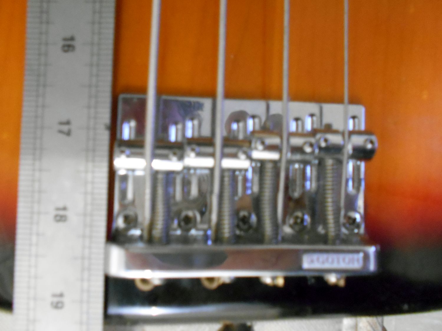

I'll also post a pic of where I have the string saddles positioned for the Hot Rod Strat.
Here's a pic of the bridge on my Squire P-Bass guitar, the little black mark near the number 17 indicates where the scale length measurement is for the distance between the nut and 12th fret ( I used my longest metal ruler which is 600mm in length and has scale markings in both mm and inches, I used the inches scale for the measurements in this case), the bridge is made by Gotoh:
Attachment 15065
Here's a pic of where I have the string saddles positioned on the HotRod Strat's bridge, as you can see, the saddle for the low E-String is set pretty much close to it's limit for lengthening the string, and it still reads a bit sharp:
Attachment 15066

Here's my Fender P bass bridge that has recently had a professional set up. Uses medium flatwounds. Intonation is spot on

Here are my bass bridges, a Lakland Skyline Bob Glaub (P-bass) and a (rather dusty) Peavey Cirrus BXP.
The Lakland's got Rotosound Swing bass strings on (45-105), the Peavey has D'Addario EXL 170s (45-100).
Attachment 15077Attachment 15078

At the moment the setup has the correct staggered saddle positioning where low E is screwed way back. Just taken a bit by surprise how far forward the G string saddle had to be shifted as the height adjustment grub screws are now sitting awkwardly on top of the base plate mounting screw on that side.

They look cool, I'm not sure what model bridge I have on my Squire P-Bass, but it's manufactured by Gotoh, it seems to be a pretty good bridge, and I have never had any issues with it ever since I bought it, which is probably a good few years ago, I think I like the Squire P-Bass a lot more than my red Yamaha ERB-300 Bass, which has some dings in the body, there's also a crack in the body wood near one of the pickup volume controls on it, I might do some work on it at a later stage to fix it up a bit, and put some 105-45 gauge strings on it, the original ones were a bit too heavy for my tastes, and they required the truss-rod to be cranked pretty tight, the ERB-300 needs some work done on the nut cause the 1st fret action is a bit too low so the strings buzz against it a bit, might even change out the tuners for some new ones cause the originals are a bit rusty and grotty, could even give the frets a polish with my Dremel tool too while I'm at it, which reminds me, I need to buy some grinding bits for my Dremel tool, might check to see if my local big green shed has some in stock.
