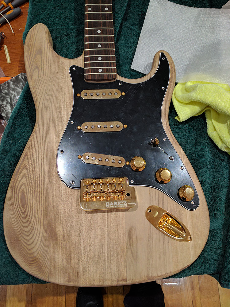

So I attached the neck and bridge last night (making sure everything fits/works before I start on the finish)
Attachment 17285

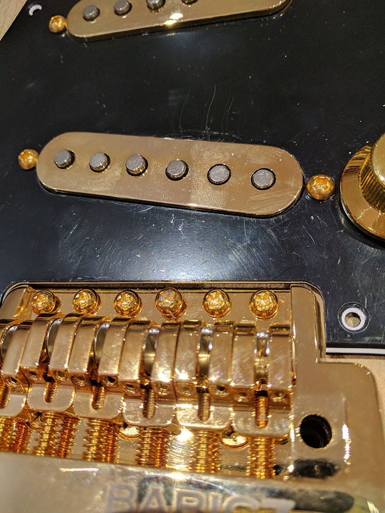

unfortunately stripped a screw on the bridge (g string)
Attachment 17286
phew, pitbull sells spares

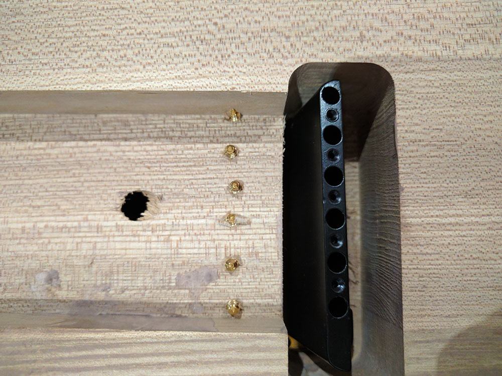

then I flipped it over and saw this:
Attachment 17287
someone tell me that's fine as it'll be hidden out of view before my anxiety kicks in.
It's fine. It will be hidden.
Grind the tips off if it worries you....
Whooposy daisy. just put the sheilding tape over, no-one will see.

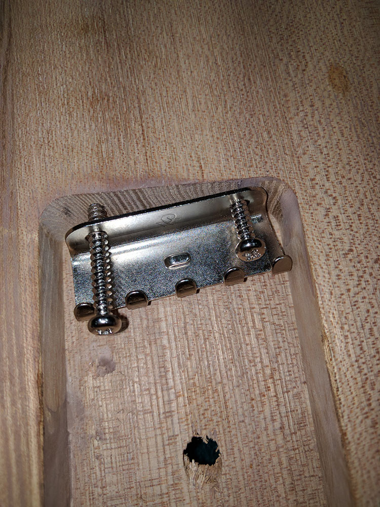

Help. I've screwed up and I have no idea how to fix it
Attachment 17316
a) the pilot holes aren't parallel so can't move the plate
b) even though the screws are too far in they still stick out of the cavity
you can see in that photo where the drill was rubbing on the lip of the cavity making getting it right impossible (I'm not sure that I'm capable as it is of drilling 2 parallel holes)
as the screws are going to be under tension they're going to need to be properly anchored to the body.
I guess I'm going to need to fill the current holes with something that I can still drill into and will be strong enough to hold
then get a stupidly long 3mm drill bit to be able to drill the pilots properly
Hey Maddog,
yeah you really need a long drill bit for this job or the drill chuck will touch the body as you found out !.
Unscrew the screws and plug the holes with broken toothpicks and glue. Doubt you will get dowel small enough to fit the holes.
I usually hold the claw plate to the end of the cavity and drill 2 pilot holes.
Then remove the claw and drill them deep enough to screw the screws all the way in, if you want the bridge firmly flat against the body.
Let us know how you go !
its not that important the claw is dead centre of the cavity so the new holes I would drill a bit offset. You have enough spring anchor points to attach the springs to.
EDIT before you do that unscrew the screws and try and screw them in evenly, the claw holes sometimes get caught on the thread. YOU MAY NOT HAVE TO RE-DRILL
hey Maddog, so the claw plate touches the cover plate when screwed almost all the way in ?
in that case if you intend using the plate you will need to re-drill. Get a long 3mm drill bit.
The screws should have enough hold as they are. I'd say you still need to drill them deeper.
otherwise go rock n roll and not worry about the cover plate haha
haha love the Obi title cheers mate !
by the way the black PG and gold hardware looks HOT !
with the bridge screws coming through to the cavity if they worry you, I'd carefully hacksaw the tip off. If using the cover plate they will be hidden. The gold screws must be slightly longer than the kit ones
If you had to fill and re drill the holes I would rather drill new holes in the claw plate and start fresh.
Remember that the screws don't go in very far, mine are not much further in than your long one and I only used 3 springs.
I would also be looking at a right angle chuck rather than a super long drill bit
I've had to screw the claw plate almost all the way in to get it to clear the cover plate
That being the case I reckon you'll use 2 springs and 13s to get the Trem off the body ;)
yeah, I'm not too fussed on losing trem usability as I don't really use it, but I have got myself a right angle driver adaptor for next time
One thing I did discover during this exercise is the allparts trem cover I bought has different spacing on the string holes than the Babicz bridge. The PBG one matches but is the wrong color. At this point I'm probably going to grab the one off my Squier strat as that looks like it'll be fine and I'm assuming they've done a much neater job on the trem cavity than I have so it wont be needed there.
If not planning to use the Trem just screw the claw in nice and tight as this also helps with improving sustain too.

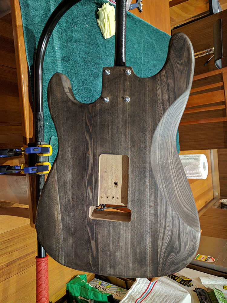

Put the first coat of Black Stump on
Attachment 17448
Attachment 17449
Attachment 17450
I'm liking it so far
nice one Maddog looks great ! It will darken after next few coats
Geez Maddog, that looks great already and will only get better once you apply the intensifier coat/s.

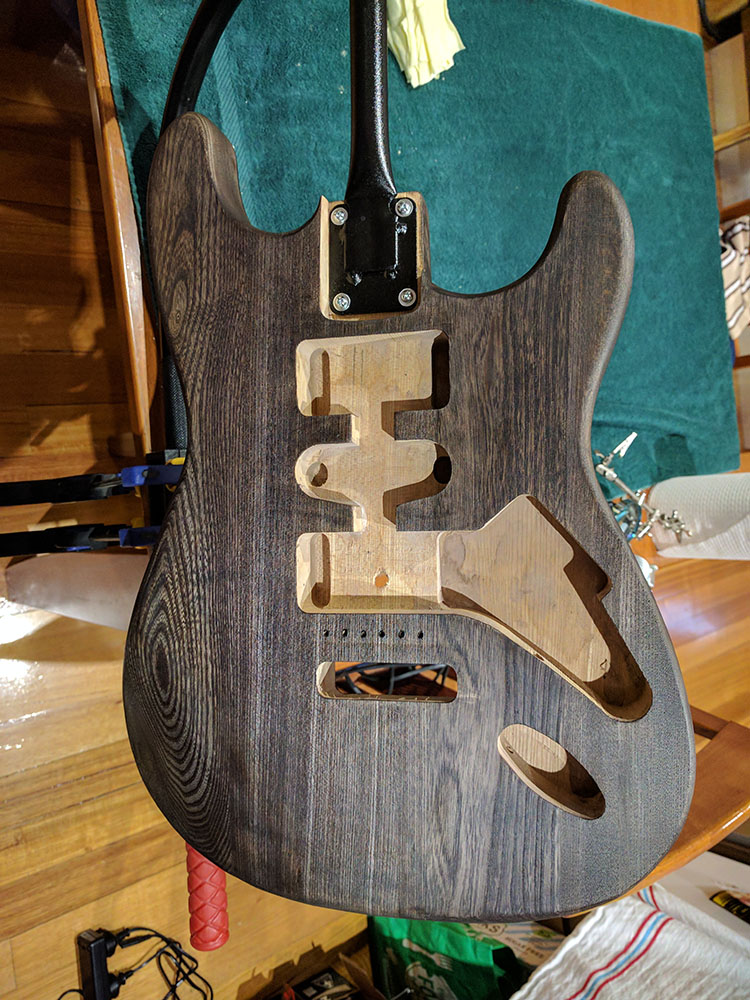

So far I've put on 3 stain coats and one intensifying coat and liking the results s far:
Attachment 17883
That's after letting the intensifying coat dry for 24hrs
Hi mate, the raised bits might be best left alone as if you try to sand them I reckon you will strip lots of colour off and may end up having to refinish large sections. Besides, it looks cool and adds character - just an inherent feature when working with Ash timber.
Intensifier has really brought it to life. How does it look in the flesh as photos do not always project a true image?

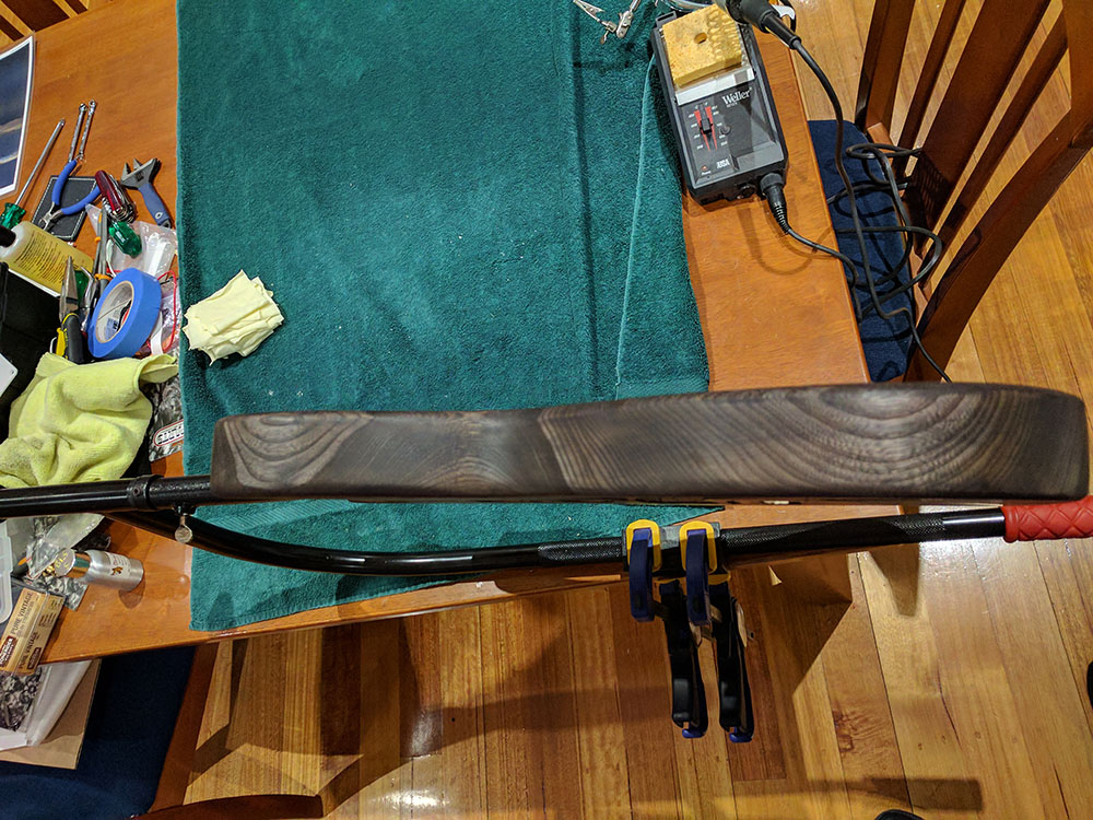

some of the final coat was a bit lumpy (Mk II) for the most part it looks fine:
Attachment 18412
but there is a spot that's a bit patchy on the back but I'm no sure if thats just the drying process (it's been around 24hrs)
Attachment 18413
Also with neck moving along I need to make a decision on my logo
Looks familiar and have experienced that myself several times on a couple of earlier builds. You may need to do a gentle wet sand with 1200 to 1500 to smooth things out once that layer has had plenty of time to cure and then try and put down another super thin coat or two before going for a final polish.
Too many coats at this stage seems to end up looking like that last shot.
