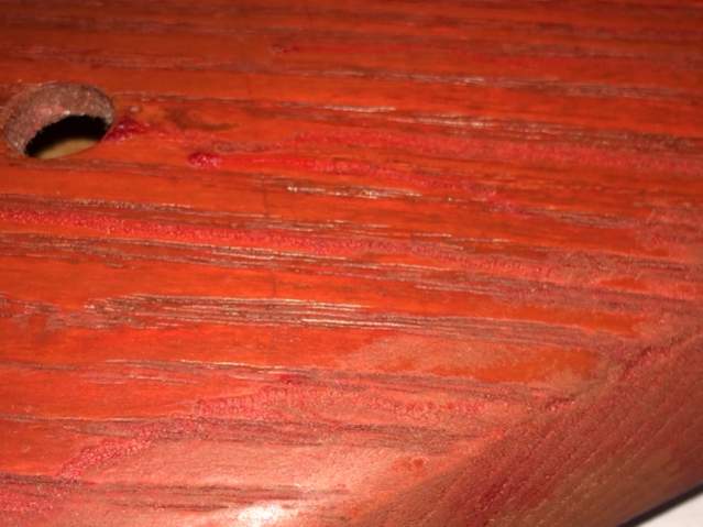

Second intensifying coat applied today.
Attachment 2965
Starting to wonder if that's ochre or blood... :)
If it dries evenly I think it'll be ready for the top coat (next week).

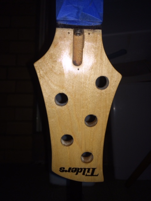

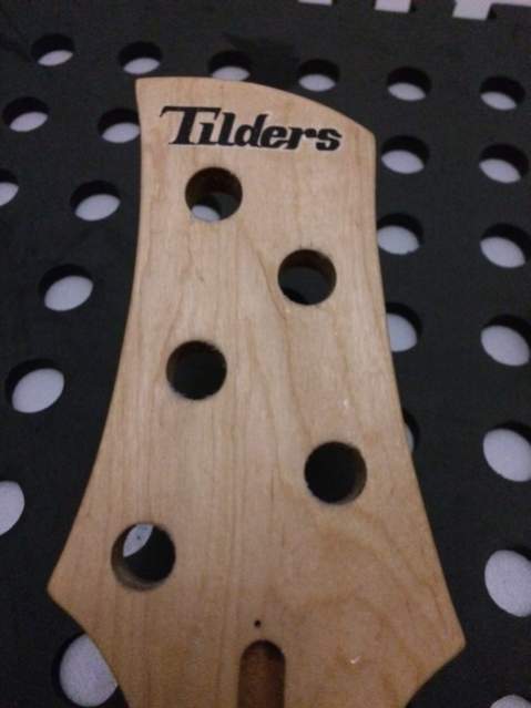

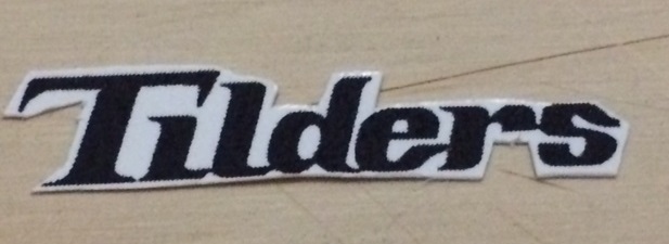

So I've done this thing with previous builds where I make a logo in a style similar to what the guitar is modelled after. For example my fretless jazz...
Attachment 2970
So this time around, again using waterslide paper:
Attachment 2969
It's an IB-5, so it gets an IB style logo.
I've applied it already, waiting for it to dry before applying the top coat over it.
Attachment 2968
Also waiting for the top coat test I did of a couple of decals on a bit of pine to cure and see that it really does seal the decal in.

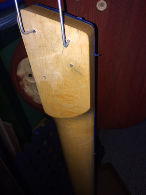

I did notice the neck seemed to have gathered some gunge while hanging in my sunroom drying.
It's had two dingotone colourless stain coats.
The gunge is mostly around the edges, the curves of the foot and the head - and along the edges of the neck near the join to the rosewood.
Feels like what you might get left on a surface after you peel a sticker off.
Some 0000 steel wool cleaned it up though.

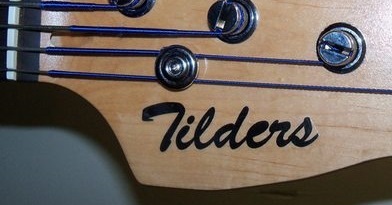

I really like that logo. Is that a font or did you draw it? If it's a font, do you mind sharing which one it is?
Really looking good Tindrrel, love the colour and the headstock logo.
rob
A bit of both.
My attempts to find a proper loadable font mostly just found websites that wanted to install software on my computer.
I did find this, a guitar fan's attempt at completing the font in the same style.
Cutting and pasting their letters, creating the T based on looking at other fonts and adding some dabs to join the letters together gave me something in the style I wanted.
hey Sam (finally found out your name), the build coming along really well and love the colour intensity ! Headstock logo looks great too. Think your stain got mixed up and you were sent Karijini red
yeah I'm pretty sure you got Karijini red. It's a great colour and it really suits the IB5 !
First top coat of Dingotone Colourless went on the neck today.
Had to clean up the surface with some steel wool to get rid of whatever had gathered on it.
Then had to clean it again to get rid of the steel wool dust.
Looks shiny at the moment, only a thin coat. I expect to apply a couple more and maybe thicken the coat on the face of the headstock to make the decal edges invisible.

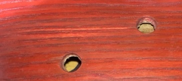

Time for another intensifying coat on the body.
The last one seemed to streak a little.
Attachment 3073
The streaks seemed to originate at the edge of the cap. Perhaps I overlapped and built too much up when I did the front and then the side.
I sanded the streaks off with steel wool. Gave it another coat.
The coats don't seem to be leaving an even colour. The bottom half seems lighter than the top half - and there are some patches that are much lighter.
Attachment 3074
Looking at the photos of the body before sanding I don't see any obvious reason for that patch to be coming up lighter.
Also, another neck top coat done.
Attachment 3075
Not really seeing anything build up here yet. Still just looks like the bare wood.
You can go over the lighter patches again Sam on the next coat, dunno about the neck!
hey Sam, sometimes different parts of the ash wood take more stain than other areas. Might be worth rubbing it back lightly with about 600 or 800 grit paper and try and even out the colour a bit more.
Also DB recommends you wipe over the body once and don't over work the stains.
How many clear coats are on the neck ? I'd just keep applying and steel wool in between hopefully will build up over more coats.
Also keep the coats thin and allow plenty of curing time about 4+ days in the cooler weather
I only gave it a single wipe for each coat that I've applied, except I think I may have overlapped at the edges. It's also possible it gathered in the join of the cap and ran from there. I'm all out of intensifying coat now, so hopefully I'll be happy with this latest coat.

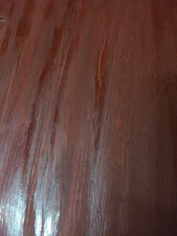

Second coat of the body top coat has been settling for 4 days now. (Dingotone final coat)
From it's appearance I'm wondering if there's something I'm doing wrong.
Attachment 3213
The shiny sections are smooth like one might expect a top coat to be. The duller parts feel like wood.
This was applied with a cloth, swipe following the grain, then swipe next to that and so on across the body.
Am I putting it on too thin or are the shiny parts too thick? Are they what I should expect as the finish?
To be clear, the dull area far surpasses the shiny area. This is the back, most of the front is dull.
it could be just a combination of thin coats and varying permeability of the timber: it is soaking up differently across the body. You might simply need to keep going.
DB recommends fairly generous curing time too, as there are no curing agents in Dingotone
I'm with Stan, I would keep going with maybe superfine wirewoolling in between coats and see what happens (with ample curing time between each coat)
The shiny part seems quite hard, I think it's curing ok. It's just the gaps. I guess the thinking is that I may have wiped those too thin or even wiped them off when I did the wipe next to it.
More coats it is. Not in a rush.
Yeah I'd go for more coats Sam, but it could also be from you wiping across the grain? Try just wiping the excess off along the grain(as if you were sanding the body back) and keep the coats as light as possible. Also in our crap weather I'd give more time than usual to let the stain cure!

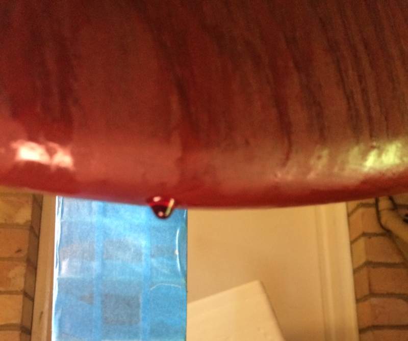

OK, I'd checked for this before and found no sign that it's what was happening.
I suspected the top coat had just run off the body completely, but there was no drops on the board below where I hung it.
This time I caught it.
Attachment 3221
I think the reason the top coat isn't building up with multiple coats is that each coat running off.
That drop has gathered from runs all down the body joining across the bottom edge headed to the lowest point.
Maybe I need to do the front and back one at a time and let it cure laying flat.
Sam looks like the coats are too thick, I've never seen runs with Dingotone or Wudtone.
Also might pay to apply the coats during the warmest part of the day.
There are no drying agents in DT so if its too cold it won't cure.
I'd steel wool it back and apply thin coats and don't overwork the rag. Wipe on once only
Not sure how I can get them any thinner. I dab the cloth in the liquid, then squeeze it til it drips back into the pot. Then one wipe down the body, and a wipe next to that with no overlap, and so on until the cloth is barely wetting the body then dip it in the pot again.
