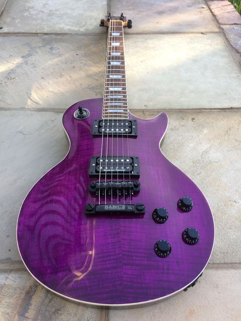

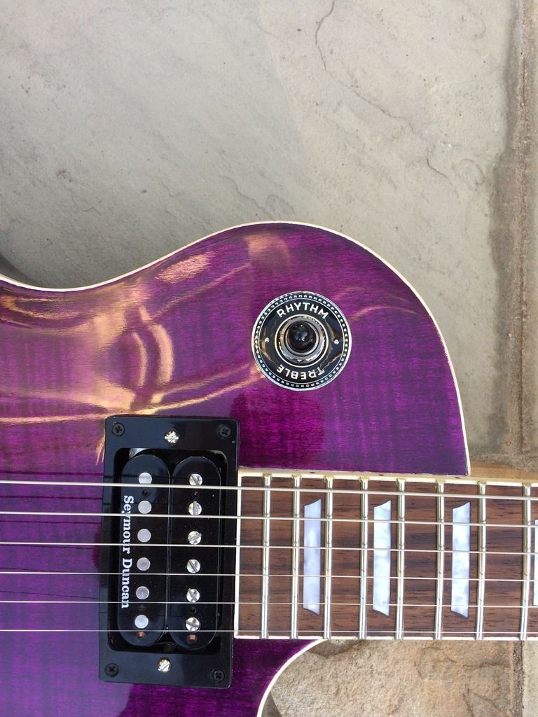

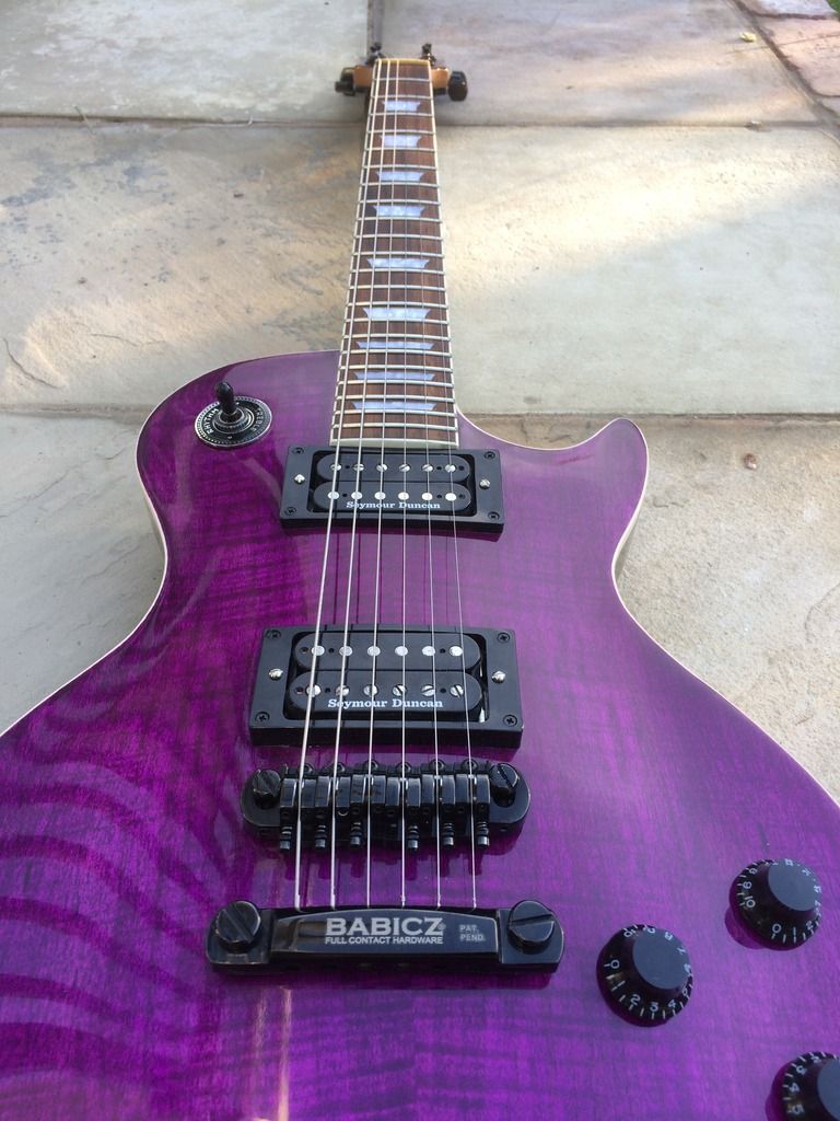

Just about done Shazz, I keep finding little repairs.
You don't need a lot of ink, so it wouldn't be too costly to get a few bottles and mix a colour, about $15 a bottle, and they are nice inks.
Downside is acrylic clear takes ages to properly cure, well is has for me... But ink as a stain works great
Nice! Can't wait to see it finished!
Mixing sounds good! Custom colour.
Man!! That is fantastic. Great job.
Love it! Great job!
Awesome work Stan your persistence was well worth the wait cheers
Sent from Android N
DAYUM! That is kick arse! Great work!
