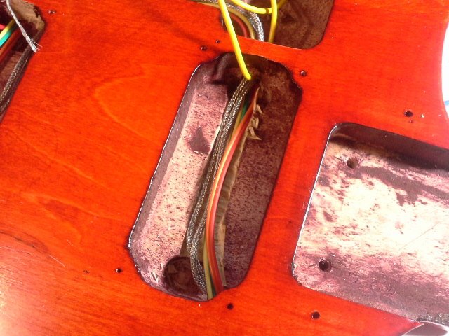

Wokka wiring on my twin neck is well on its way now .I have found there is alot of wires running through the pup cavities, something we spoke about today .so what I have done is to trench out along base of cavitys so I can recess the wires then I will shield over top . Have chucked in a photo (I hope)mmm maybe not anyway you get the idea....now this is were someone tells me one its already been done or two this cant be done because of something...LOL

No mate! :) You dont want to sheild over the top of the wiring unless you wrap the wires in shielding first!!! The wires act as an antennae and by placing them outside of the shielding arrangement negates shielding in the first place! :)

Gav (as we'd all expect) is quite right, unless you use shielded cables, but it looks like there is a few single-insulated ones in the loom.Quote:
/<\\/p>[]<\\/p>/Quote from Gavin1393 on July 21, 2013, 20:39
yep no problems Ray.
haha and I thought I was being smart Gavin.. Thanks for the heads up ,mind you the trench as made fitting the pup easier and smoother
