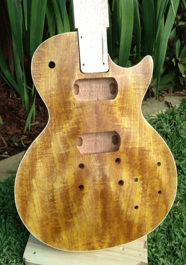

Progress - two gloss coats later...
http://pitbullguitars.com/wp-content...spalty-001.gif
Thanks Gav, although the saddle cannot be in any other location (can it??) - the measurements are right..31/32..I will take your word for it and carry on assuming that everything is correct....cheers.
Hey Pedro, what kit have you got, an LP-1S? If that's the kit, then you should be right to bolt on the neck. They go to a lot of trouble to make sure the necks and bodies match and sit at the right distance to the bridge post holes. I haven't come across one yet that has been "out". The saddles on the bridge can be moved individually; there's a screw that moves each saddle back and forth. Let us know if you still have issues. But, I reiterate what Gav said, please don't cut any length off the neck (I learned that the hard way, it was just my poor measuring).
It looks beautiful - I have just sent you a photo - not sure if I have the saddle right - but it sure looks good. I am very proud of this lovely piece of kit...haha
This would be yours Pedro? Sen-friggin-sational.
http://pitbullguitars.com/wp-content...P1S-Pete-1.jpg
What a beautiful looking guitar. Excellent job.
