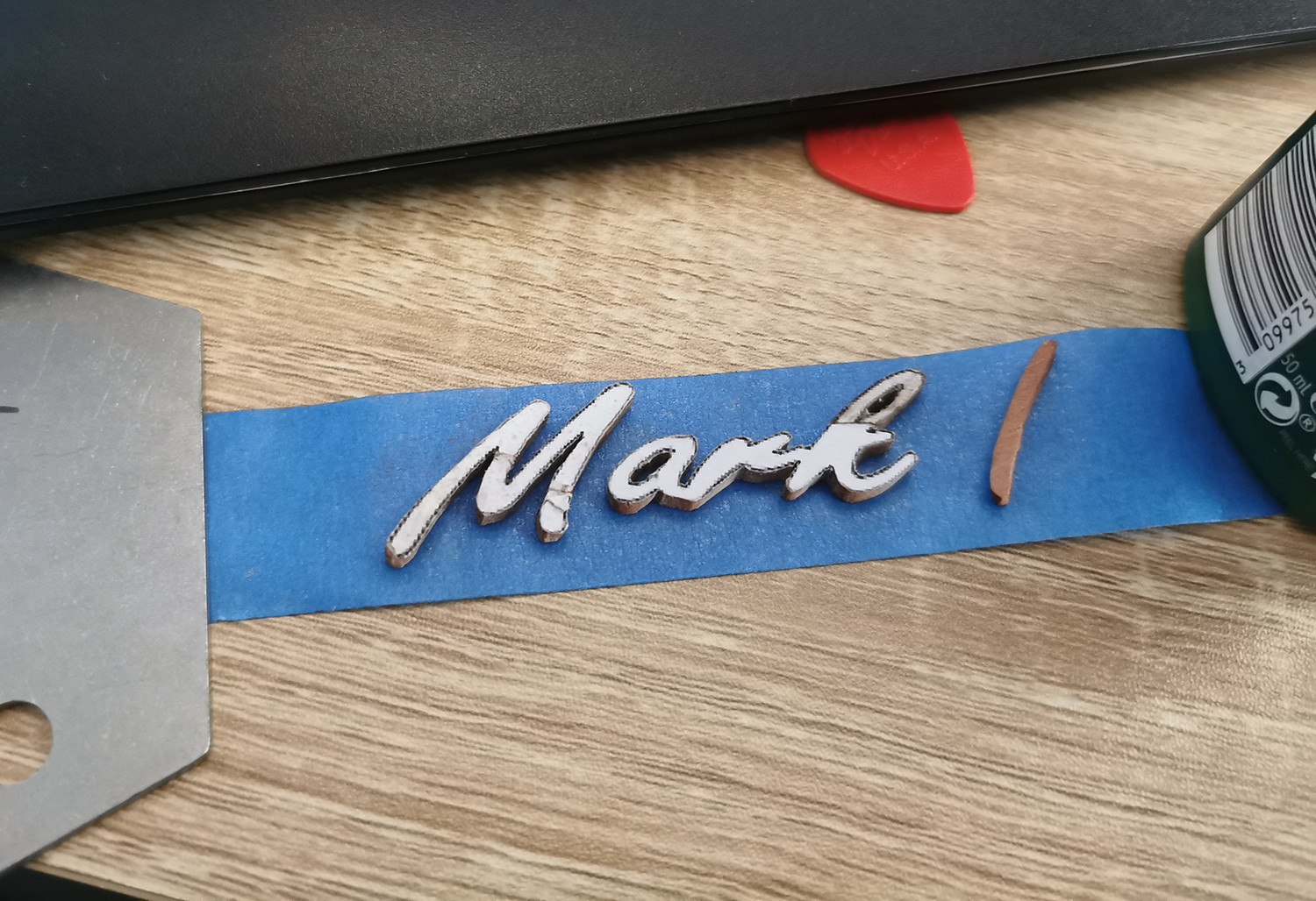

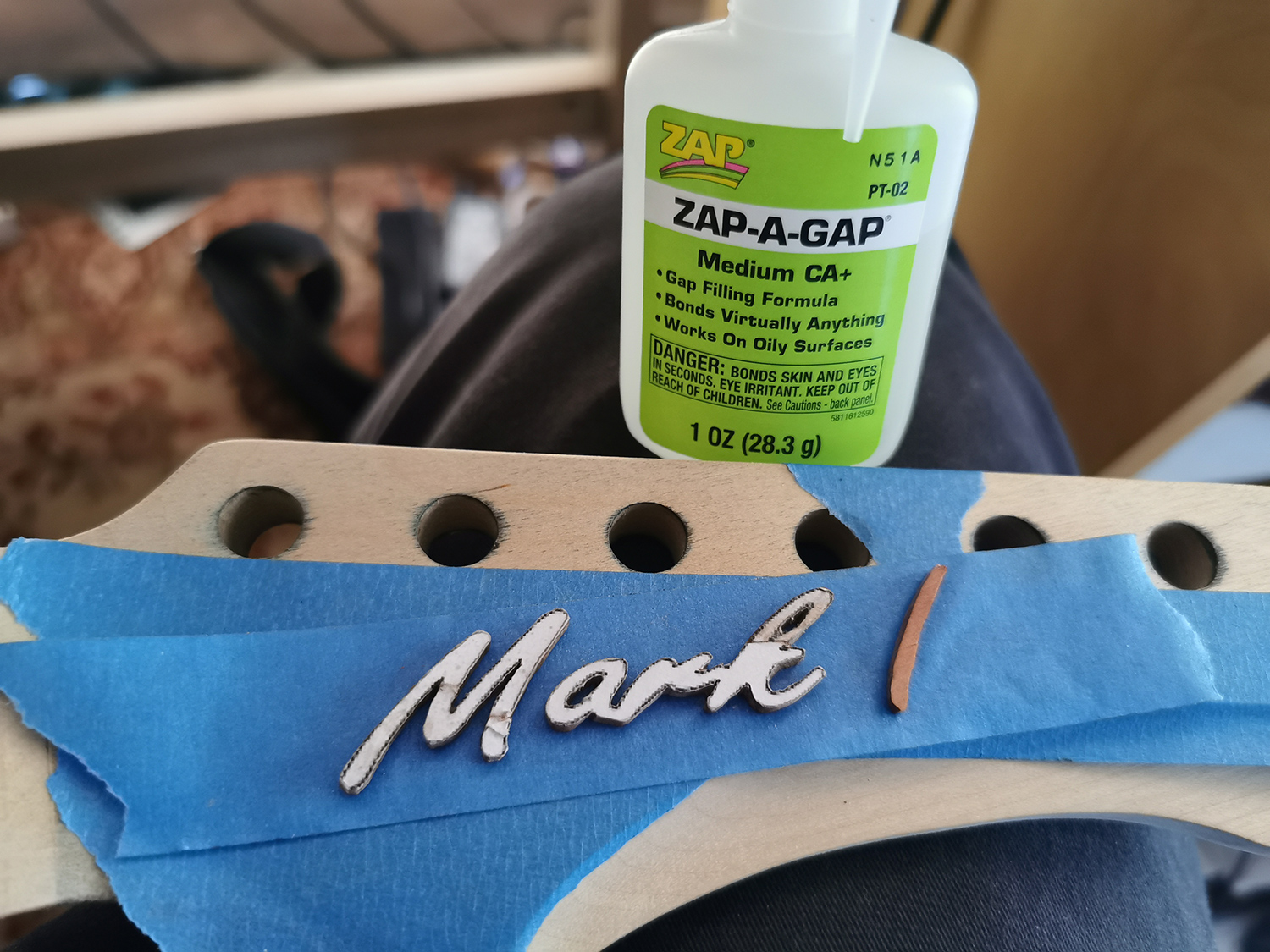

The time has come to embed the inlays. First thing I did was lay everything back out on some painters masking tape.
Attachment 41276
Then I covered the section of headstock I was inlaying with tape, and superglued my layout down to it.
Attachment 41277
From there, simply cut around and remove the sections.
Attachment 41278
I tried to go in deep enough that I could remove the entire setup from the neck and have a good enough "scratched" guide for carving, but it's not super easy to see what's going on to be honest.
I'll upload more images tomorrow. I had a bunch of competing demands today, so wasn't able to get much done on this. I'm up to 13 coats of poly on the body though.

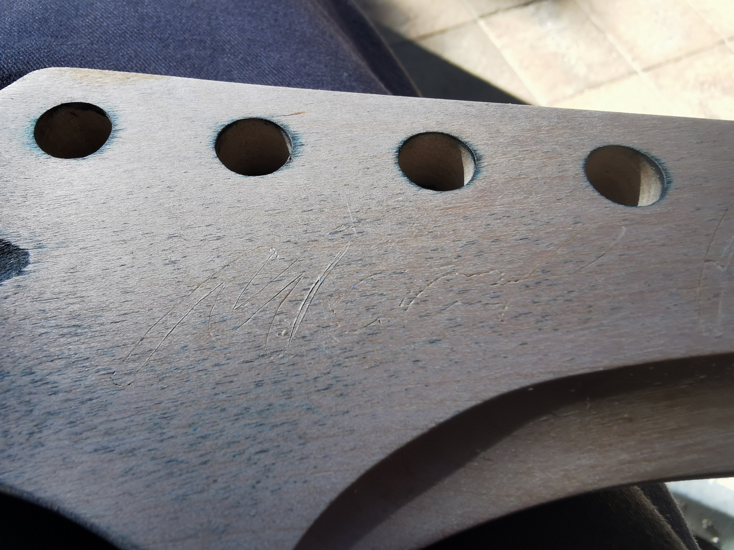

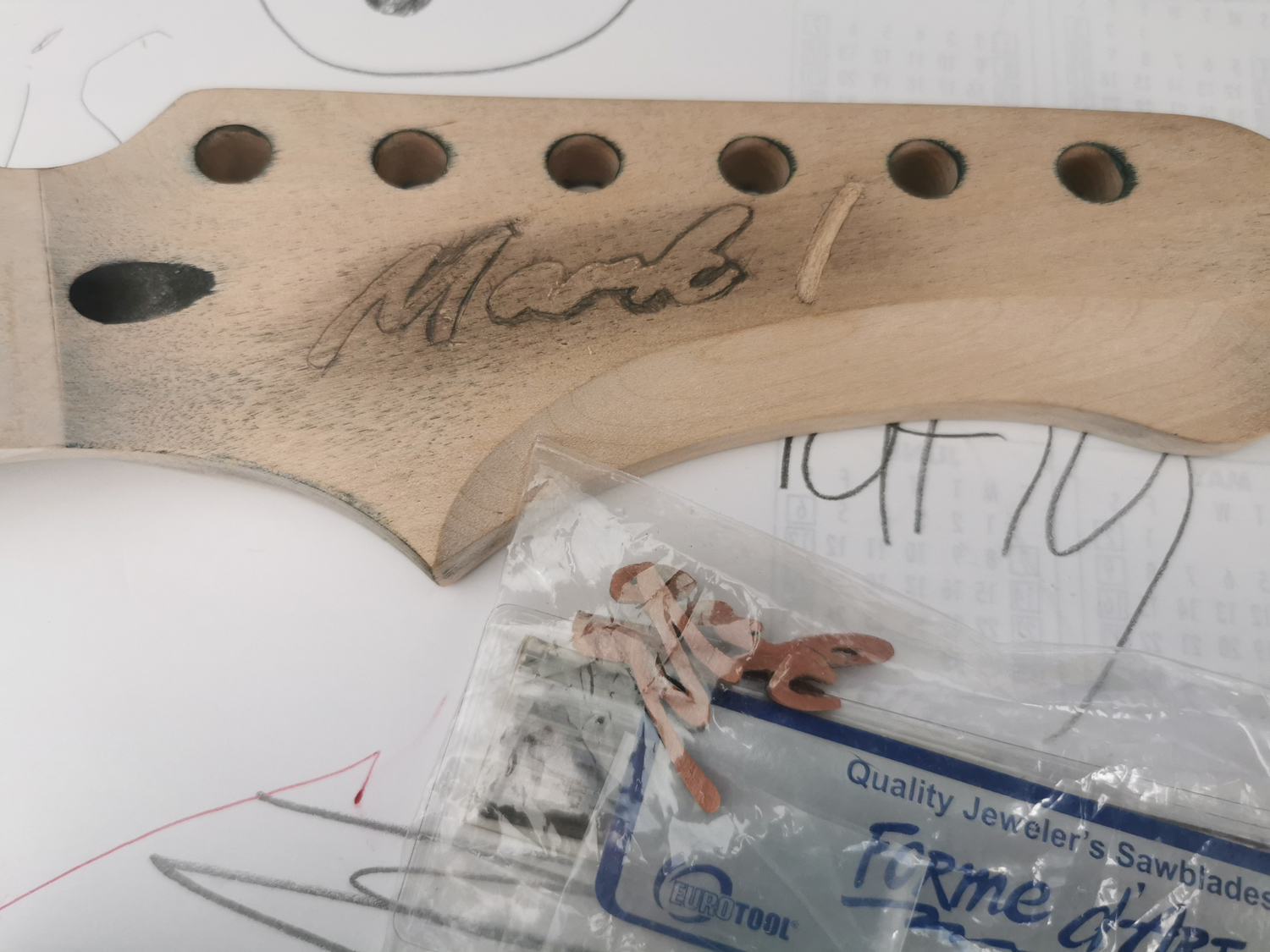

The plan of using the scalpels to transfer layout lines didn't work as well as I'd hoped. You can see them, but it's pretty tough to work with.
Attachment 41289
I ended up using a mechanical pencil to draw in the outlines. I think that's going to give me better results.
Attachment 41290
Working with scalpels isn't too hard, it's definitely more forgiving and less prone to making catastrophic mistakes. It's really slow going though. Just doing the "I" has taken some time and it's still not 100% correct. I've got a couple dremels sitting around, I might test out some engraving bits to see if I can freehand without too much problem. On scrap wood, of course.

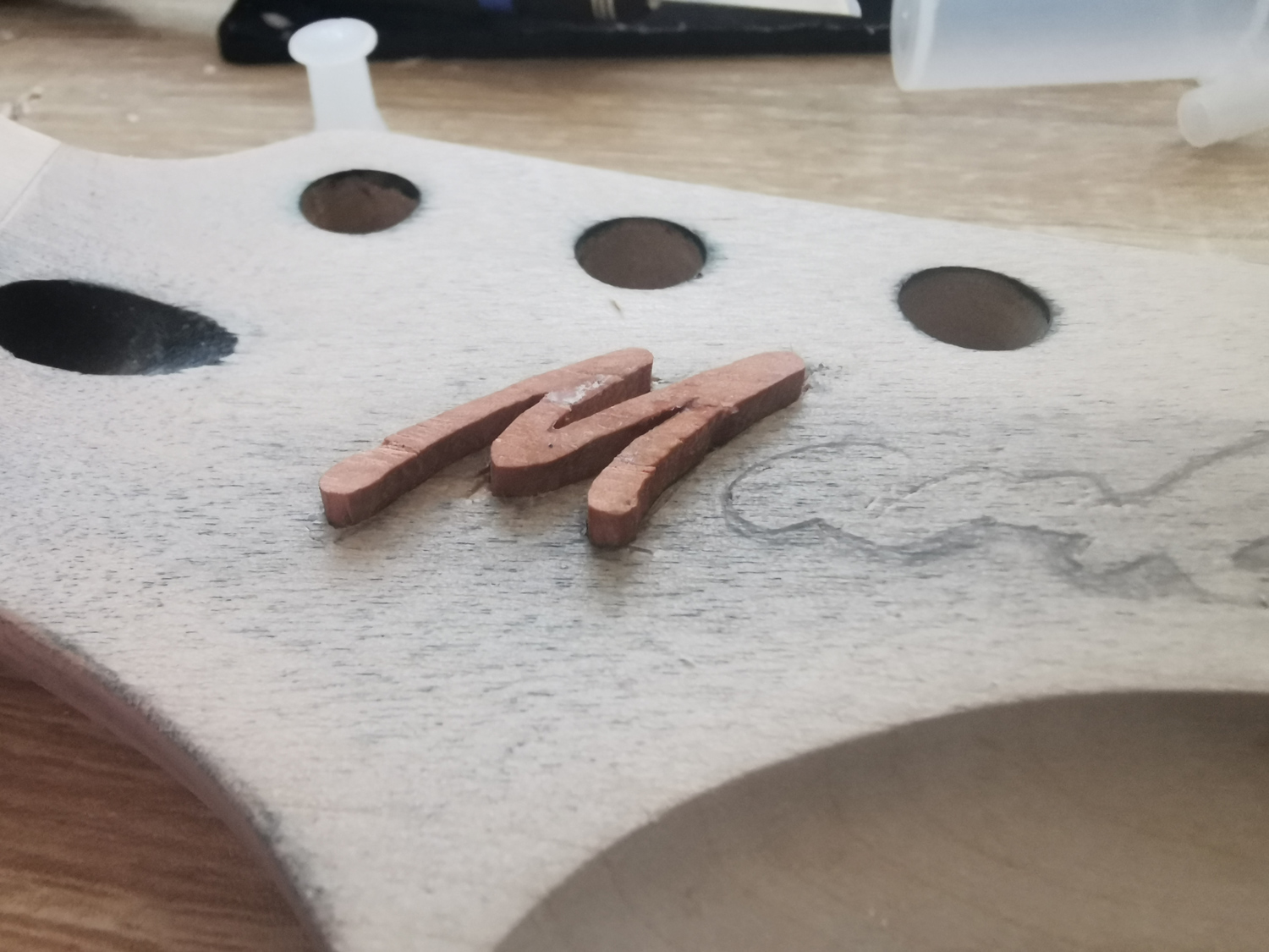

Welp, that seems to work. A bit of a mess up close, but have happily embedded the M. It broke again, of course, but that's okay. So the plan now is to complete the "routing" for the inlays and then CA glue them in. Then I'll pare off the excess and fill all the tiny chipouts and mistakes with maple wood filler.
Attachment 41291
Maybe use a less brittle backing for the abalone, like a sheet of plastic (like model-making polystyrene sheet). You can get it thinner as well, so the inlay cut-out doesn't need to be so deep. The abalone/MOP/whatever you use needs to be reasonable thick, as it's hard to get it level with the surface, so you'll need to sand it down.
I always ended up sanding it too thin in places so I could see the backing, so I gave up and went to decals.
Heyo, that's a fantastic idea, I wish I'd have thought of it! The inlay material I'm using is Jarrah, so if it breaks I can easily glue it back together without it looking too obvious thanks to the breaks occuring across the grain. But yeah, adhering the material to something sturdier would be great.
As I'm hand carving the inlay route it's only pretty shallow anyway. Next time I do this I might use powertools. I played around on some scrap with the dremel and a tiny ball burr, and the results were decent for hogging out, but not so great for finer edges. I also slipped a couple of times and marred the edges. Probably a combination of scalpels and the dremel.
Another option I've been considering is colouring some 5-minute epoxy and filling the inlay if the jarrah doesn't work out. I would have to do a lot of prep work to get cleaner edges first though. But it's an option for next time.

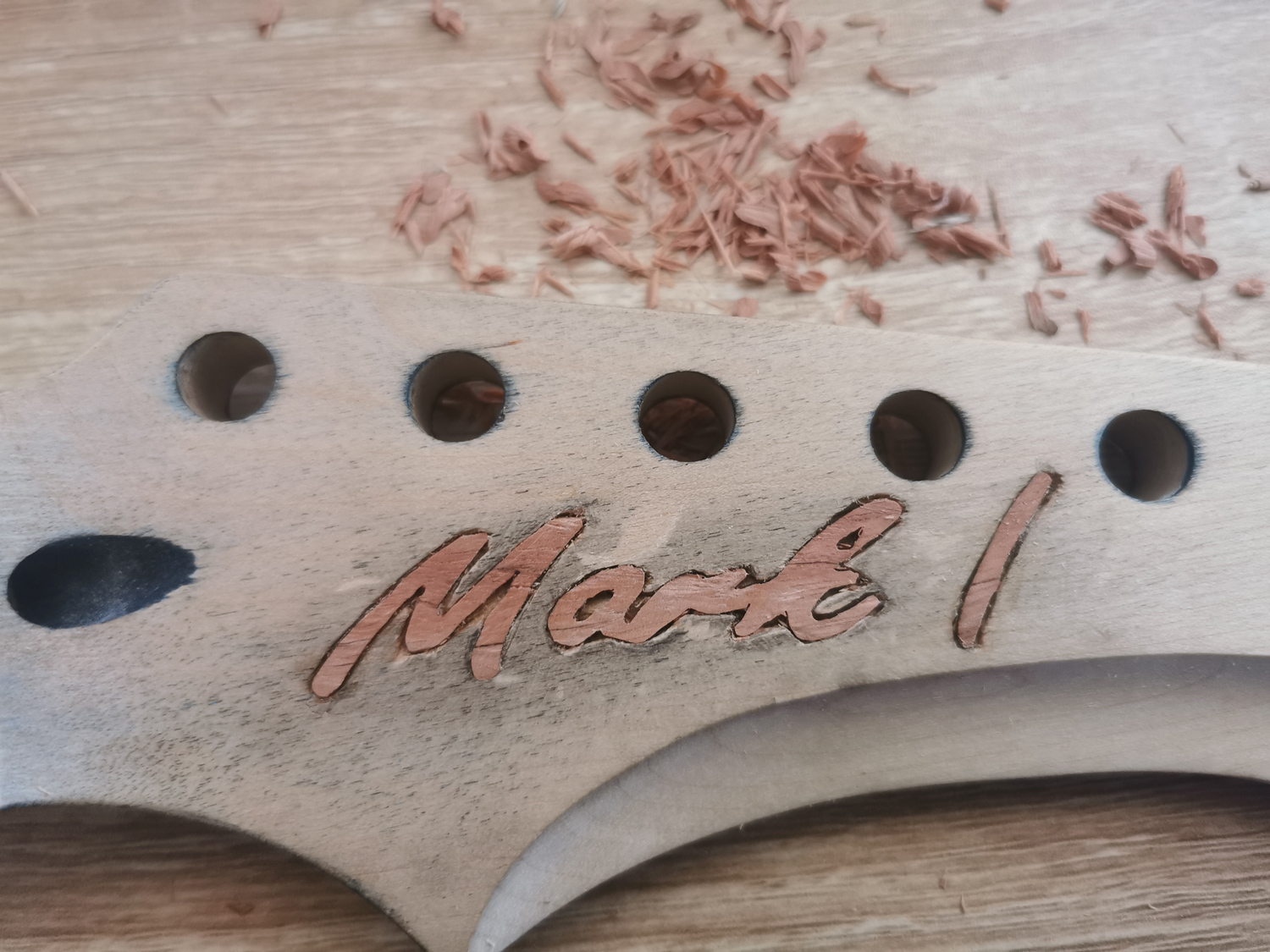

It took a while but I successfully hand routed the cavities with scalpels. Overly successful in fact as you'll see. I glued them down with CA glue and clamped with a cork sanding block under the headstock. The CA didn't take successfully in a bunch of spots, so I had to run more in. I was hoping not to get any CA along the edges so I could fill the gaps properly, so this might mean more work in the future.

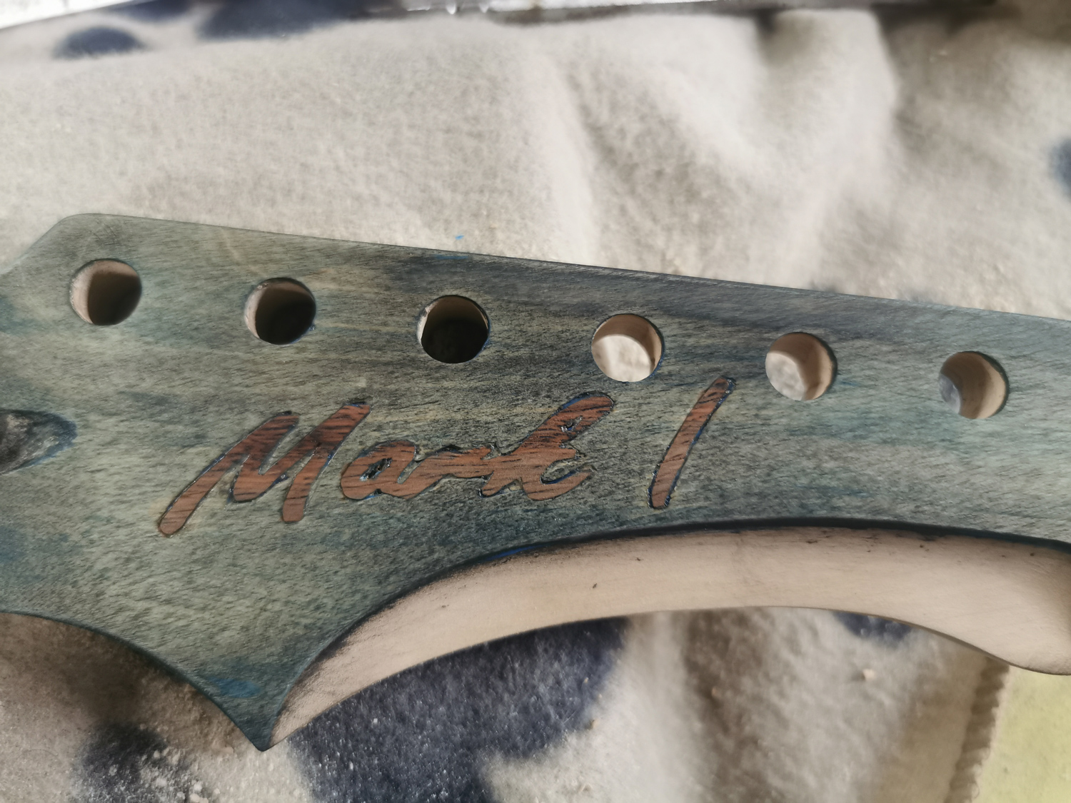

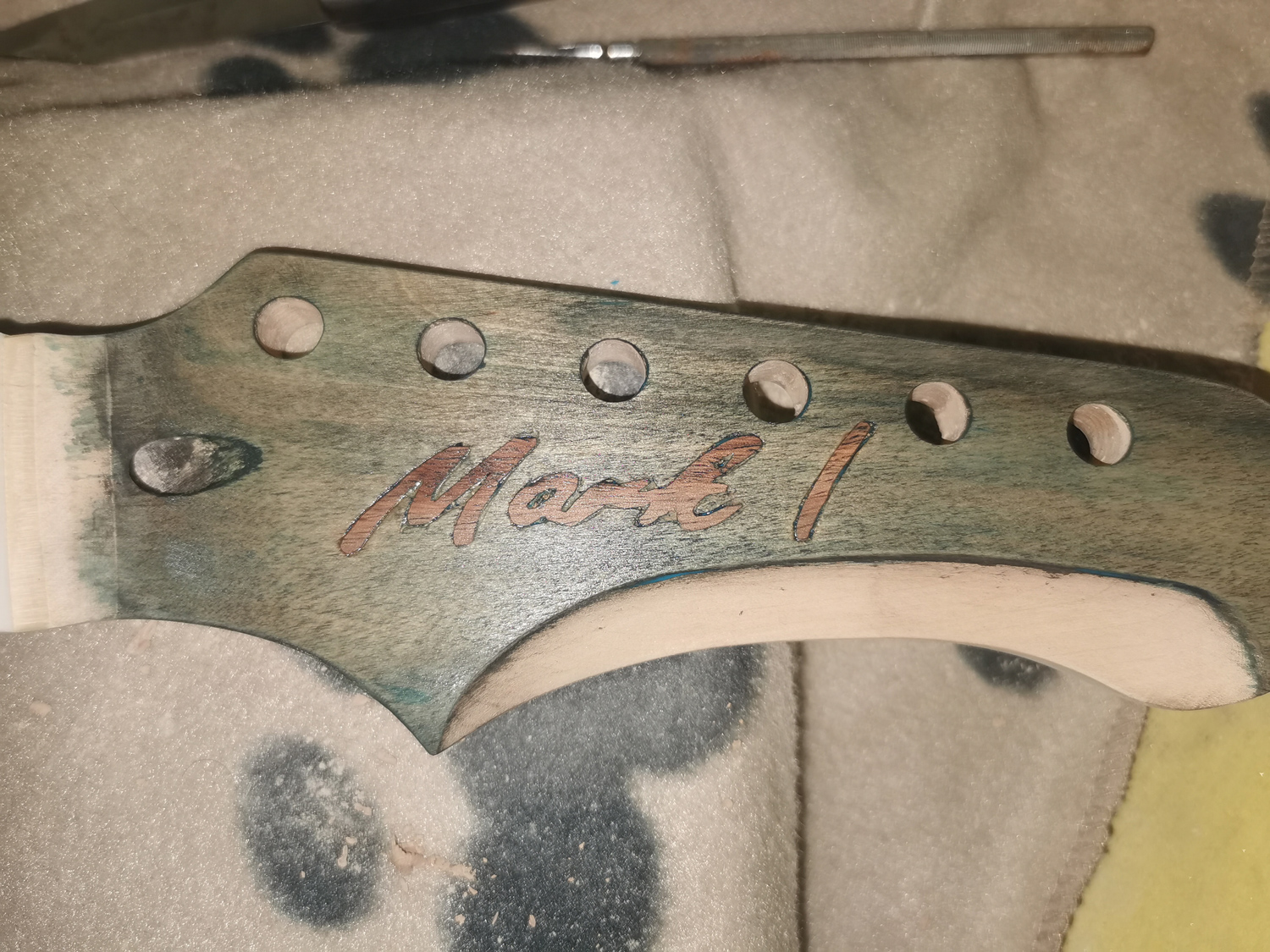

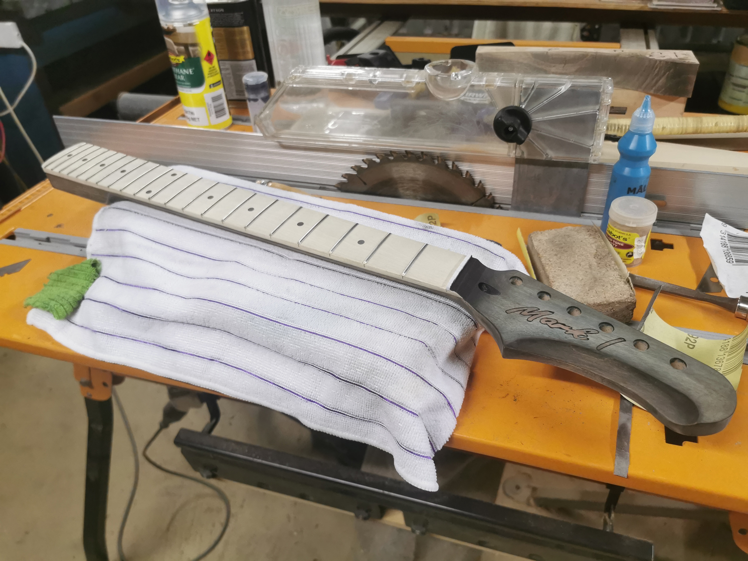

After a significant amount of time spent in the Idiot Lab™ testing a bunch of different materials and methods, I concede defeat on the wire inlay front. The gauge of wire I was looking at for the right looking thickness was around 23 to 26 gauge, around the 0.5mm mark. I tried regular round wire and had some success, but getting it to stay flat was almost impossible.. Flat wire (around 0.6 x 4mm) seemed promising, but I couldn't get anything that was malleable enough to work on the tight corners. Flat silver wire would probably work, but I didn't want to fork out for something that I might not be able to get working.
In the end I decided to carve a small channel around the lettering with scalpels. I found that the round scalpel was the best for this, as you could roll it around corners follow curves easier. It looks awful up close.
Attachment 41340
I bought the cheapest two part clear epoxy at the big green shed, I think it was about $2.50. I mixed it together with a drop of the same black craft paint I used on the body and slathered it on. After a while I pared it away with a super sharp chisel. I was testing on some scrap wood, but decided screw it, there's nothing else I can think to fix this inlay up so I may as well just put it down. Turns out I put wayyy too much paint in the mix. It screwed with the epoxy setting time by a huge amount, so it took a few hours to set off properly.
Attachment 41341
Since the test seemed successful, I painstakingly carved out the rest of the channels and mixed a new batch, this time more epoxy and way less paint. I was worried there wasn't enough paint in there as the mix was still slightly translucent, but I laid it down anyway. I scraped the wet mix with a flat edge, and it came out great.
Attachment 41342
Once it's completely dry I'll probably take to the whole headstock with a razor. I may need to do another epoxy mix as this sunk a bit, I probably should have left the excess on the channels and then sanded back later, but I didn't want it too thick. And it's super easy to do if I need to do it again.
I know it's not perfect, but it really helps the legibility of the logo. I should be able to hard wipe on some black/blue paint to the headstock and keep the legibility of the logo now. So... I think I saved it.

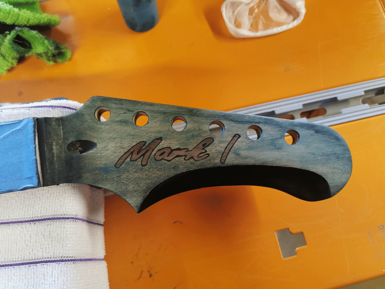

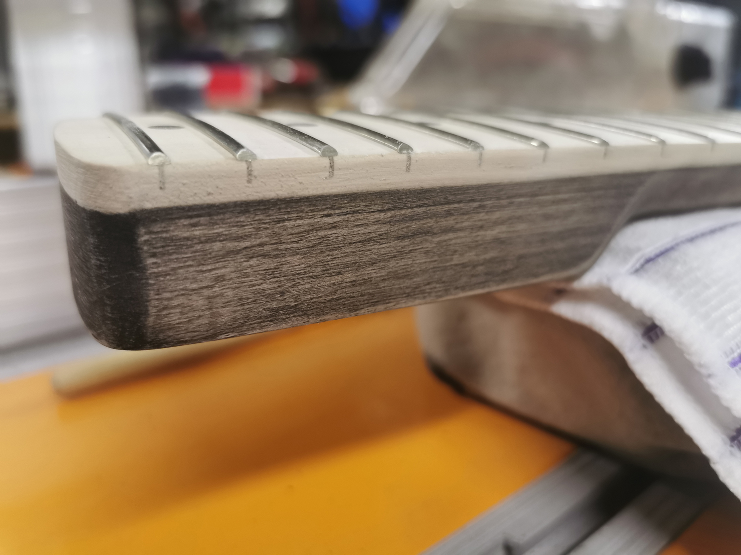

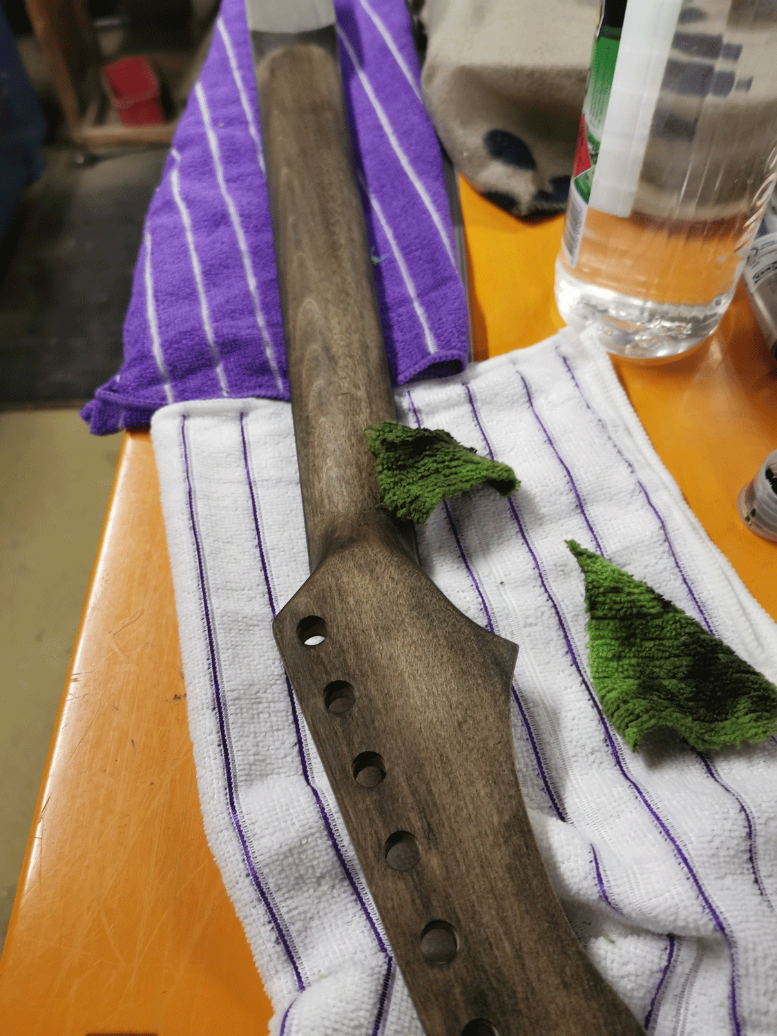

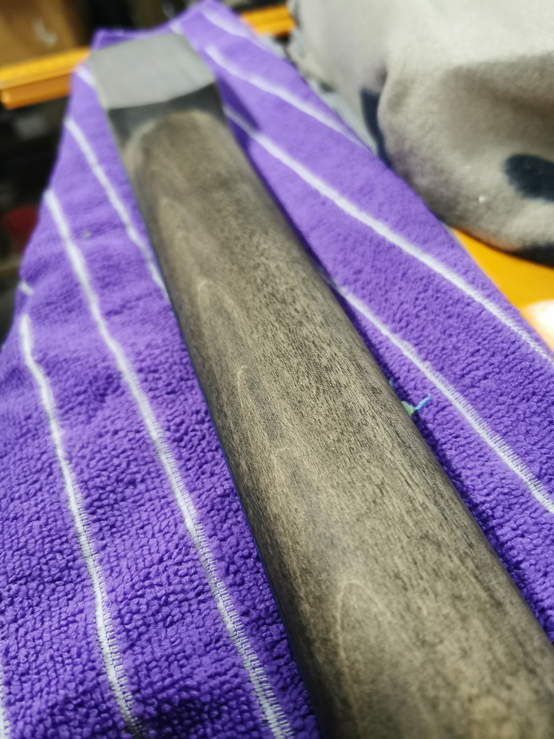

Made some progress on the neck/headstock. Maybe some fiddly work and fine details to complete, but not sure if there's much value to add. In the end it will be what it will be. Headstock is painted up now, I went for a full matte black in the scallop, it should look pretty good with finish on it. I still want to scrape/clean off the inlay to brighten it up a bit.
Attachment 41359
And some different angles of the scallop.
Attachment 41360
Attachment 41361

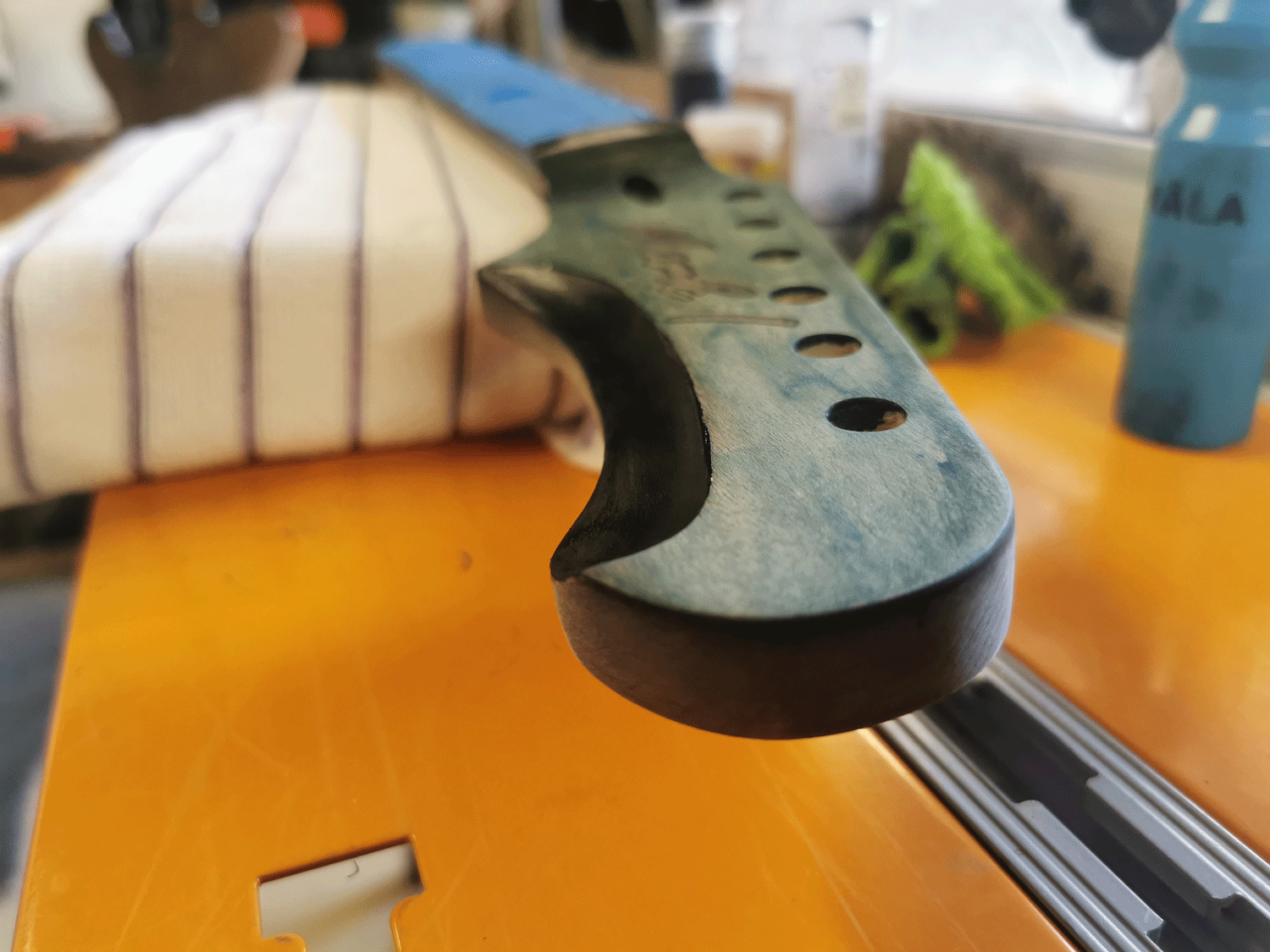

I taped off the fretboard as I'll keep that the original blonde maple colour. I'm planning a spray can oil poly finish, that may add a slight tint but most likely not a lot. I gave the neck the same "rubbed back" black treatment as I did with the body. I want to tie things together and I think a fully blonde maple neck on the body would seem a bit jarring.
I realise some of you are screaming right now.
Attachment 41362
Attachment 41363
Off to buy an IKEA portable wardrobe tent on the drive home tonight, so I can set it up as a "spray booth" for the neck finish.
Cabothane... how many coats for a neck?
Neck colour looks fine to me. Not even a slight wince here.
The maple is smoother and less absorbent than the body wood, so less sanding is required to get it flat, but I’d still put 4-6 coats on depending on the coat thickness, probably 6, especially as the neck has been stained. Any sand-through will leave a lighter patch which will be hard to fix in isolation, so it’s either sanding the whole neck down (I did that twice on the Hexacaster) and starting again, or touching up the clear coat and leaving the lighter patch.
With the Cabot's, I'd do 3 coats 10mins apart. Leave it a few days, very light sand then another 3 coats 10 mins apart. Then leave as long as you can before evaluating next move.
Thanks for not wincing! You'd make an excellent poker player.
I actually found this paint practically slid off the Tasmanian Oak body, to the point I had difficulty with consistent coverage because any additional paint would lubricate and reveal bare wood that refused to take paint again. With the maple I had to get aggressive with methylated spirits to rub the paint back after a few seconds of air drying.
I was thinking 6 coats minimum, but after all the work layering poly on the body it seems insane that only 6 coats of anything will work well. I guess that's the deal with spraying instead of wiping. I think I'll be happier to do more work on wet sanding a clear if it saves me weeks of hand application.
Back of the can says 6 hours between coats, but I'm gonna assume you've got a load of experience here and know what you're doing. I certainly like the idea of completing the application in two short sessions rather than dragging it out.
Sorry Ross, the old instructions used to be do one coat, leave 10 mins and then repeat twice. So it's a total of 3 coats in half an hour. Then leave for a few days. So I like to think of it as a session = 3 coats over 30 mins. Don't go too thick in each coat to avoid runs. You'll get the hang of it. There are a few in depth posts about the Cabot's schedule if you have a search around here.

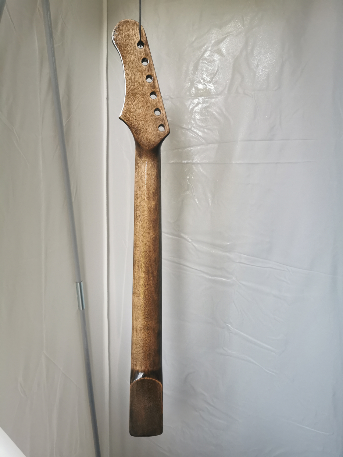

Blue tape off and a quick touchup and cleanup, small amount of sanding. I think I like the contrast?
Attachment 41417
Attachment 41418

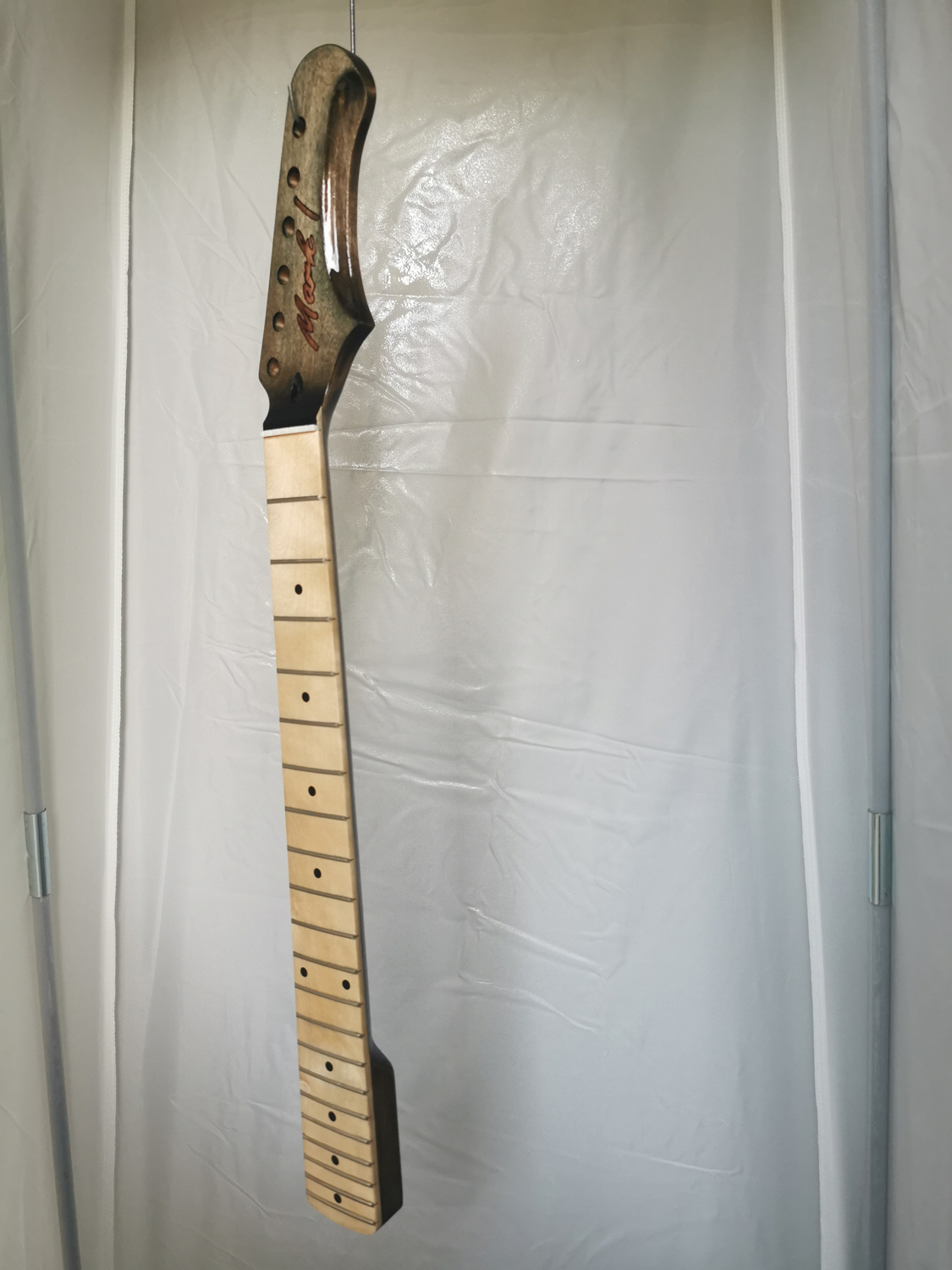

I made a quick spinning hook setup from a broken satchel strap hook and some fence wire. The wire is bent in such a way that it "snaps" over the rail in the IKEA "booth". The strap hook swivels, allowing the piece to be easily spun around.
Attachment 41419
I set up the IKEA spray booth, dog for scale.
Attachment 41420
Annoyingly, my spray can of cabothane might have been dodgy. I've never used it before so I don't know. There was a red... mister? ...supressor? on the nozzle. I got exactly one nice light spray out of it before it absolutely refused to work again. It's a 1.5 hour round trip to the closest big green shed, so I wanted to make this work. I tried adjusting the little red guy to see if it was acting as some kind of switch, and of course it shot off the nozzle and out into the yard, never to be seen again.
Good news, the spray works. Bad news, it WORKS. I'm worried it's gone down way too thick. There's nothing that can't be fixed, but I'm starting to run out of time for this project.
Attachment 41422
Attachment 41423
Attachment 41424
Was it a rectangular shape? If so it was probably a rotating nozzle, designed to give a fan-pattern rather then a circular cone pattern from a standard can. It rotates (I use pliers) to give a horizontal or vertical fan spray. Fan direction is at 90° to the main axis of the rectangle. So horizontal rectangle = vertical fan spray.
It probably just needed a pin to unclog the nozzle. (This is why they say to turn it upside down after use and press to use the propellant to blow any residue from the nozzle).
If you think there's too much on, then wait a day before spraying some more to give it extra time to dry.
You can always try using a nozzle from another spray can (use on cardboard first to avoid any old paint being transferred to the neck).
