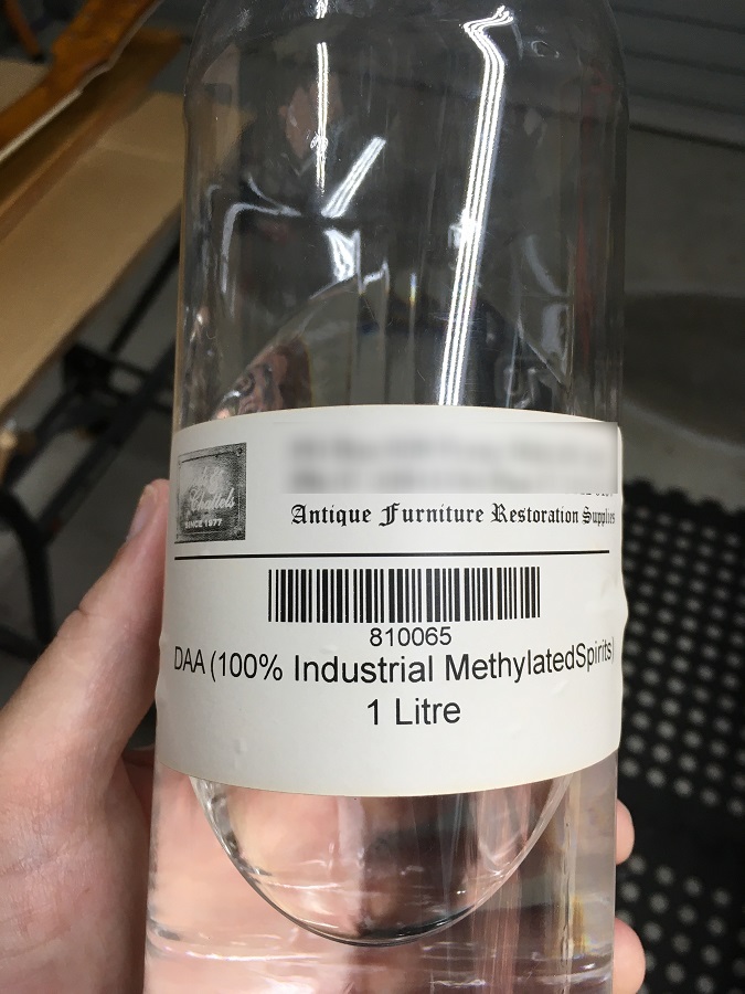

I'm surprised the Australian Government doesn't see the opportunity there!
This is the stuff I get from an antique furniture restoration supply business. It is labelled as "industrial", don't know if that makes any difference in its taxability. I pay $10/L for this stuff vs $4 from the BGS or grocery store.
Attachment 41443
I use plenty of the cheap stuff for general purpose uses and with dyes, but the pure stuff is reserved just for making shellac.

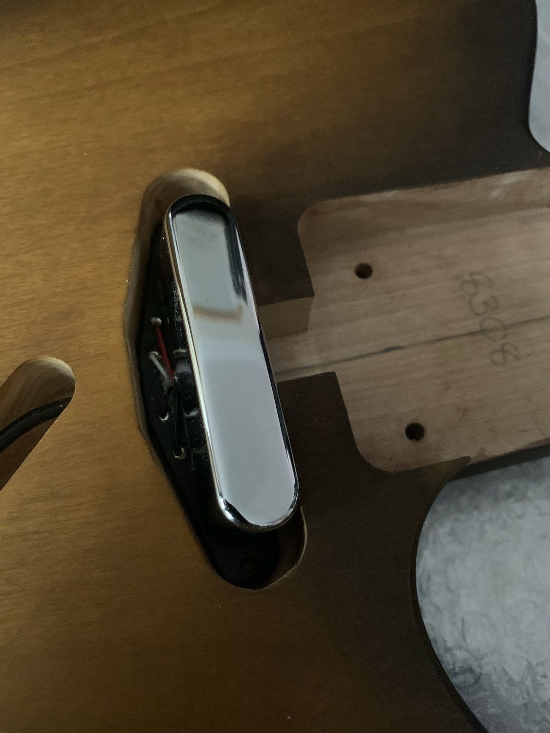

My goal for yesterday was to get the neck on so I fitted the bridge and tuners. I then clamped on the neck and ran the Es to check how the strings were running down the fretboard. It all looked good so I put the clamped neck/body on a stand and went off for dinner.
Then life got in the way and it got too late and I was too tired to safely do any more on it. So rather than leaving it in it's clamped state I took the strings off and released the clamp... still on the stand... the neck falls in slow motion and crashes into the body - but I can't save it. And so this:
Attachment 41502
There's another mark in the top but it's under the pick guard - but the pictured damage is just under where your forearm goes.
So I'm not sure what to do. I'm not sure it's fixable - at least with my current skill level. I could try to fill the dents with more RCP but all my attempts of fixing burn throughs in past have just caused more damage when I try to rub it back. As this is on the edge I expect that I will more than likely damage the areas around the fills.
So it seems I have to start again - for a third time - or just live it <sigh/>.
All advice (and sympathy) welcome.

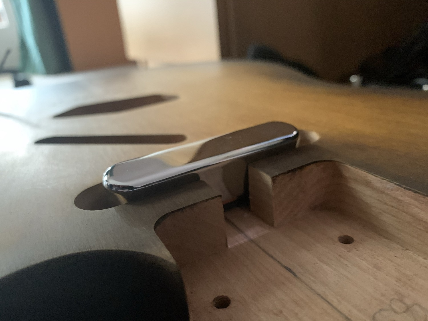

That is a real shame.
Attachment 41503
The impact has delaminated the RPC, so you'd have to sand through the layers until you got back to the first attached layer, and that may be the wood.
I'd give sanding back a go, as you've got nothing to loose. If you hit the wood and start taking off the stain, then it's still not the end of the world as it is solid black and not a fade transition area, so it should re-stain OK. If it doesn't look right, then you can still do the full strip back.

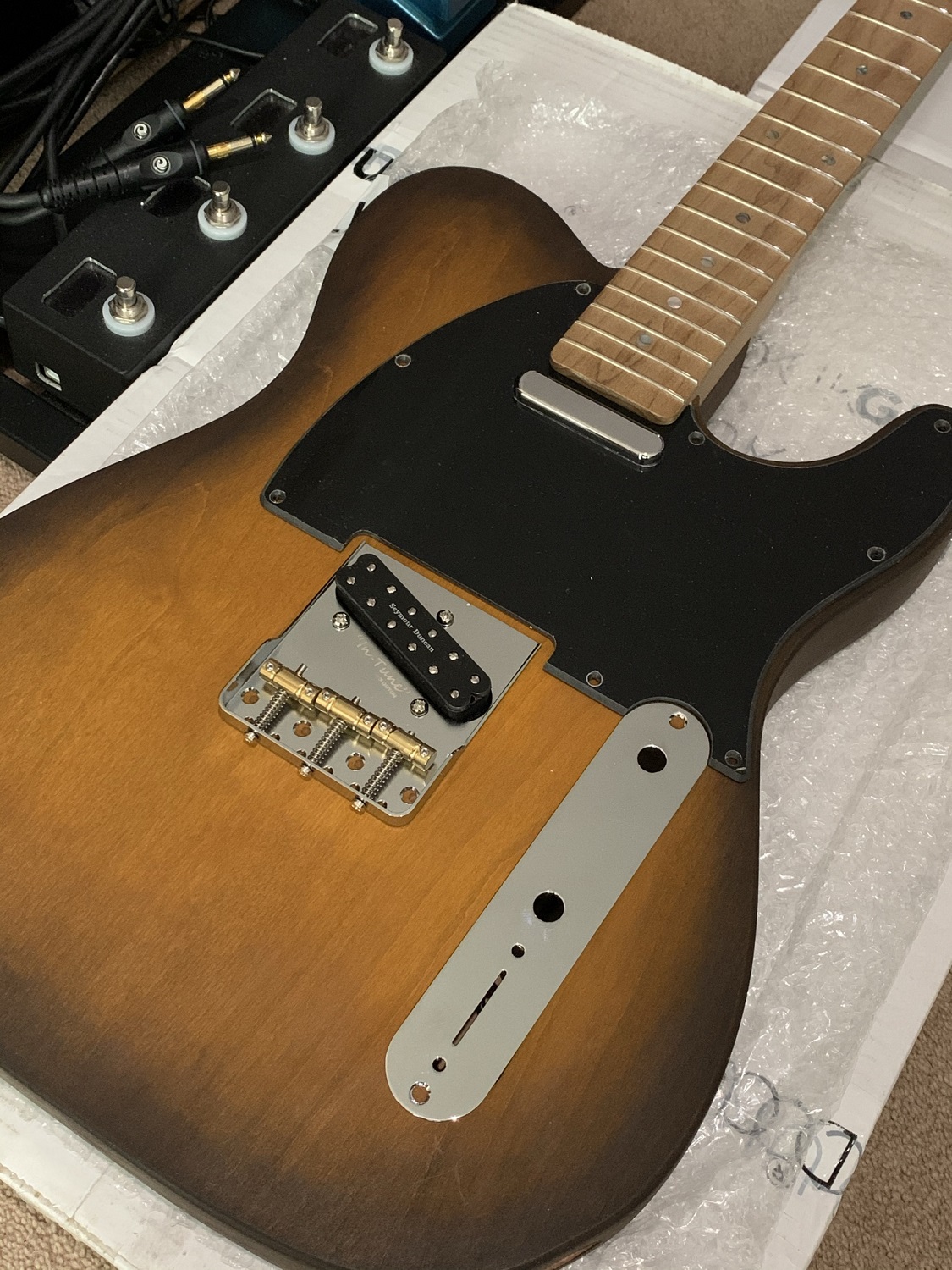

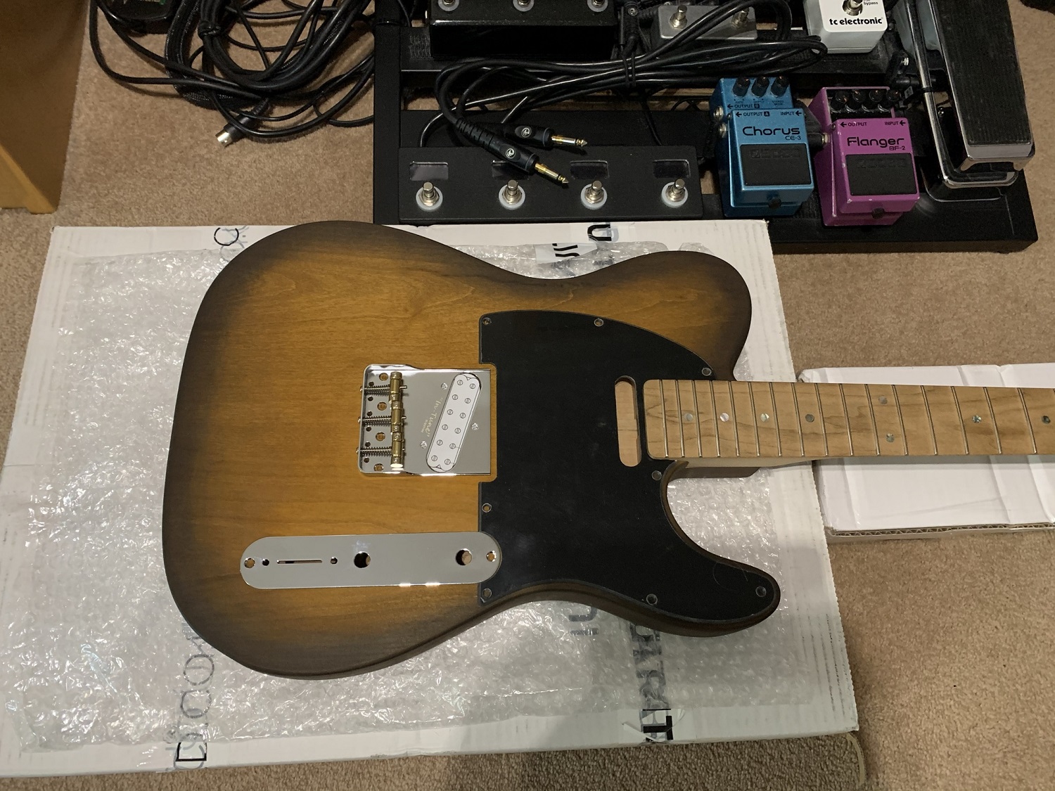

I’ve finally got around to putting this together:
https://uploads.tapatalk-cdn.com/202...b8e90e95bc.jpg
The wiring was fiddly as both pots are push pull to split the pickups. The neck is a vintage stack and the bridge is a little ‘59. But the wires are tiny!
I’m pleased with the sound - I’ve still got to finesse the nut and do the setup. On the home straight now!
