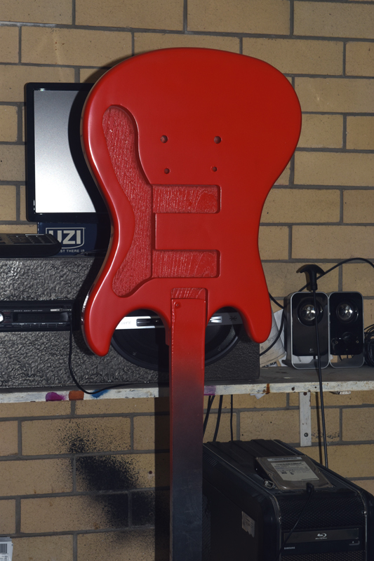

first colour coats on :D
Attachment 20261
And finally the suspense is over... nice color Dedman.. and as usual already a very smooth beautiful finish underway... you make it look so easy..
Indeed a nice color. Reminds of an old Hofner guitar I had some years ago.
thanks mate, I just use a small suction feed spray gun and auto acrylic. The primer fills really well. This has 6 coats of primer (sanding after every 2), that's 4 coats of red. Sanded a lot of the first coat off getting it dead flat, sanded again after the second (600 grit now was on 400 before) this will get wet sanded with 600, 2 more coats of red, sanded with 800, then a coat or 2 of a mix of clear and red, sanded again, then 2 more of plain clear , sanded to 2000, then cut and polish. It will take a couple of weeks because of other commitments, plus it allows for the paint to really dry out.
